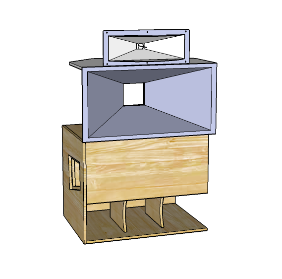

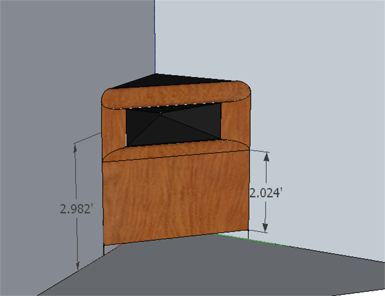

I've taken a moment to draw out what the Synergy horns would look like placed on top of the Sub in the corner of a room. Looking at those numbers on a straight edge can make the dimensions feel large, so I wanted to apply them 'in context':
Even though above 30" isn't going to make much of a difference, it seems like the 37" horn would fit better in this situation. With it being slightly further from the wall, more space for the actual rear of the enclosure is available.
Also, the T18 sub is meant to be placed 12" from a corner (firing back into that corner), so any reduction in interference from a speaker stacked on top of it will allow it to corner-load as well as it can.
I was quite surprised by how 'small' the larger Synergy horn appears in context!

Back on the horn design, I was just thinking...if I could make the walls part of the horn (say, the final stage, S2-S3), could I make the first stage (S1-S2) 'connect' to it?
I know it's possible, but what angle of dispersion would I have to consider? Given that the speaker will be placed at 45 degrees from the right-angle (or however close the house is!) of the corner, do I need to make it 135 degrees, so that the final stage of the horn ends up at its 90 degree dispersion? I suppose the ending shape of the horn would be that of a parabolic one.
That's only horizontal dispersion, so I suppose there would have to be some consideration make to the vertical dimension.
Obviously it's just an idea, so I'm prepared to still work on the 37" Synergy 🙂

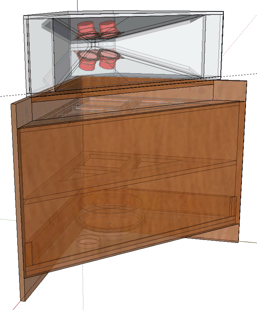

It seems like you ended up where I've been for a little while. Here are some sketchup pictures that show what I've been thinking of. The first is a 90x40 conical synergy on top of a basebin that is designed as an offset horn covering up to 200 hz. Its 150L and takes an AE TD12X tuned to 25 hz. The 4 FE25 mids in the synergy are ported to cover down to 100 hz. The overlap is to deal with ceiling bounce. The roundovers are based on 4" diameter half and quarter rounds that can be found on the web. The second shows how I plan to blend the horn into the corner. The roundovers are based on 4" diameter half and quarter rounds that can be found on the web and likely will be attached as trim pieces after installation. The first picture - a screenshot from my sketchup design is a work in progress and doesn't have those details yet. No saying when I will get to build this but I'm running out of excuses not to start.

View attachment 398569It seems like you ended up where I've been for a little while. Here are some sketchup pictures that show what I've been thinking of. The first is a 90x40 conical synergy on top of a basebin that is designed as an offset horn covering up to 200 hz. Its 150L and takes an AE TD12X tuned to 25 hz. The 4 FE25 mids in the synergy are ported to cover down to 100 hz. The overlap is to deal with ceiling bounce. The roundovers are based on 4" diameter half and quarter rounds that can be found on the web. The second shows how I plan to blend the horn into the corner. The roundovers are based on 4" diameter half and quarter rounds that can be found on the web and likely will be attached as trim pieces after installation. The first picture - a screenshot from my sketchup design is a work in progress and doesn't have those details yet. No saying when I will get to build this but I'm running out of excuses not to start.
Thanks for that nc535, your design pretty much looks like what I'd like to do in my head...although, the drivers I have wouldn't be a 'drop-in' replacement. Still, it's food for thought, and I did start wondering about seeing if there was a 'triangular' design for the T18 while I was on the way to a gig tonight...heh 🙂

This is a good thread. Along the same lines I was thinking just this week -- I have the T18 plans and the mid horn plans from Wayne. Then top it off with the Pyle PH714 horn for that "vintage look" and wa-la!
The alpha 8s are about 1.25" deeper than my mids. You can accommodate them by spacing up the top and bottom of the conical horn cabinet or perhaps using a larger vertical dispersion angle.
The long throw mids if put on the sides will no doubt force the horn sidewalls further away from the walls. That is one of the reasons I kept the woofers out of the synergy horn. Chances are I will do a center channel version with them in it on the sides...
The Pyle CD has a shorter internal acoustic path than my BMS4550s so your mid holes will end up in a different place than mine.

Here is a mashup with a "double wide" T18.
It sounds like there are just enough differences where it might be easier for me to use a different design, rather than trying to 'patch' something that works with different hardware 🙂 Thanks for the inspiration! I wasn't intending on using the 55-2421s within the horn; more just using them in a separate sub cabinet like you have underneath the Synergy horns.
