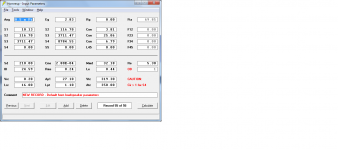

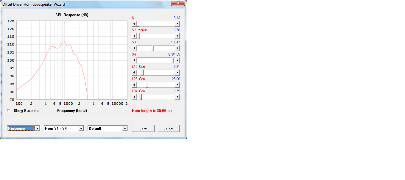

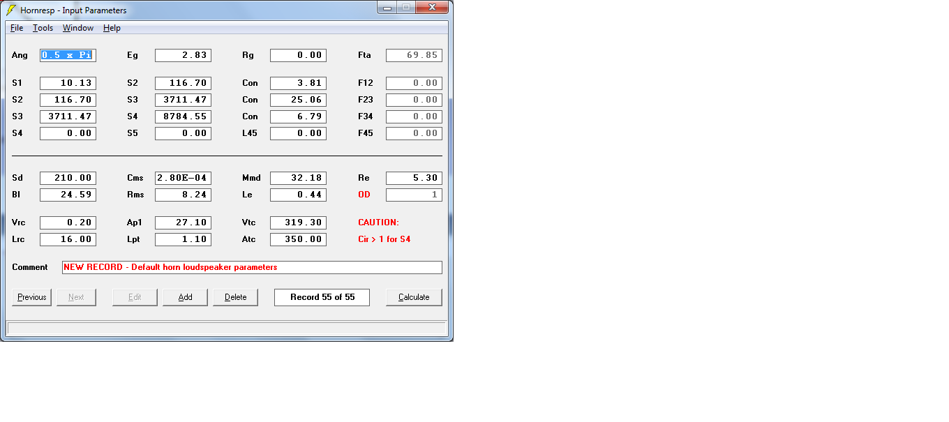

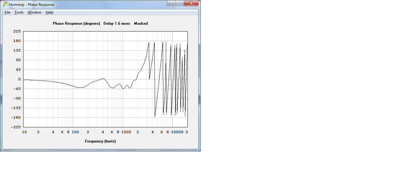

unahm, Im not sure where you are up to with modeling the ports but just a few thoughts.
L12 in your model is only 2.5cm from the throat. There is no way to physically fit any sort of port that close to the throat.
From what I am gathering you plan to mount the driver directly behind the compression driver and use multiple ports on each side of the throat, similar to what Danley does with his coaxial synergies.
In this case I would model something like this.
I've no idea why I'd not thought of that (actually I do, lots of sleep deprivation at the moment!), but it seems like a more simple solution, and mitigates the problems we can see with offset drivers!
I'm not sure about the S1-S2 bit, as Bill's spreadsheet doesn't seem to show that 'section'...maybe it's put in there to compensate with something in HornResp. Either that, or it's the flare for the tweeter..?
