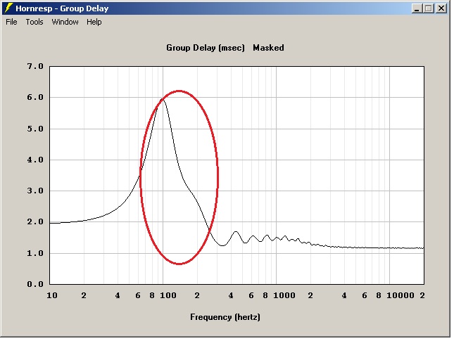

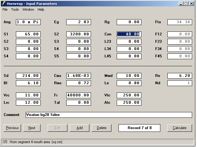

Hello,
I will post here, same subject, different driver.
Currently i have OpenBaffle 3Way active. Bass- H frame 15" per side, Visaton BG20 8" mids and Philips tweeters.
I want a mid horn, first horn for me to build, and i want to use the existing Visaton BG20. Crossed at 150 and 1.2k. From there up, i have 2 drivers to play but that is a different topic. I know Visaton is crap compared to other speakers but for first time horn to experiment with i think it is OK. Or am i wasting time??
I made some simulations with Hornresp.

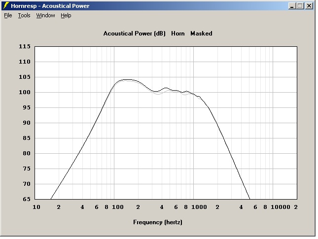

Please take a look and see if you can see any problem. The speaker input parameters are taken from Visaton site, Vtc and Atc is not exactly calculated yet, i entered some roughly values. I intend to build it conical, 4 sides. KISS.
Q: In group delay sim, if i will cross at 150 HP LR4, that spike in group delay will be a problem?

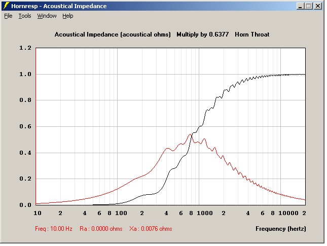

Q2: In acoustical impedance sim, does things look ok? What should i be after?

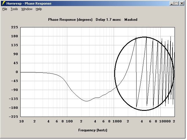

Q3: Phase response sim, should i be worried about that circled spikes? They are outside my intended usage.
Any other tips are appreciated,
Thank you!🙂

I see i didn't enter Ap1 and Lpt values.
Also do you think i should choose 4xPi in first cell? The horns will sit on top of H frame woofers at 1m from the wall.
I am no expert at hornresp, but to me it does not look like a great horn. The acoustic power graph should be more flat. Have a look at this horn: 135 hz Mid Bass Horn - The Paper Horn by Inlow Sound
The Eminence Alpha has a rather low sensitivity of 94 dB, but it could work. Fs is around 70-80Hz and xmax is only 3mm, which is good. Hope you have a bass driver that can be driven up to 150-200Hz with clean midbass. I found that the Eminence LAB12 cannot. JBL 15" PA bass drivers were better.
