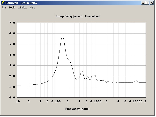

After some simulations, i have a few questions:
1) should i simulate to have a high efficiency power conversion in detriment of acoustical power? I mean, some simulations look good but efficiency is below 10%. Other sims, with +-4dB peaks and valleys have a 20-40% efficiency.
2)The impulse response is better to have the negative after-shot as long as possible or as short as possible? Or more important is that the impulse response is as short as possible in time axis, and after the negative shot, there are no more traces of impulse visible?
3) group delay between 100 and 200hz is always 4 to 10ms. Should i be worried about this?

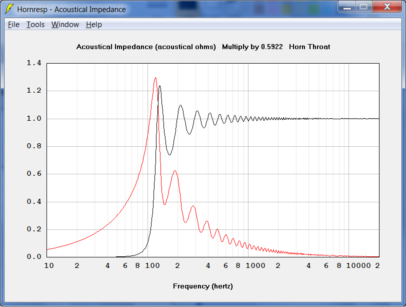

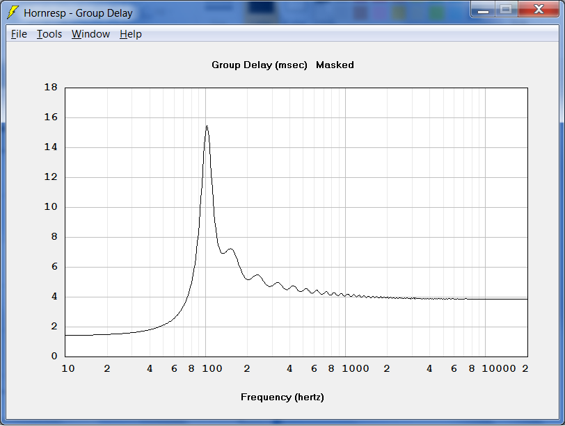

Since no replies I'll take a guess for you. The horn is better loaded before the black line meets the red, and hangs on a bit lower, say until it gets to around 0.2. When choosing the low point you should look at group delay. Driver electrical impedance also gives a clue.
Thanks Allen!
In all simulations usually there is a spike in group delay until it settles at 300Hz. So better to cross high pass at 300Hz i guess.
This is only a test horn, will be my first horn, but i want to get the most out of it without sacrificing the sound.
Some would say you should begin crossing when the group delay begins to deviate. This would be around 1kHz here but if you ignore the wiggles and focus on the main peak, I'd want to cross an octave higher, maybe 500Hz.

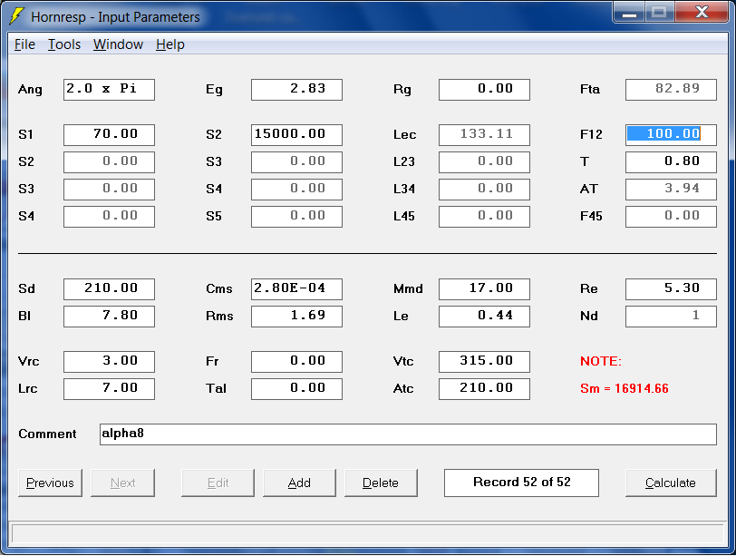

I don't think this would be a good horn in practice. Can you post your input page, maybe there is something better that we could come up with.

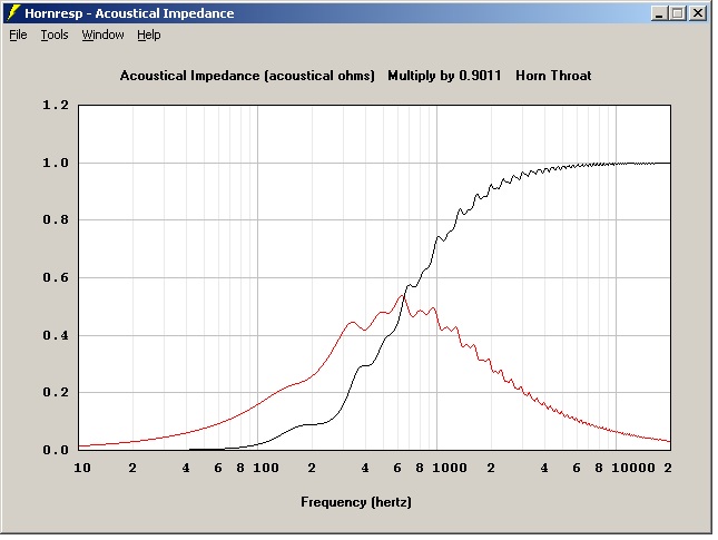

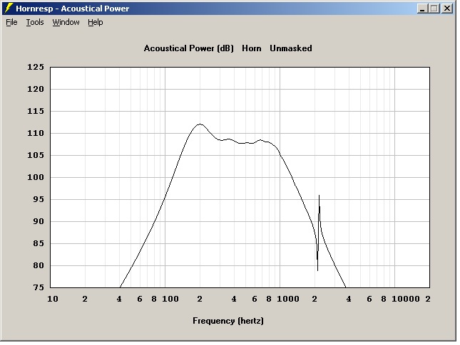

Ok. Don't know how you want to use this one. A conical horn doesn't load well below 1000Hz. If you use it into bass it can still waveguide but will be huge and hardly worth it. I used a LeCleach (0.8) profile, which is a hyperbolic exponential variant, just because it's something I use in this band.
As you say this is probably not the first choice of driver for a horn, but no problem. As you optimise you'll probably find the size limits you and you'll have to put up with some response compromises.

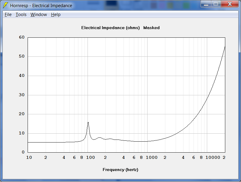

I just tossed out this example centred around 100Hz. With a LeCleach horn this usually means crossing at 200Hz, but you might push that down a little as we're a bit less sensitive at lower frequencies.

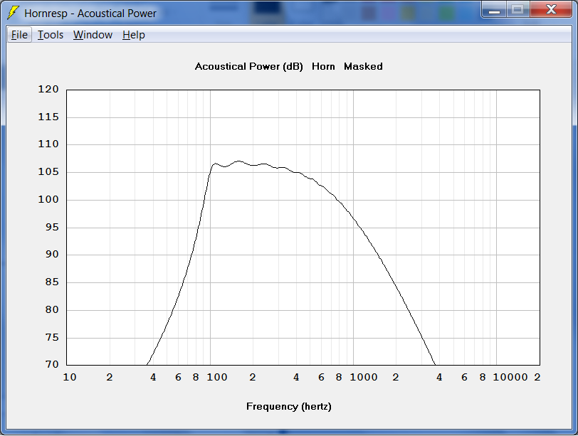

Notice I've adjusted the rear volume to take the resonance shown in the electrical impedance to 100Hz. Also the acoustical impedance shows good driver loading in the passband. The group delay is more smooth in the passband, and the efficiency screen can confirm the region where the horn is effective.

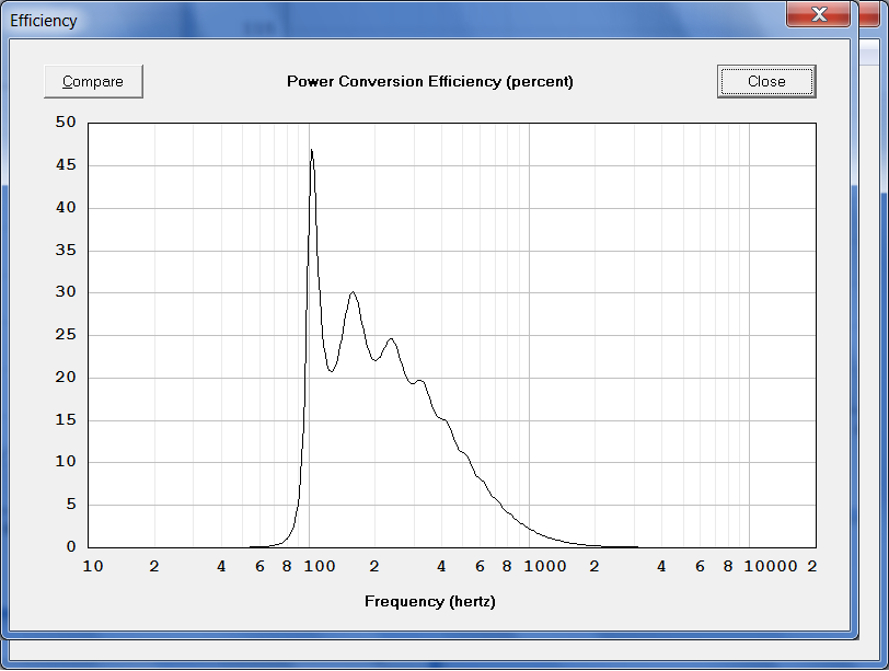

I was hoping to use it in ~200 - ~1k Hz region. And i choose conical because of simplicity of building. I simulated a 3-part conical horn but efficiency was in 5-20% region. Mouth size is a factor, would like to keep in the 2000cm2 region.
In my simulations group delay is lower, somewhere near 2ms. I think that has to do with axial length of the horn, which is shorter in my simulations than this LeCleach horn.
Do you think that a 5-20% efficiency would be to low to consider building the horn?

The natural efficiency of many drivers is lower than 1%. Yes, group delay is related to length. It doesn't matter. Horn resp measures that from the mouth. If you moved back from the short horn it would be the same. It is the variations that count. It will be correct when the drivers align in their distance from the listening position.

Try the input screen I posted and change the mouth to 2000. It will still work. You'll have more ripple in the plots. Then look at the schematic and you'll see it is not too far from conical.
EDIT: when you do this it is easier to model it as the other type rather than conical parts, until you find what you want then model it as conical.
