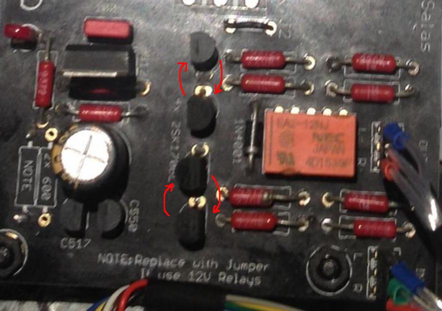

Have measured across the outputs from L --G-- R & have 3.9mV & 4.7mV respectively.
So this is a bit high. Is it possible to bring this down?
Also have measured across the 10R resistors & have 1.6v & 1.8v
Swap the JFETs between them inside each pair of the quad. That should change the results to see if they get better.

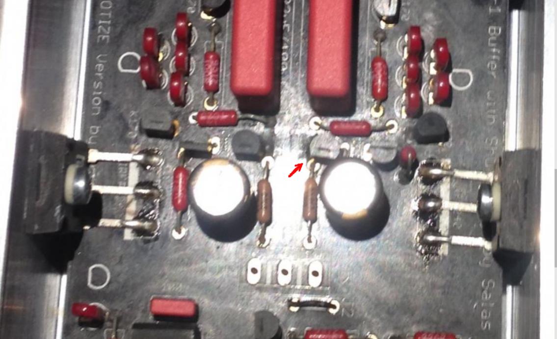

Regarding your negative rail being 0.7V greater than the positive there are two ways to have that difference in a Hypnotize. One is the positive side's bunch of five LEDS to have a lower forward voltage drop (Vf) average or this JFET pointed with an arrow to be much weaker than its counterpart. Or both of those things happening. But that is no problem if the offset fits well the general results. Its then academic like the negative side will clip 0.7V later after the positive if you will drive an almost 20V peak to peak sine wave through to the amp. 7VRMS signal in other words. Most power amps would be already red hot clipping beyond 1-2V RMS signal.
The JFET's are matched pairs & put onto the board as per board designations 9240 & 240.
Are you suggesting taking 1 off each 9240 & 240 out & swapping them over ?

The jFETs can't be matched pairs with those output offsets.The JFET's are matched pairs & put onto the board as per board designations 9240 & 240.

I suspect you have mixed them up or they were never selected by your supplier.
Salas seems to think similar.
Salas, I will swap the JFET's as you suggest. One pair at a time to see if voltages start to line up.

Maybe for very short intervals then let cool. Don't let them 9240 & 240 go 100C on their body, it will be near destruction limit in the much hotter silicon core inside. Its about 5W dissipation for each MOSFET in your build right now. Not little at all for a non assisted power part no matter if chunky looking.
The jFETs should be selected to have very similar Idss.Salas, I will swap the JFET's as you suggest. One pair at a time to see if voltages start to line up.

The mosFETs don't need matching/selecting.
