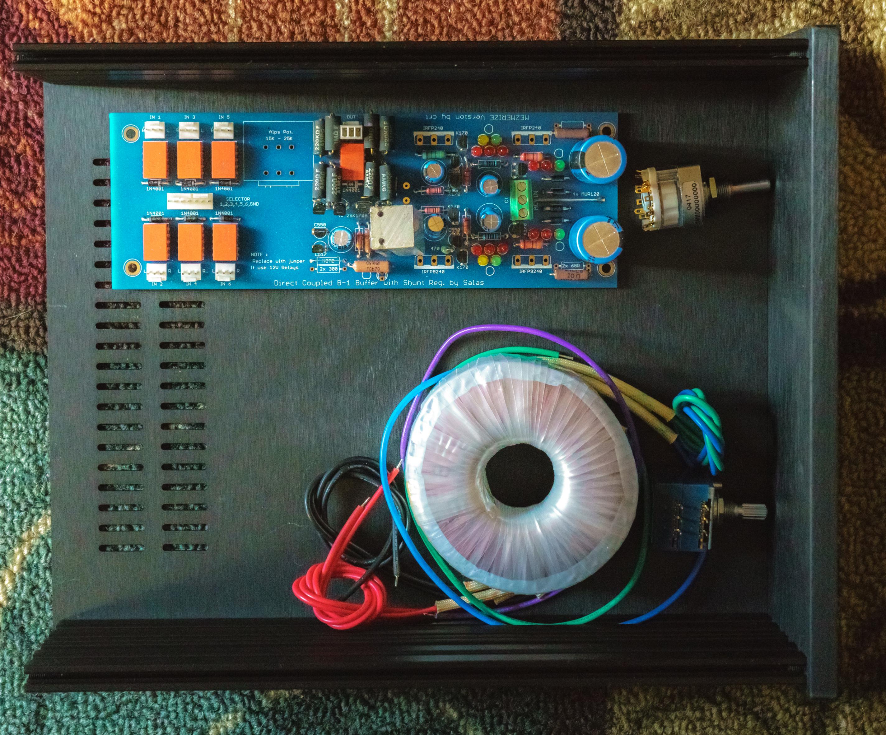

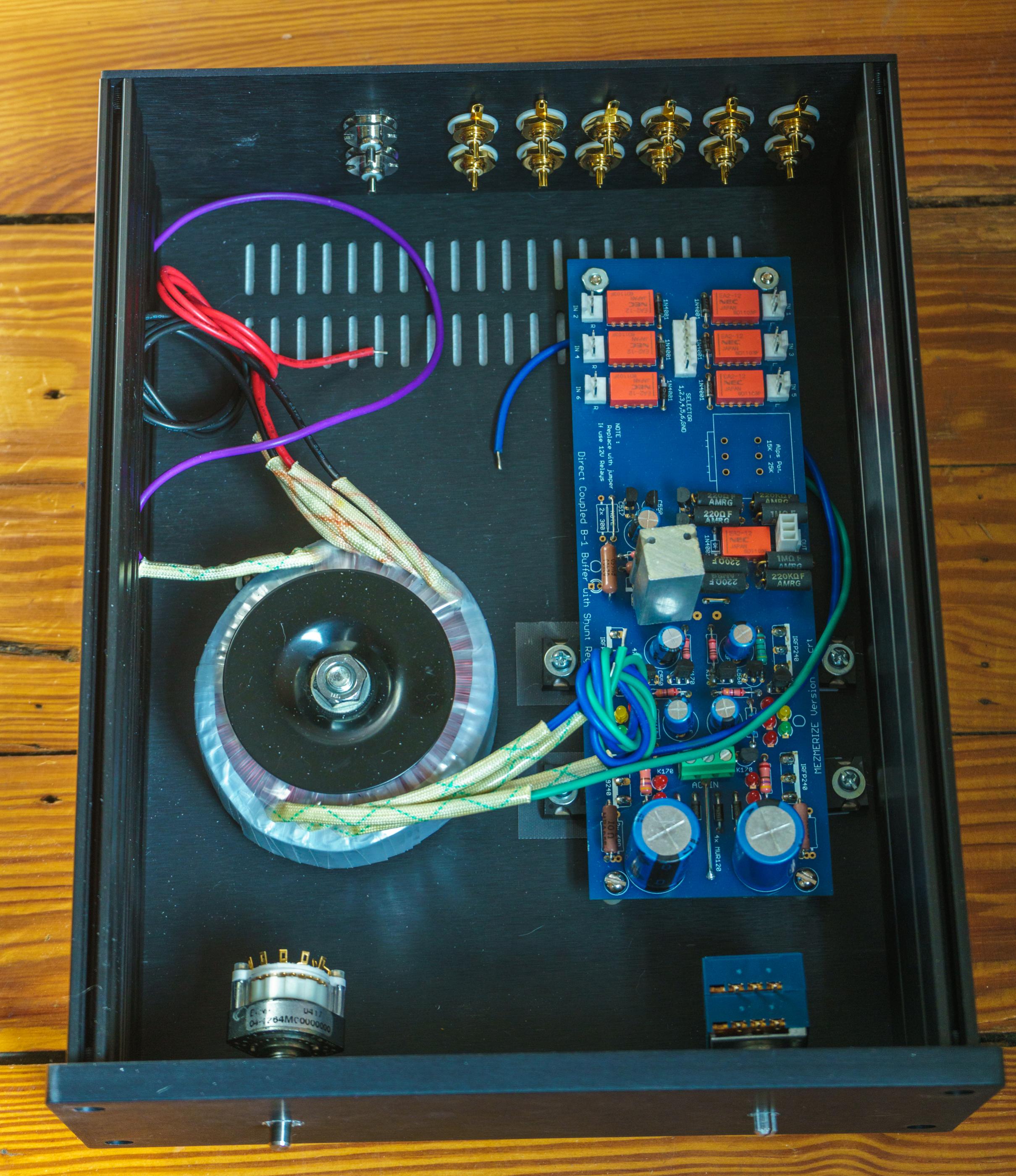

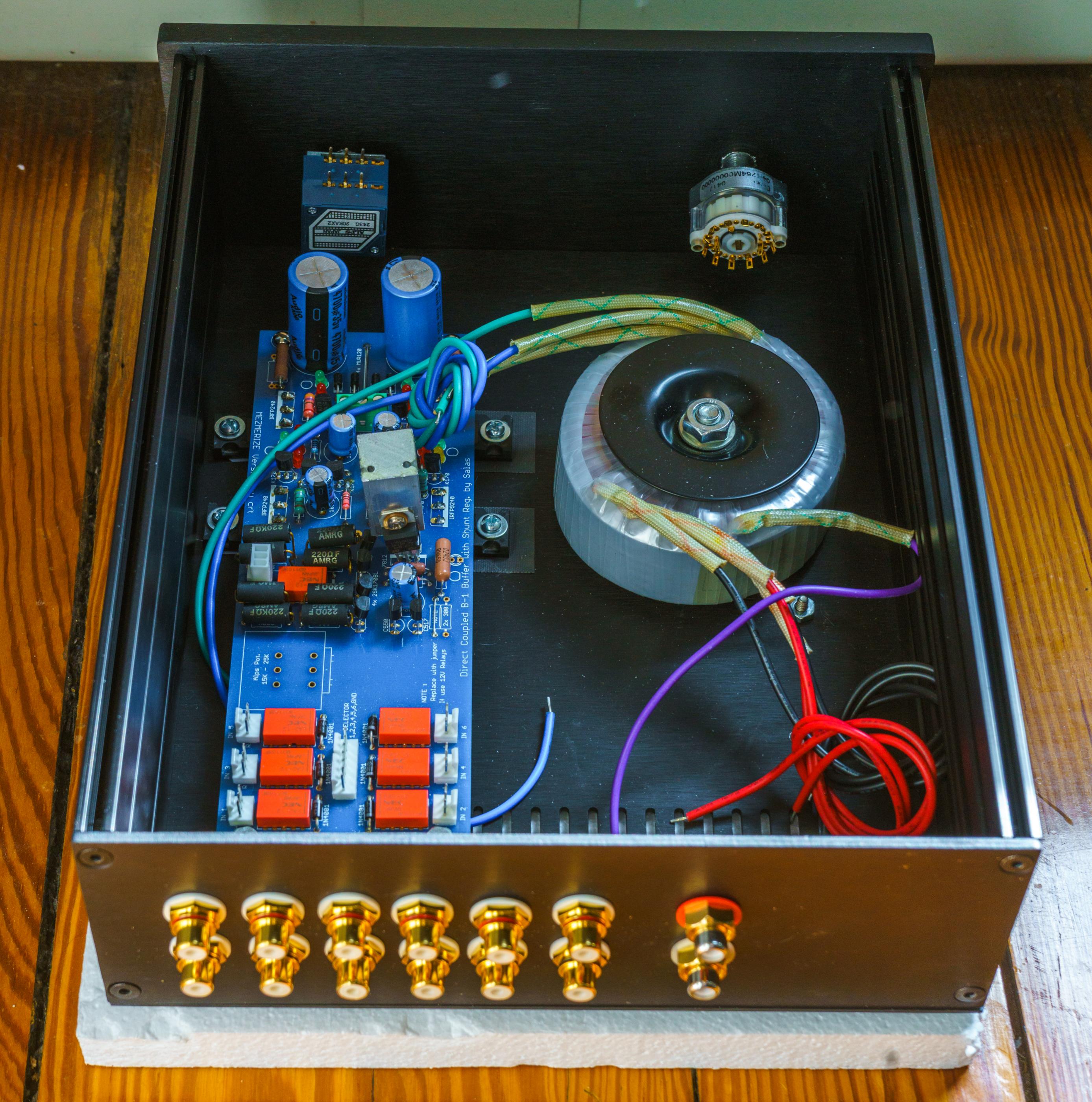

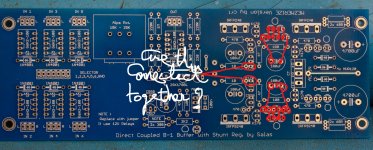

so I'm posting some pictures of the setup and to start asking some question to a happy ending .
1- one of the missing part was an IRF240 , just order at the time that I did with the others but it was back order then and I think is back order today , going to use IRF244 (have a lot of them to be use in Aleph2).
2- When I was working on the chassis I was planning to mount vol. pot and input selector directly to front panel then baaaang, they do not fit properly , I have to use a small extender, if you can please advise on this one is going to be apreciated.
3- I need to order power entry filter module, is 3A ok, it has power switch and fuse built in but don't know if comes with the fuse, anyway going to order a couple of them. My transfo is 50va , is 0.5 A ok?

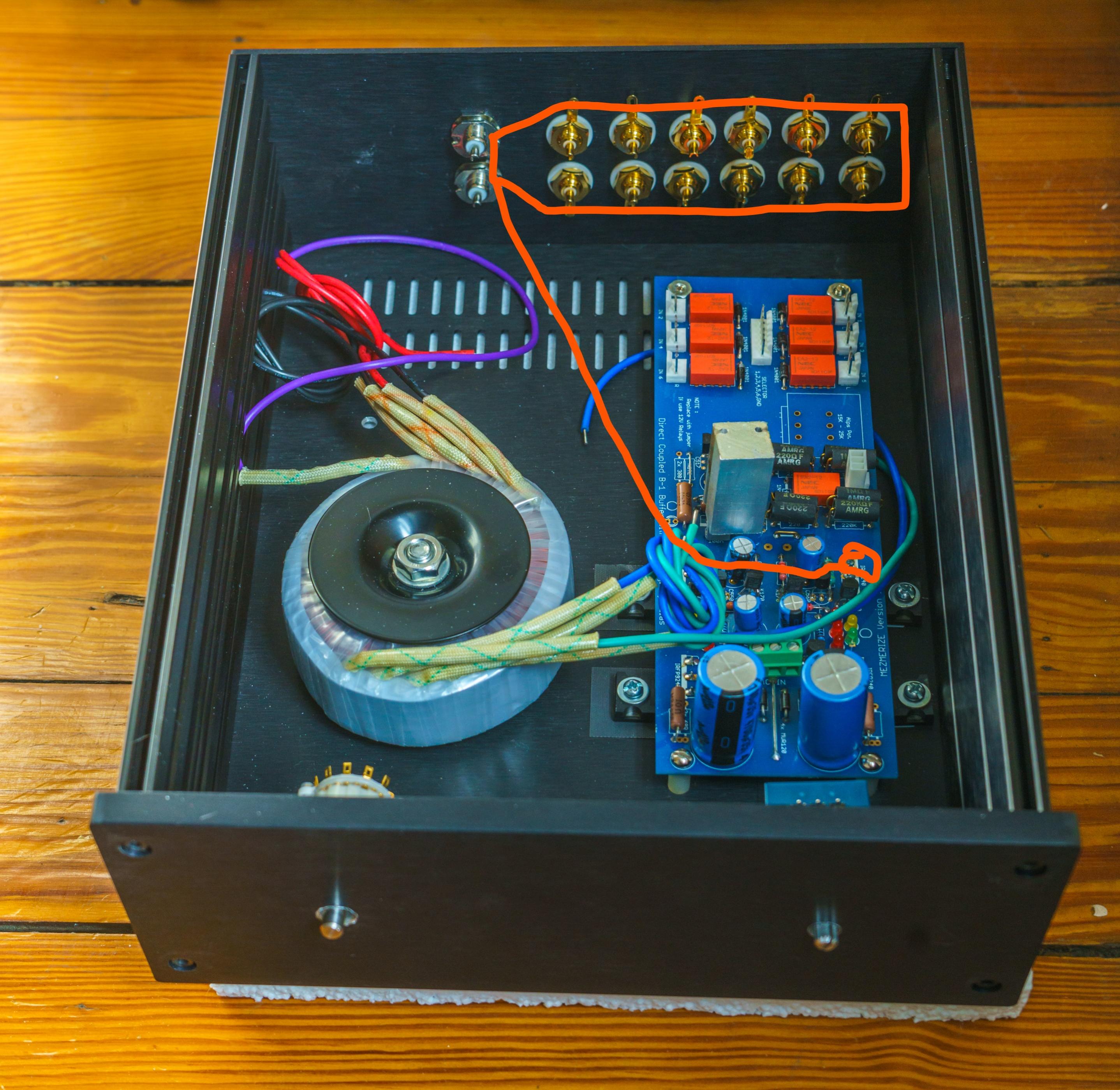

4- In one of the pictures you can see how I'm, going to wire the RCA's, some advise here too. and finally for now
5- Can I start testing to see if the led's working without any fuse connected ?
Thanks in advance.( pictures too big )

For the RCA wiring you should have the female connectors to match the 7 male connectors on the board, as well as the one that connects to the selector switch. Each pair of RCAs will connect to a 3pin connector, LGR the center pint is the shared ground.

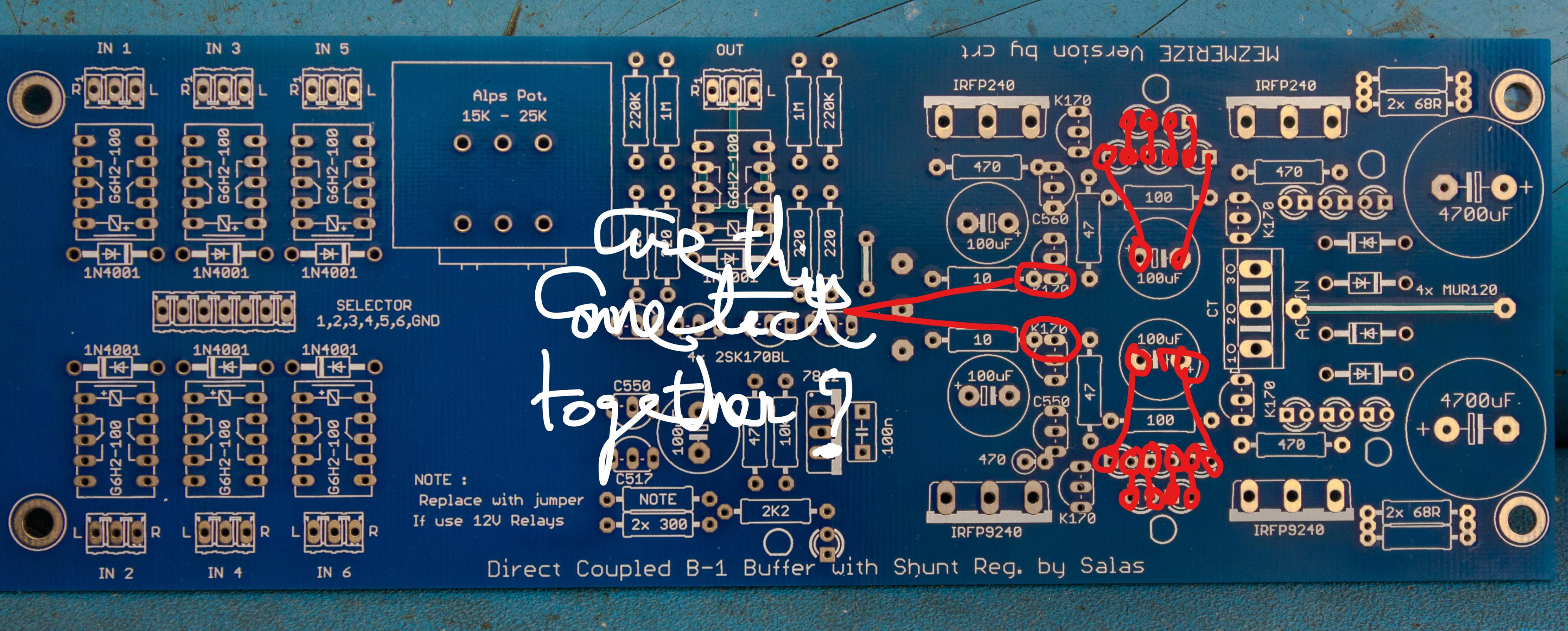

Thanks Nezbleu, I managed to built the dim bulb tester and fired the Mezmerize but the group of LED's from the IRF9240 (is this the positive side?) did not lit at all. Took some measurements : across 2x10R=1.65 vdc (irf244) 2x10R = -1.46 vdc (irf9240) V+ =0.625 vdc V- = -9.36 vdc across 100R = -0.52 vdc (irf244) , acroos 10R = -0.20 mv across 100R = 0.49 vdc ( irf 9240) , across 10R =-0.00 mv 7812 In to G =22 vdc out to G =11.91 vdc In to Out =10.11 vdc Across 47R =-0.00 (9240) Across 47R = -0.2 mv I did change Irf 9240 close to that group of LED's but did not fix the problem. Going to unsolder the led's. What do you think guys ? Thanks in advanced.
The usual reason for that is that one or more of the LEDs is inserted wrong or open. With circuit not powered use your DMM on diode test mide and check each LED, see if each one individually lights up. It looks like you've got about 300mA going through the CCS right?
Really do not know , ccs is through the 2x10R resistors? then when I check thje LED's in diode mode they are going to lit if they are good? Thanks
Yes, CCS current in each polarity supply is indicated by the voltage drop across each 10R resistor. If your DMM has the capability to light up an LED in diode mode testing you will know it either from its manual if it states more than 1.5V test voltage in that mode or by just trying it on a spare red LED first. Red probe to LED's anode, black to cathode. If it can do it, then go across each installed LED with no need to desolder it first. In that way you will know if all can light up and if their polarity is good. One or more may not light because dead or lights up the other way around so its reversed. Or the whole string of LEDS has been installed in reverse, whatever mistake you will find out. Do that testing when power is off in the dcb1.
Thanks Salas and Nezblue, well apparently my DMM do not turn led's on and you said have to measure across the LED but when I measured across got OL on the meter, I did this with the LED's that turned on, but if measure from one LED to another LED I get 0.00. Sorry for ignorance but I'm really confuse . On the photos I show you how I did the measurements.Thanks again.

Use a 9V battery with two different color wires instead when your DMM's diode mode isn't adequate for LEDS. Go across each individual LED in a row, but be relatively fast because the battery will provide to them full mA also.
Hello Salas, I did the test , 3 LED's were good , the other two were very dim and when I touched for second time (just touched not too much time) I heard small pop up , they don't lit anymore. Now to replace this 2 LED's just chose 2 more or do I have to measure them. Thanks in advance.
The Mezmerize has a planned asymmetry between V+ & V- anyway so don't bother about exactly matching LEDS for their total VF per side. You can't win, the system is rigged 😀 More matching effort is for the Hypnotize.
Hello Salas, I did solder new LED's but still no luck here. I measured BC550, it is 0.1, going to replace it for another one (have to order) then checked the mosfet and not getting the 3.5 to 4 v here , but I already changed this when I replaced the LED's, don't know but this mosfet are kind of delicate.
