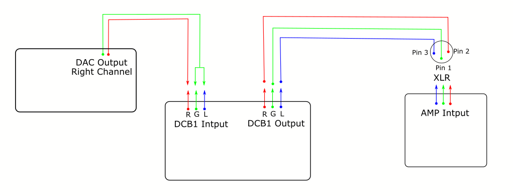

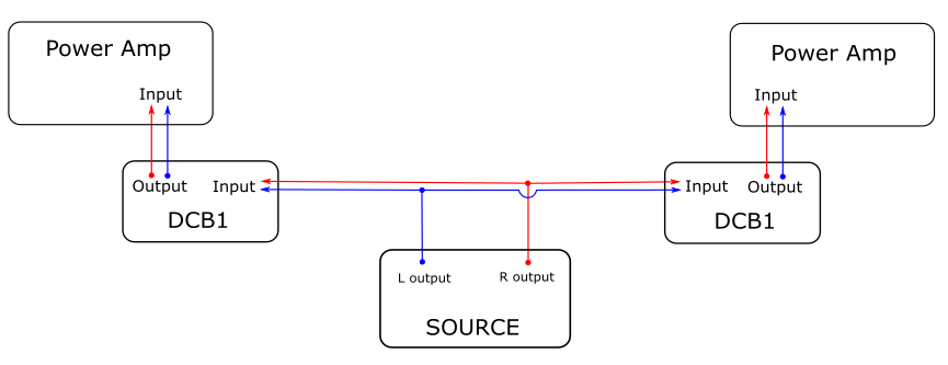

Right now my dcb1 are in 2 different casing. Or perhaps I can run them as mono? Each driving a mono amp?
You can probably parallel the available channels for double the driving current availability and half the output impedance
I am not sure how to translate your explanation into a diagram.
Well, parallel is simply parallel. Feeding input signal from a source's one channel to both DCB1 channels and driving an amp's one channel from both the dcb1 channels outputs. Talking SE. For bridged balanced I showed with the two channel XLRs wiring schematic.

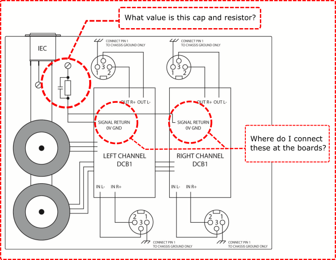

10R 0.1uF
To the PSUs outputs middle zero pads (at the area you note the rails Voltages results in your troubleshooting pictures)
The Main Audio Ground (MAG) to Chassis connection (as shown) is not able to pass Fault Current in the event of a mains failure incident.10R 0.1uF
I also recommend that the two connections be made separately to the Chassis. Either direct wire connection, or via a Disconnecting Network that is rated to pass Fault Current.
If the two separate DCB1 need an audio connection, then make that separately to maximise the audio performance, not via the Safety connection.
