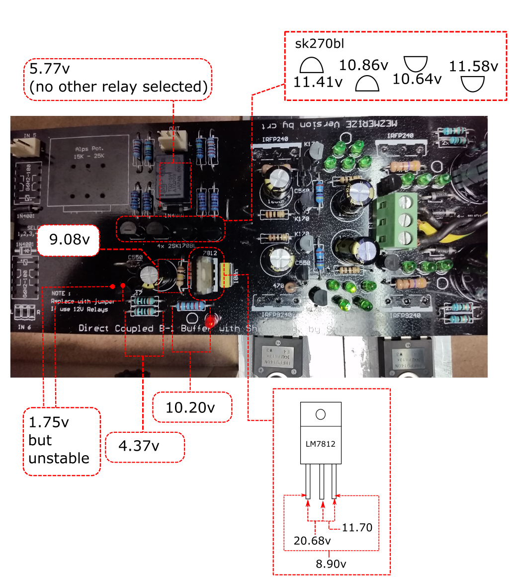

Okay. I changed the bad LED and the BC550 and now it lights up and I can hear a clicking sound after powering on. But the left side dc offset is running at 11.08mV and 9.00mV and the right is running between 158mV to 128mV. And it keeps going up and down for both channels.
I checked it again and now it starts at 300mV at the right and running down. The left channel starts at 11.00mV and goes down to about 2mV. Then it goes between 2mV and 9mV.
I have actually installed a CL-60 thermistor between the mains 'L' and the transformer. I don't know if this is causing the problem.
These are the measurement.
The rail voltage for left is 10.63v and 11.64v for right.
DC offset at right channel is 300mV but going down.
DC offset at left channel is 30mV but going down.
In place of the BC517 is a BC550.
In place of the BC550 is a zener diode at 3V 1W
The zener diode measured at 1.944v

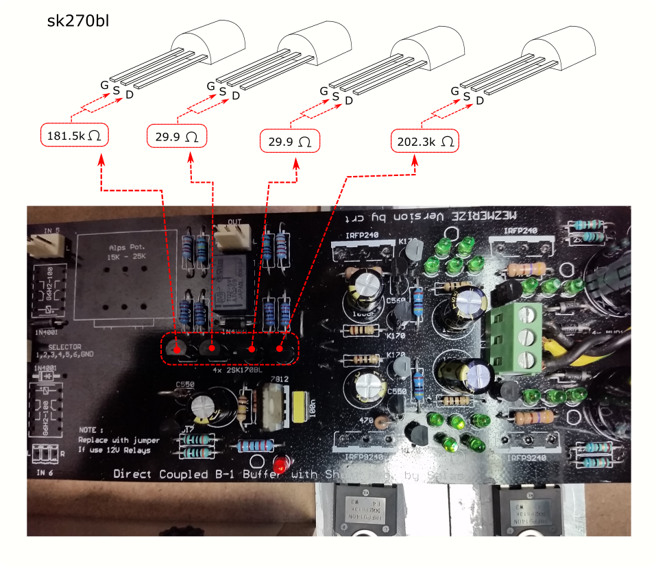

The rails and relay coil voltages are in range now. Not greatly matched but fixed. With the power off, measure each 2SK170 of the audio signal quad with the DMM in Ω mode across Drain & Source. When good they are showing in the range of 50Ω each. There is danger they went too hot when you had +20V -10V rails malfunction. Also connect a pot just in case some open input noise component is passing through.
Put the resistor to the +V drain line where its usually located in this test and check again if it gives the same indications.
Attend to better rails symmetry given the chance. Try to bring the 11.64V rail down by a Volt. Needs the leg trick or it has stronger Vf Leds in average than the other side? Measure the 5 Leds drops individually per side as they are alight. Make changes where needed. Then solder back to the board your two best Idss matching pairs. Connect a pot in the end also.

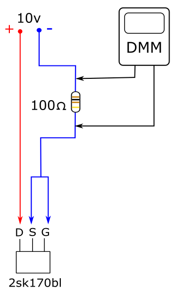

From NP : a quick way to measure the 2sk170bl ( picture).

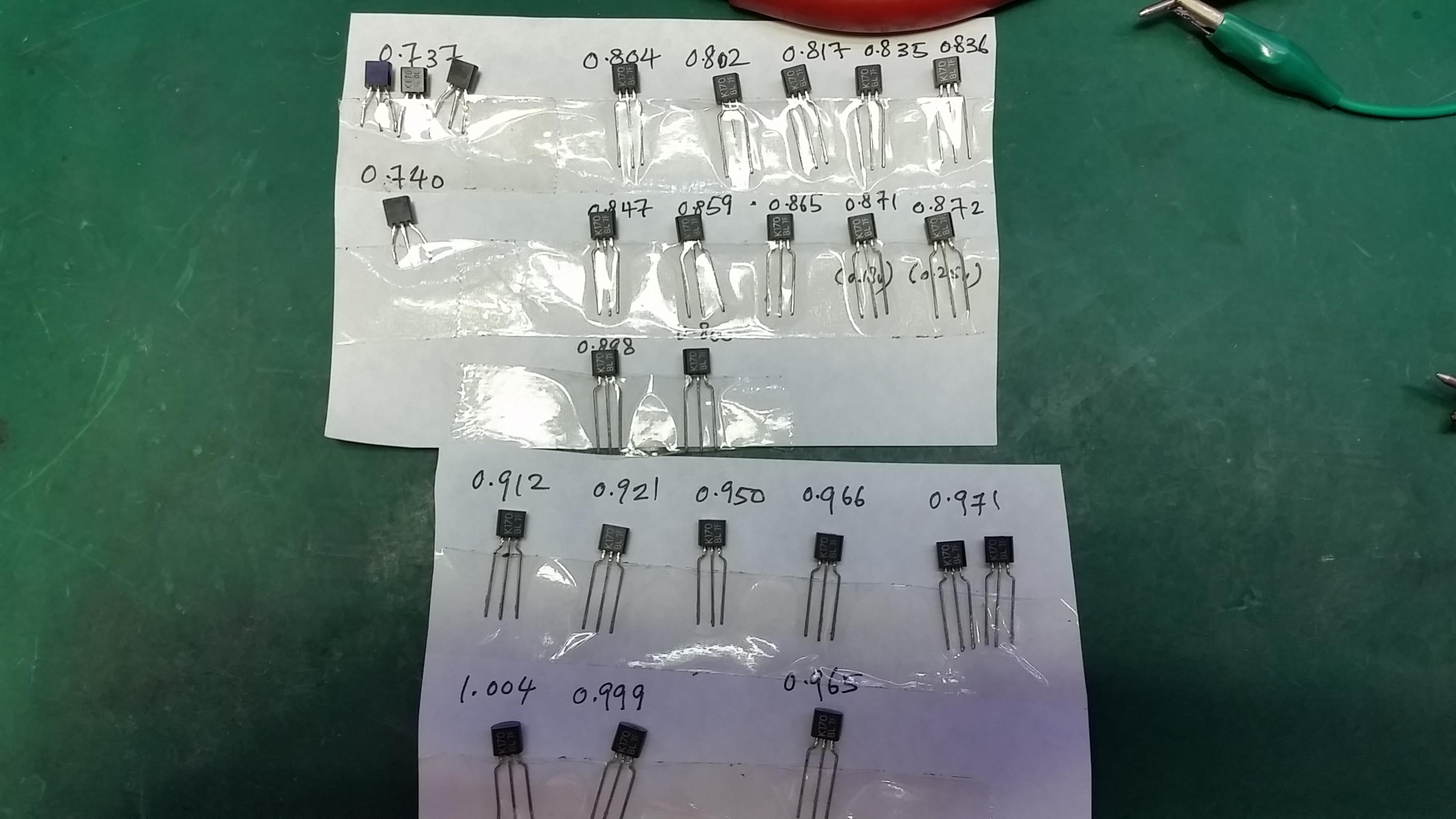

I have removed and measured the quad 2sk170bl and the measurement is as follow:
3 pieces is at -0.737v and the other piece is at -0.740v.
these 4 measurements indicate that the Idss is pretty close and that they are probably undamaged.
That then cannot explain why you are getting major output offset errors.
Maybe there is another damaged area?
