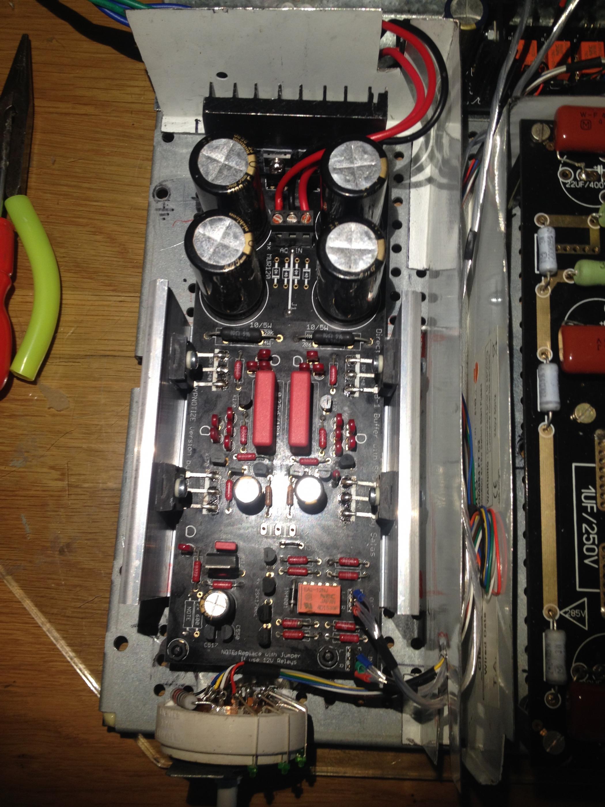

It works, However.
Dcb1 is up & running All LED's lit
The voltages at V+ = 9.8 & V- = 10.5
is this ok ?
As the board has been hot rodded with 10R 3% does this mean it's running at 200mV ? how & where do I measure this ?
If I choose to Hot Rod it some more which resistor/s do I change & to what value?
Hears a pic of the board, It will have more space in the final build & probably a bigger heat sink.

This is a Hypnotize in the picture and it could be doing better rails matching, the Mezmerize is the one designed to self create some rails asymmetry.
Nonetheless critical is the DC offset outcome not the rails values per se. So measure DC mV at the audio outputs. If its low all is well. Up to 5mV is acceptable, up to 3mV is good, up to 2mV is fine, less than 2mV is great.
When you measure the Vdrop across each 10R resistor you know the current by Ohm's law I=V/R. Usually falls somewhere between 150mA and 200mA.
To hot-rod more, you just use lower than 10R current setting value. Say by -2.5R step. But the resistor's own dissipation and the need for Mosfets sinking goes quickly up. Many users agreed that 10R sounds good enough while the temps and sinking are still very manageable.
