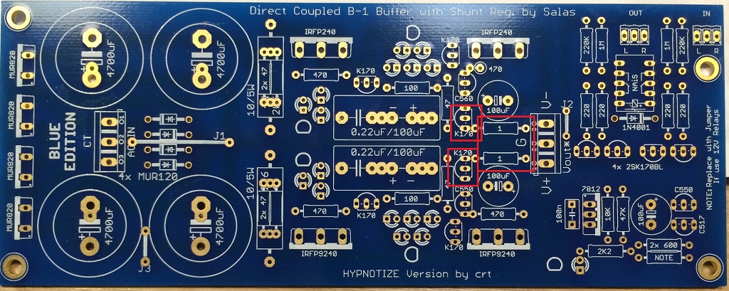

Hi, a question for Mr. Salas:
earlier (page 168 maybe), you wrote:
"When there is a problem with sourcing good semis you may test an alternative I just thought for you regarding the Mez PSU section. Use Fairchild PF5102 (currently in production) for all the JFETs except those two next to the 10R resistors places. You omit those two JFETs. You jumper their outer pads instead with short wires and you use 120R instead of 10R next to them. The resistors value change is mandatory, not something to be left for later. 100R is acceptable too. Don't try other random values. See attachment.
Attached Thumbnails".
Now, I have Hypnotize board, which in mentioned position has 1R not 10R (at least what is on board).
So is PF5102 possible to put only on Mez boards, or I am misreading something?
Referring to posts #1669-1671 I believe. It can also stand as a modification solution in the Hypno by using the 1R positions. Prefer 220R in the Hypno.
Thank you very much!
So, to make resume:
1. 2sk from psu section are are to be replaced (6 of them)?
2. BC's stay in place?
3. 2SK closest to 1R are to be "jumpered" (outer legs)?
4. 1R is to be replaced with 220R
5. no degradation of sound or impact on stability of B1 with this replacement?
Thank you for your time Mr. Salas.
Tommy
So, to make resume:
Tommy
1. 4 out of 6 positions. 5&6 are those connected to 1R
2. Yes
3. Not populated & jumped
4. Yes
5. No instability. Subjectively not sure if 100% the same but technically a competent substitution/mod when out of 2SK170s for the PSU section or when having only dubious samples
2. Yes
4. Yes

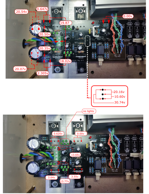

No, keep it. 22:1 is even a better ratio than with a 20k pot. That 220k resistor is to guard for always having ground reference to the Jfet's gate even if a pot's wiper or a switcher attenuator's contact momentarily breaks its path to ground. Also for when there's no input side pot if DCB1 is used as a non signal level adjustable buffer. Not to produce output DC during such a circumstance. Only needs be high enough resistance value for leaving the pot's log taper unaltered.
The 0.647V drop on the "dark side" is too low. Measured Vgs of the Mosfet next to it VS its opposite on the other side is bad also.
Measure all Leds and diodes first for Vf with DMM's diode check mode. If its not able DMM for output to light up an Led use a battery and a couple of wires to touch up quickly the Leds pads. 20.16V dark side's out rather says top left Mosfet is gone or shorted externally.
All the mur120 diodes are between 20.55v to 20.74v. The other Mosfet next to the '0.647V drop' measured at 0.00v. But I have just replaced these. in fact these are new Mosfets. I used 1.5v to touch up the LEDs but there are not lighting up as well.
Sorry, those LEDs lights up at 1.8v. 1,5v was too faint i wouldn't see the lights. All LEDs lights up at 1.8v except for one. I'll change that and report back.
Thank you again.
Thank you again.
