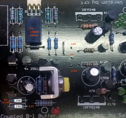

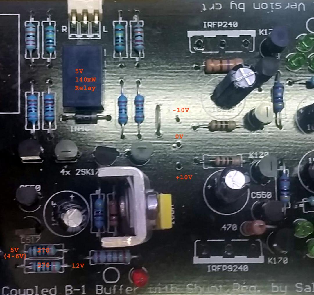

Why is it that when nothing is selected (the rotary) the diode at the output measured at 2.9v? And when one of the input is selected, the output diode measured 0v. It turned off when each input is selected?
The output relay coil powers from same line coming out of the 7812 through the double resistors (which say 2x300 make yours 2x270 which is an easy number) and should be always on. Maybe the rotary shorts that line to ground in some positions?

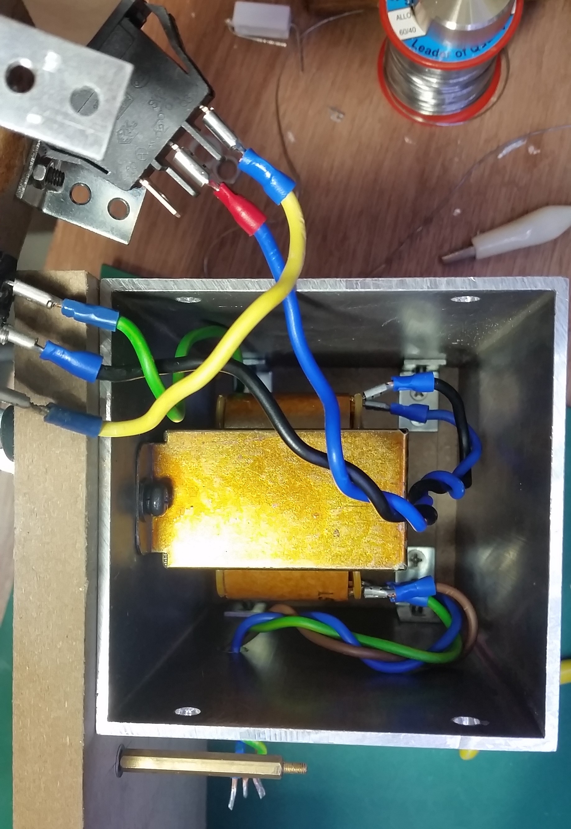

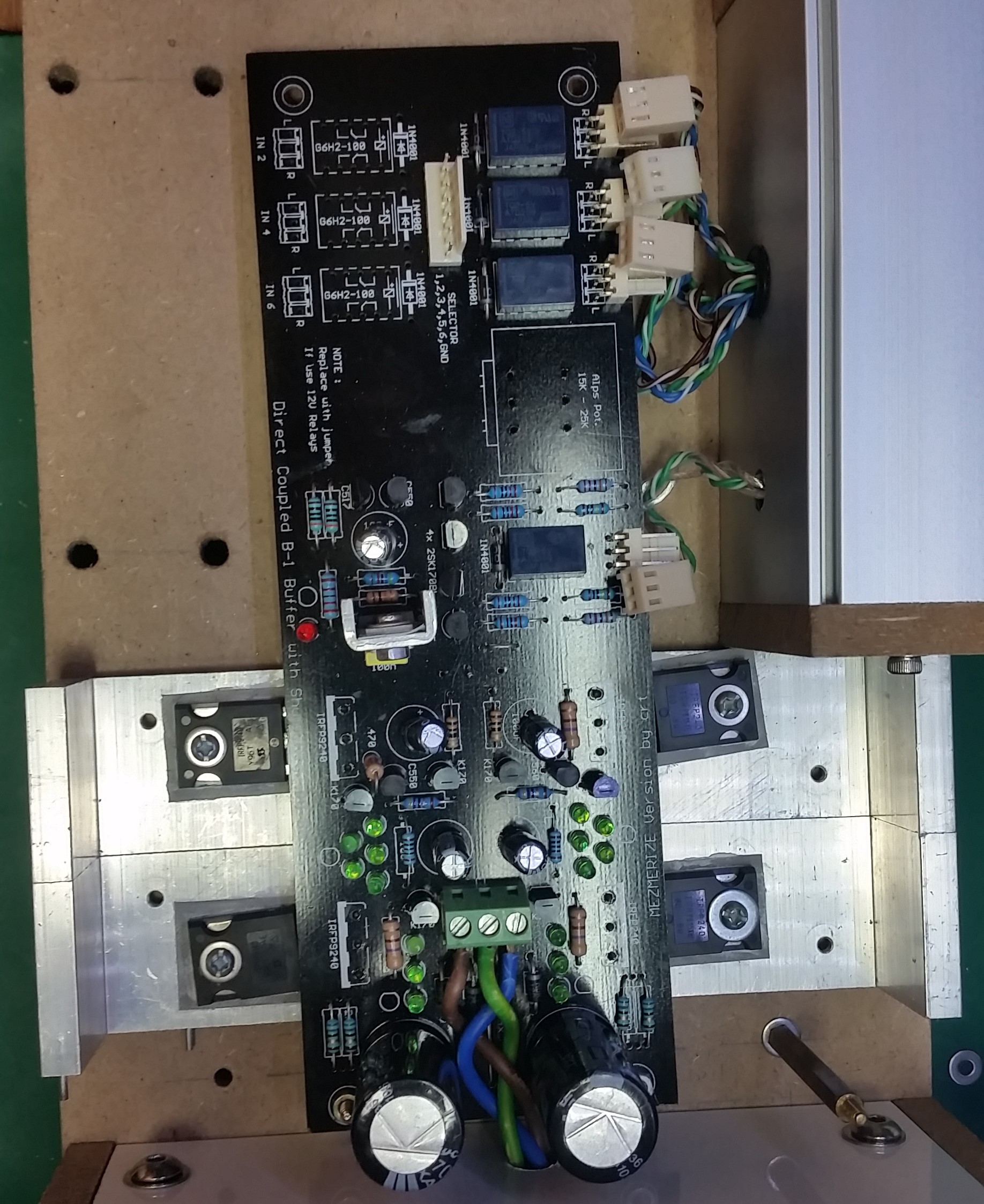

I have removed all connection form the board. The 2 x 600 resistors are indeed 300 ohm resistors. I measured them and they are at 298 ohm Sorry for the wrong info. The problem is with the transformer. The amp buzz even without anything attached to the transformer. Which means, just plugging in the transformer the amp goes buzzing.

Check that the green wire at power entry is really the centre tap at the transformer.
This would be better twisted, rather than plaited.
I don't like your exposed mains terminals close to your metal work !
Check the DC voltage at the inputs to the regulators should be ~ +21Vdc and -21Vdc and 42Vdc across both.
Check the Vac at these inputs. Should be near zero mVac if you meter is OK with a high DC bias.
Check the DC voltage at the outputs from the regulators (the three pins near the middle of the PCB), should be ~ +10Vdc and -10Vdc and 20Vdc across both.
Check the Vac at these outputs. Should be zero mVac.
Yes, twisted pair/triplet gives closer contact and smaller loop area than plaited. That equals less emi.
Keep in mind that only one power Flow wire passes significant current at a time. The other passing virtually none.
So you have one power and the Return wire acting as the close coupled pair. Then half a cycle later it's the other power wire and the Return that acts as the flow and return pair.
You have to keep each of those pairs close coupled all the way from the source to the receiver. The twisted triplet achieves this.
