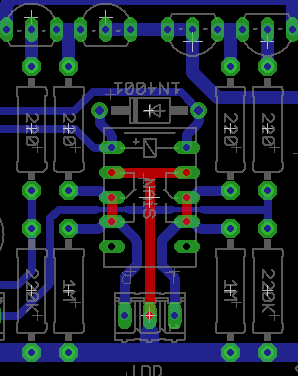

Your Mezmerize runs well on the standard original minimums. It was designed to can even run without sinks and on small transformer, hence the 12VAC not to get hot. The slight imbalance actually helps to get better offset when with non stellar Idss matching. Some ways mentioned in the course of the thread are just clarifications to users wanting to expand in a hotter theme. The base design has not changed. If you want to mod your relay for resting to ground in your first gen board you can do it by adding with wires the red lines seen in the attachment.
Ha ha I then bought another newer revision with the mod and built it (built many a Mezmerize) but never replaced the old one. Will place some wire as it seems a simple mod.

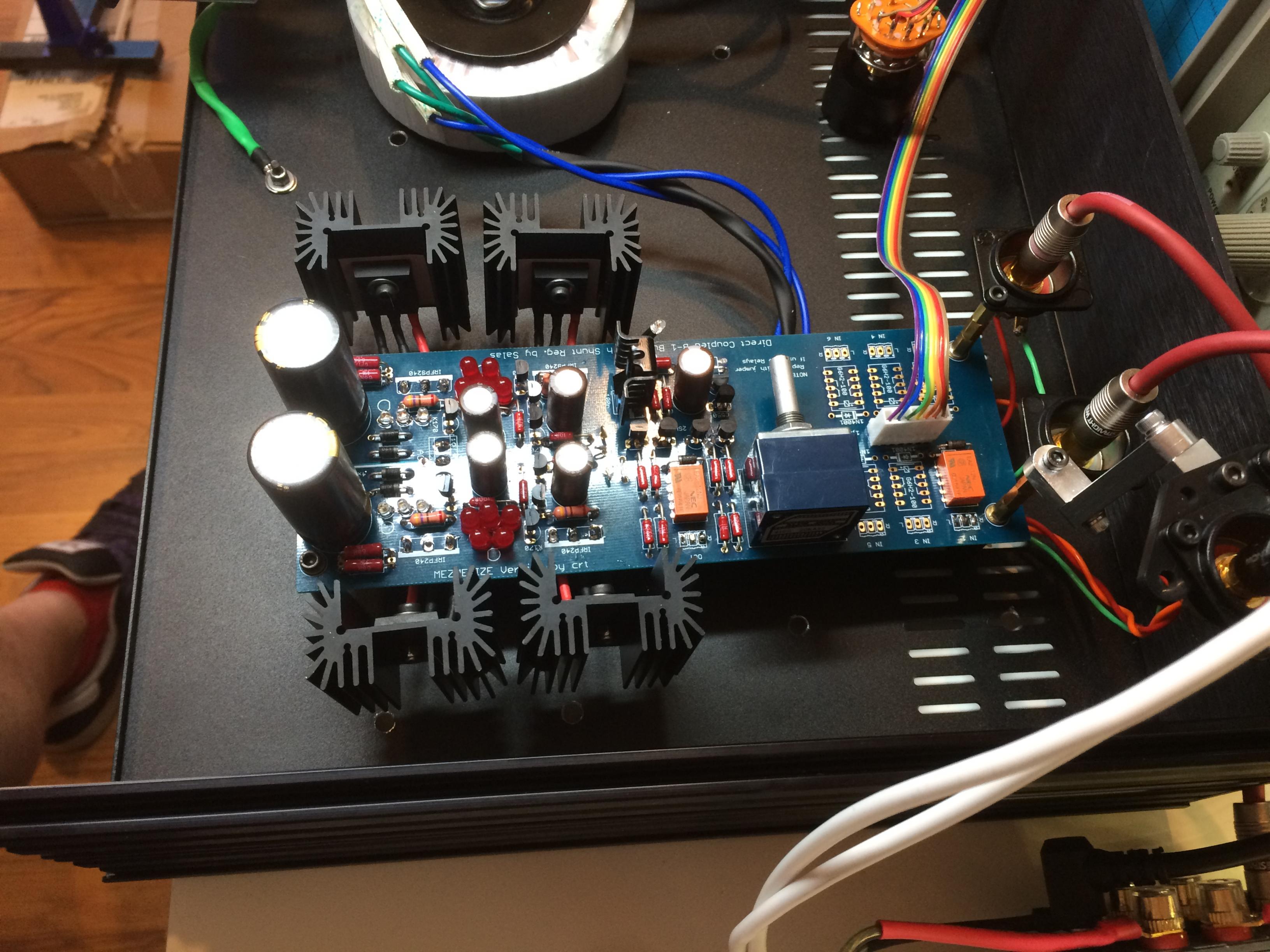

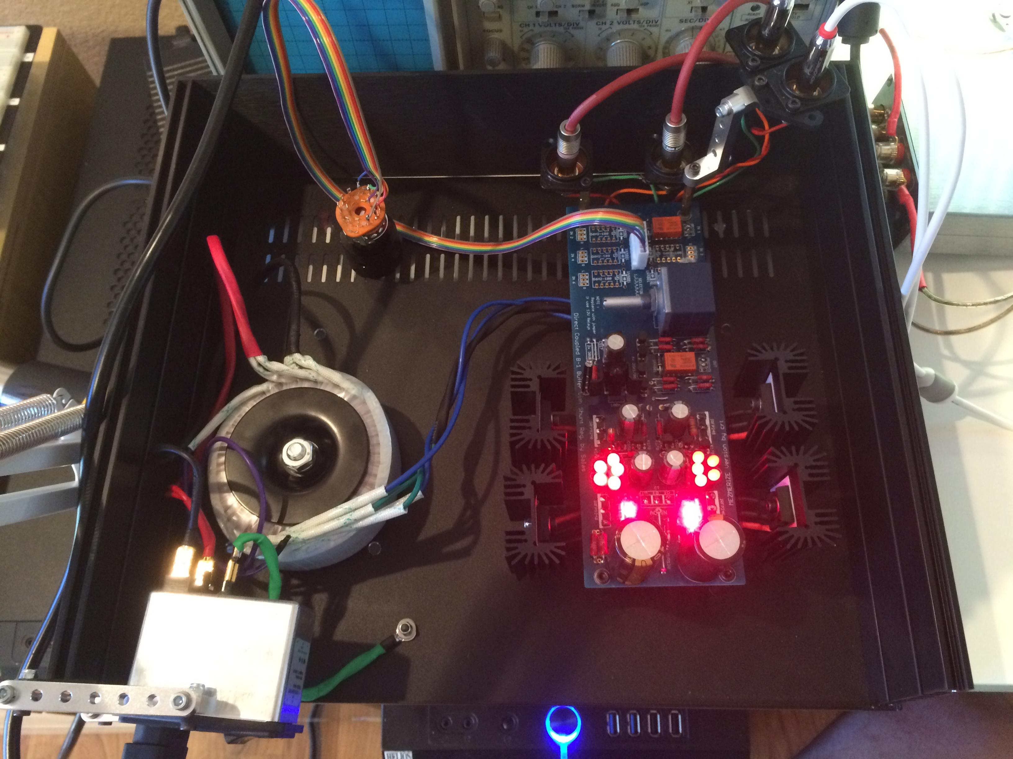

I finished my Mezmerize yesterday and spent a few hours listening. I quite enjoy it, but am hesitant to put it into my system as it will be feeding an F5 with no DC speaker protection circuit.
Measurements taken with volume pot turned all the way up(20k ALPS RK27):
# Vout
9.91v
-9.70v
# Voltage across 68ohm resistors
1.473
-1.584v
# Current across 68ohm resistors
0.093mA
-0.088mA
# Output offset
Right: -03.5mV
Left: 00.9mV
## after switching right channel k170s
Right: -03.2mV
Left: -01.9mV
The above was taken after I did the 'leg trick' as well.
Perhaps I can/should better match (idss) the 4 audio jfet's?
As for output coupling caps, I have a few film caps on hand, and have ordered some k75's. I can order some WIMA mkp's if that is a better option as well.
Thank you!

edit: forgot to attach pictures
what's the offset at the speaker terminals with the vol pot at three positions (highest , middle & lowest) and with the Source connected (both switched off and switched on).
The measurements are as follows:
# Source off, Lowest volume pot, offset @output connectors
Right: -03.7mV
Left: -00.8mV
# Source on, Lowest volume pot, offset @output connectors
Right: -03.8mV
Left: -00.8mV
# Source off, Middle volume pot, offset @output connectors
Right: -03.7mV
Left: -00.8mV
# Source on, Middle volume pot, offset @output connectors
Right: -03.8mV
Left: -00.9mv
# Source off, highest volume pot, offset @output connectors
Right: -03.7mV
Left: -00.8mV
# Source on, Highest volume pot, offset @output connectors
Right: -03.5mV
Left: -00.8mV
On the bench my source is an iPhone, so I connected the 3.5mm to RCA 'y' adapter to the input RCA chassis connectors. For the 'source on' I left the 3.5mm plugged into the phone, and 'source off' I simply unplugged it.
I may be mis-interpreting the test conditions you outlined in your reply.
hmm, now that I re-read your reply, I think you may have meant for me to connect the mez to my F5 and check the offset at the speaker binding posts. If that's correct, I'll set that up this afternoon, and resume the tests.
Thank you!

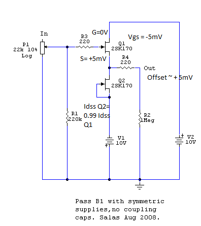

I have a question regarding negative/postive DC offset. According to AndrewT the negative offset indicates that the follower is running at less than Idss. However, if I put the lower Idss transistor as the current source (the follower is running at
<100% Idss) I get the positive offset. Given the gate sits at 0V this would mean a negative Vgs which is consistent with Idss of the follower <100%. So why the negative offset is suposed to reflect a desribale condition (the follower <100% Idss). What am I missing?
you have two jFETs in series.
select the lower Idss as the CCS.
That means the higher idss device is the Follower.
Run a jFET at less than Idss and you find that the Nch jFET requires a -ve Vgs.
This -ve Vgs is the -ve offset at the output.
Now swap them around so that the higher Idss is in the CCS position.
The upper device now passes a current that is higher than it's Idss. This requires a +ve Vgs
