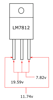

The voltage output (measured from the three pin holes) :
+ 11.73v
- 10.61 v
Across : 22.29v
Vac across : 0v
but across the top and center hole : 0.004v

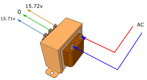

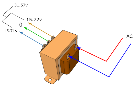

This is the measurement of the transformer.
These are good.V across the secondaries.

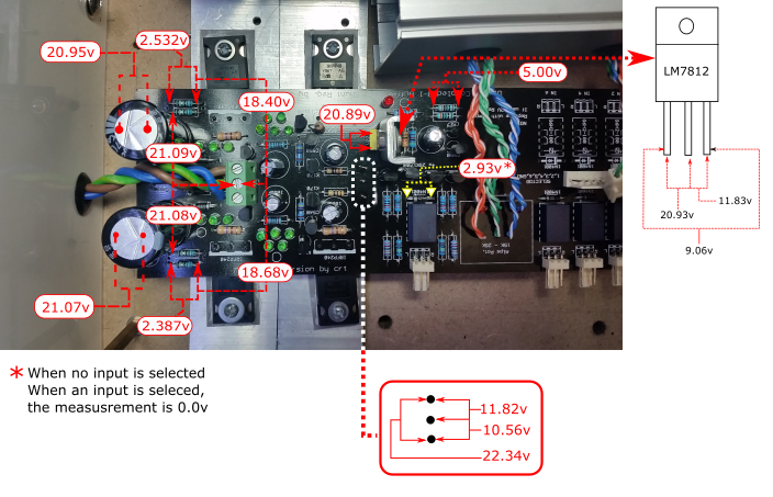

After re-soldered some joints which i think are bad, cleaning up all the soldered area and changing to a new same value transformer (50VA, 15-0-15), these are the measurement. But the transformer still buzzed when plugged in. So, I think it is most likely not the transformer fault. The diodes are in the right position and working good.
