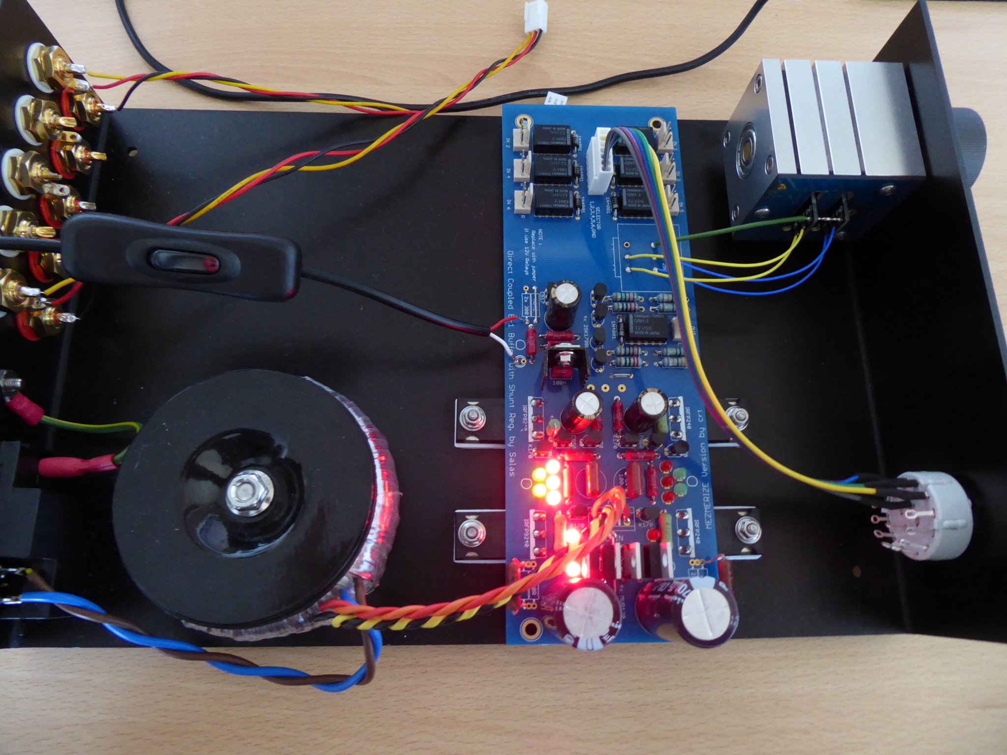

Hi Salas.
I rigged up a 12V supply, using the power LED ground, and the NOTE area. I stupidly didn't remove the 12V reg first though (and you told me to above!). My fault for doing this whilst tired :/ The LED string on one side lit up. Will I have damaged anything by turning it on briefly like this with any bridge back effects?
I wouldn't think you damaged something in the preamp's main circuits with just 12V. You probably energized the plus side shunt reg for a moment. Maybe the 7812 chip reg itself could have sustained a hit because reverse biased. But it is the suspicious one to replace anyway.
Thanks, that's good to know 🙂 So with the reg. now removed, do I make the same measurements again around the BC550/517 delay area? I noticed the output relay clicking, but again no relay clicks from rotating the input selector switch.
Do those measurements to see if they come closer to my noted voltages so to establish all is well with the output delay and its relay when fed correctly with near 12V after the 7812 reg.
Then go on with debugging the input selection section.
