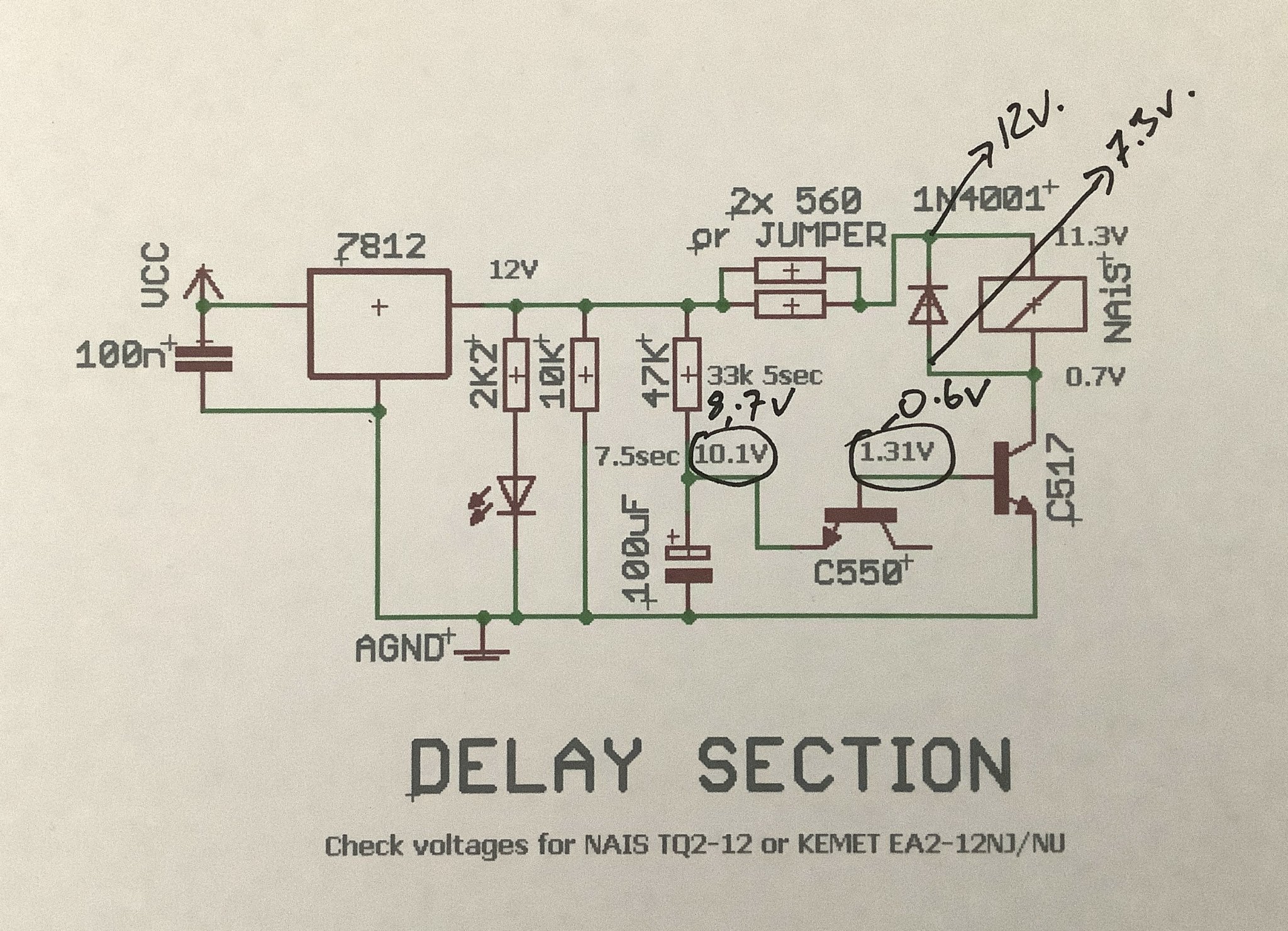

Measurements taken with the 12V reg removed, and the external psu connected.
Well it’s fixed the 12V issue (yay!), but the other voltages around the BC550/517 look too low again. So I’m assuming this points to one of those not working as they should? I’m going to check that 47k resistor too.

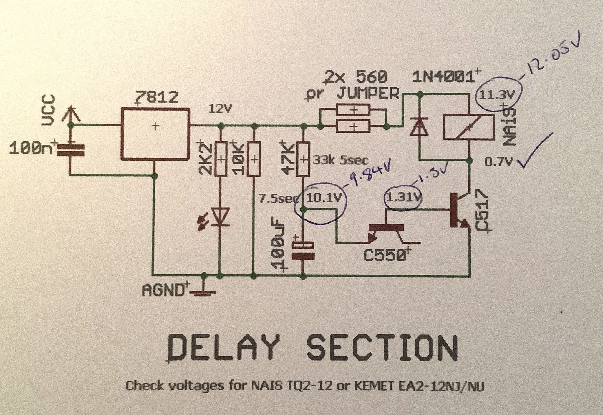

Today I replaced the BC550 and BC517 transistors. The voltages now look much better, though should I be concerned about the 10.1V on the emitter of BC550 measuring a little low at 9.84V ?
The good news is I can hear the output relay click clearly now after a few seconds. And the input relays also each click too when changing the selector pins
Looks like it works. 10.1V or 9.84V no matter. Its around there a BC550C sample shows its reverse Zener behavior. The 11.3V is meant for across the coil, 12V-0.7V=11.3V. Thus 12V on the coil's top vs GND is also correct. Its the same line as to where 12V was noted at the left of the jumper.
I will be happy to see your good final report. Here's the same test note with better placed across coil voltage indication.

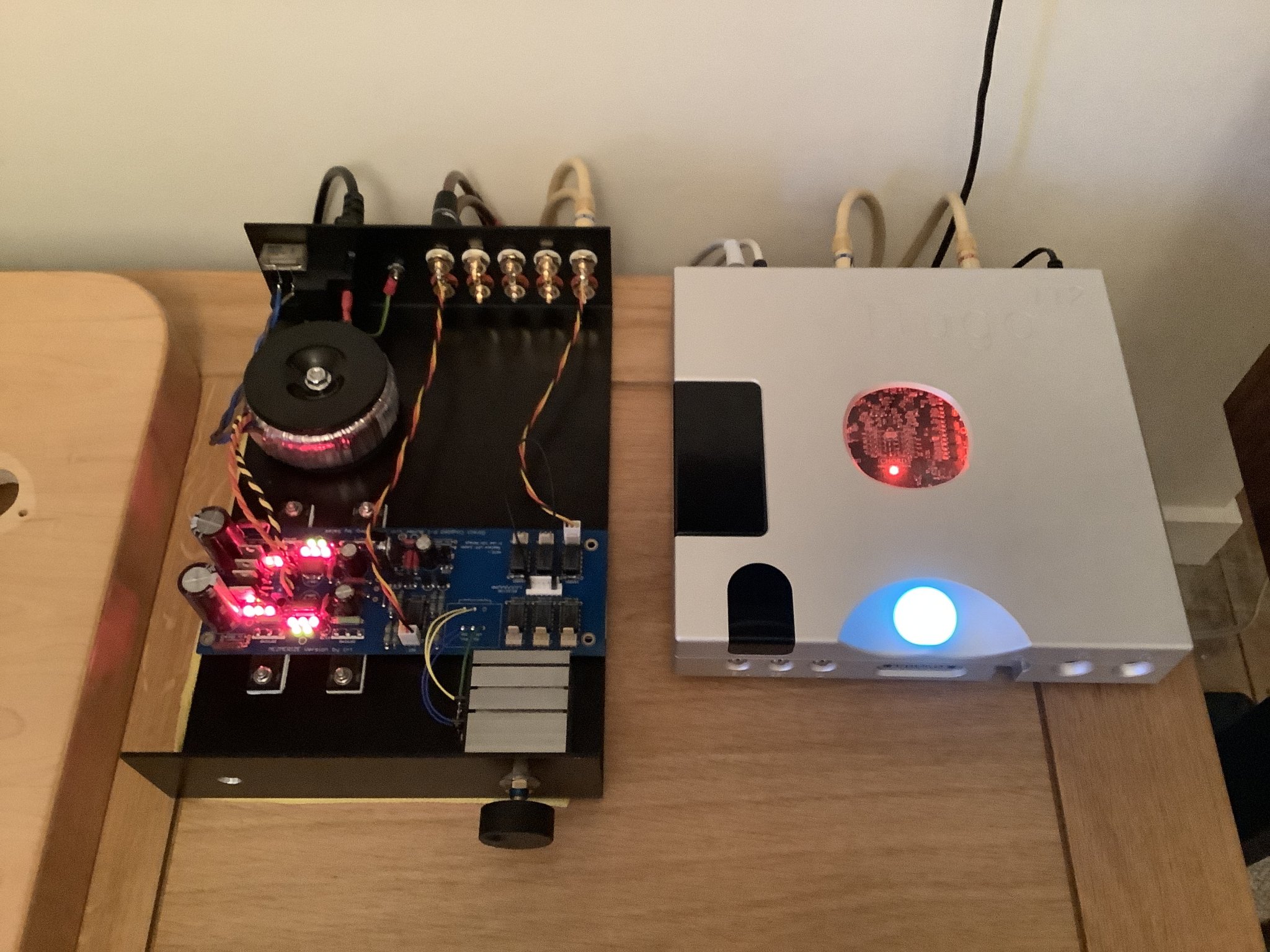

Huzzah!!! After 11 years, she’s finally singing beautifully!
It’s only been a couple minutes, but already very impressed! It’s going to be a music filled evening/night!
Going to soak test it over the next few days, and than can get to work on designing a front panel via Front Panel Express, get my better internal wiring installed etc.
Thanks for all your help over the past few weeks Salas, and of course DCB1 Mez! Very pleased!

Thanks Salas. Well it’s safely passed the soak tests, and sounding better now it’s been running for a while now. I’ve noticed the Mosfets barely get warm, so I may look into hotrodding it further, but only if it’d lead to an audible improvement, otherwise I’ll leave it running with the 7.5ohm CSS resistors. The one-piece chassis/tray is 2.5mm thick, and that slides into an aluminium extrusion which is itself 4mm thick, so plenty of disipation.
Yes, it can handle extra dissipation, but on the other hand its reservoir caps are not planned too big so judge if more mA is better to your own taste.
Mez was meant to be operating at about 200mA standing shunt current per side in general. It was a widely agreed good subjective performance spot before diminishing returns kick in. There are Mosfets Vgs and Leds Vf tolerances but you can verify how much your build runs by the voltage drop across its setting resistors. I=V/R.
