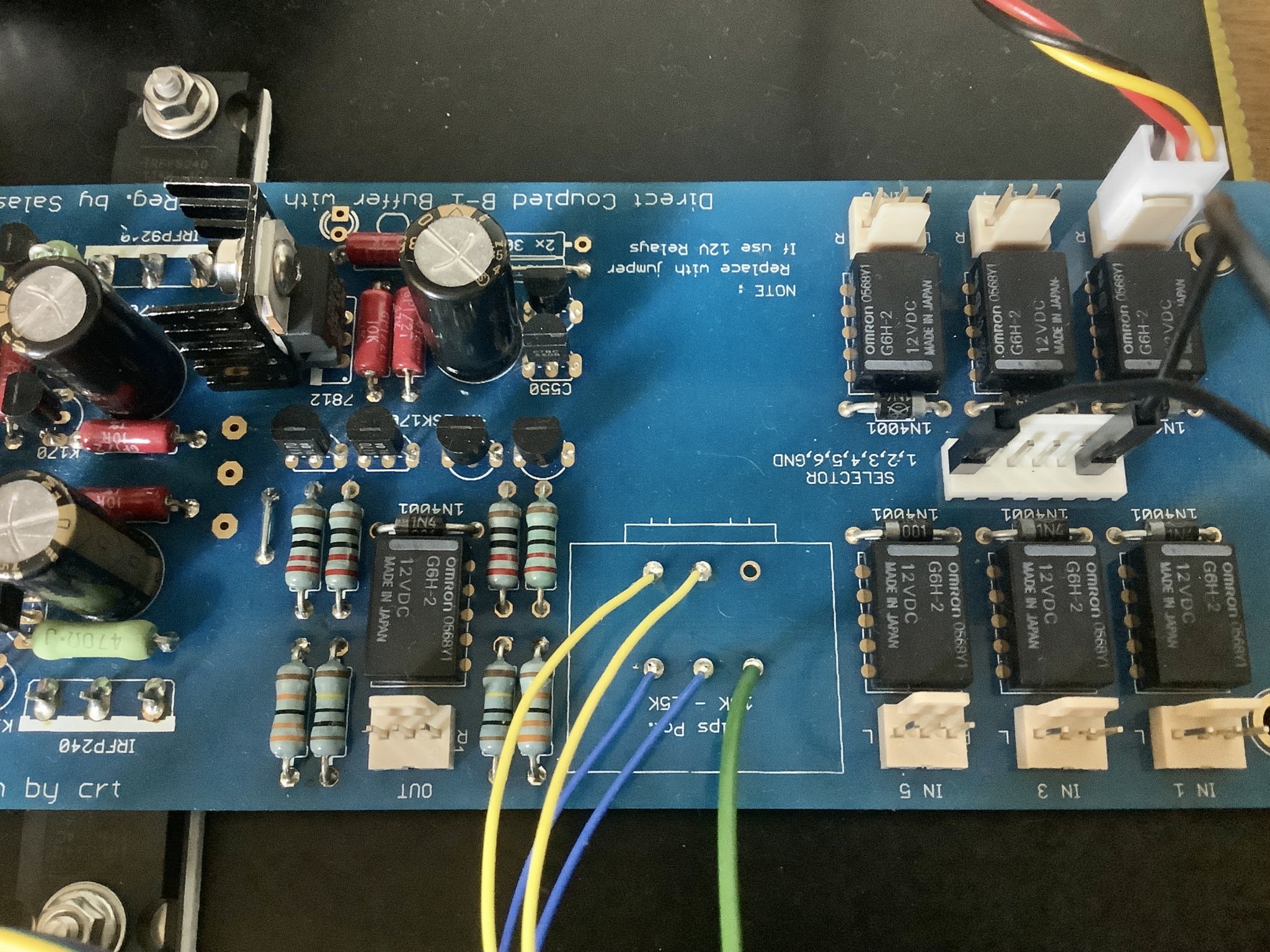

It seems there’s definitely something up with the relay sections on my build.
I’ve unplugged the input and output wiring to exclude that. Using a jumper from selector pin 2 to gnd. Putting a probe on the left or right channel input 2 pin on the pcb, and putting the other probe to the pcb’s volume pot input pad, I get no continuity at all when powered up. So signal is definitely not getting through there.
Even more bizarre on the output side. Putting one probe on either the left or right output pins, and the other on the pots pcb output pads, I get continuity whether powered up or not. It I move the probe to any earth area on the pcb, I get continuity too between that and the output. So seems to point to the relays not doing their thing?
Was trying to avoid it but guess I need to remove the pcb from the chassis now, and inspect the underside again for any possible shorts.
The outputs continuity part to ground when powered off is explainable by the delay relay shorting them to ground for mute.
There is a path to the pot's output pin too but there is series 220R+220R damping resistors +35R JFET RDS in-between.
Don't trust continuity testing that much after the passive input part when powered on. The DMM sends enough DC voltage and it can be trurning on some semi. Alternatively feed 400Hz 1VRMS sinusoidal signal at the pot and trace the path with the scope or with the DMM in AC mode. Can you post close up photos of the input & output relays area?
Sure, I’ll take a couple and post them later. Also going to check the voltages around the BC550 / BC517. I’ve done a little searching and a few relay issues seem to have been caused by bad 550s. So will see what the voltages reveal first. Whilst my soldering skills are extremely neat, unfortunately my fault-finding skills are very basic, so it’d be a relief if it was just an obvious dodgy component.
Haven’t managed to do the voltage measurements around the 7812 area yet, energy levels have been low. But here’s the photo of the input/output area attached. You’ll likely notice the two 220k resistors near the output relay are 330k, as per your suggestion last year for the mix of gear it’ll be used with.

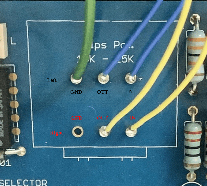

Thanks Salas, can confirm vol. pot wiring correct.

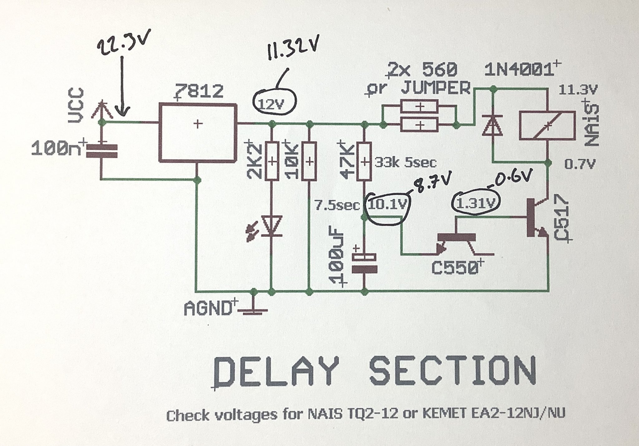

Have just taken the voltages around the delay section. I’m no expert but they look borderline too low to me, pointing towards needing to try a new 12V regulator perhaps?

You do use a BC517 coil driver, right?
I did, yes. But have gone and ordered a new pack of On Semi BC550s and BC517s to replace whatever brands are currently installed, just to make sure. Knowing me I would have ordered exactly what was in the original BOM, so those two parts are probably just fine, but having to take the board out (which is a bit of a pain in my build) I'm going to replace those two as well as the regulator to be thorough.
