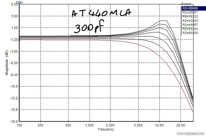

Also note the AT440MLa Audio Technica AT440MLa - ZevAudio Now LD's simulation of this cartridge does not show this dip, based on a simple LRC model.
Other thing I did was look at errors in the Aurak if the load resistor is wrong. This was probably obvious to those versed in the art, but above the turnover point its tracks RIAA perfectly and the error can be viewed as a fixed offset below the turnover point. Worst case in my initial checks using a fixed 150 Ohms was 0.8dB. from 348Hz down. I can live with that as my little room is modal by then so I have bigger issues to sort 🙂.

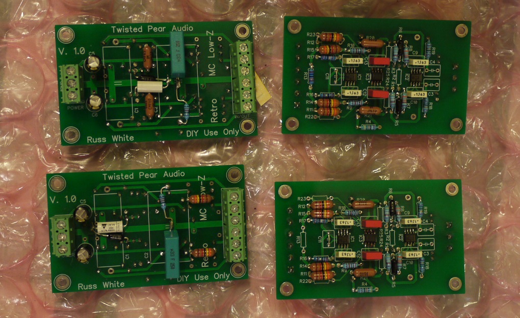

OK soldering is nearly completed and I must write to Russ asking him to open out the IO holes a litte as they were effectively press fit for the power. It's not the prettiest* due to a couple of last night ordering sessions where I picked low tempco r*esistors without checking their girth, but at least everything is matched to a sane level**. Last resistor to fit is the gain resitor (R23 on Hans schematic). Now I have some odd gain requirements as I'll have cartridges from 4mV to 20mV and ADC inputs from 2V to 8V. Would be nice to have 6 switchable gain steps. Looking at the circuit doesn't suggest that an extra 3-6" of wire in that location would have any ill effect, but no direct experient of these devices and wondered if anyone here did?
Now to test!. LD have questions for you on final setup. PM or email best?
*Pics to follow.
** Critical resistors are as close to 0.01% as my test rig would allow. I figured worth seeing if good balance actually does anything.

Pics just to show I have actually been doing some soldering. Need to find my hot glue gun then work out best way to test these with the limited setup currently to hand.
Other than the RIAA and gain modifications the rest goes together quite easily. I think as the number of people who would actually do something as bonkers as this is limited from an assembly point of view we can claim this as doable. I think a PCB for the single ended version would be good. I might challenge myself to do a layout for that sometime.
