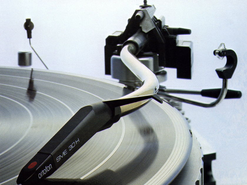

Hi Bill,
Could you run another single wire for ground through the arm? They must have grounded the arm at the pivot end, so that shouldn't need work.
-Chris
-Chris
The SIII has the connector at the pivot end not trivial to add a wire. I need to check if there is metal to metal contact inside the plastic connector. It is a kooky design.
Hi Bill,
Hopefully you will find something you can ground a wire to and simply run another to the headshell. This would allow you to remain fully balanced.
-Chris
-Chris
Hi Bill,
Yuck, that one looks near impossible!
I have one thing to say to you on this. You did buy it. 🙂
-Chris
-Chris
I wanted this. It's close to the ultimate low mass high compliance combination that the late 70s produced. Total effective mass 4.5g. Wonderful pointless madness. It does look nice tho.
Also in my research (although no intention to buy another cart at the moment) I found the technics EPC-205II L. This is a low inductance version made 73-76 and has the somewhat incredulous spec of 40mH and 30R for the coil. So 2L-R works. This could be a candidate for the lowest noise MM front end using a transamp. two tens of a gnatfart improvement is pointless, but fun to find the limit 🙂
