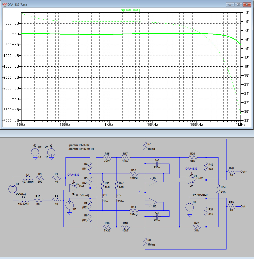

Do you want the balanced Aurak be adapted for a 200mH / 800 Ohm cart ?
And what about the flat Wayne amp. Are you planning to use a capacifier that is reducing the Cart's output to MC level first ?
In that case using the Aurak in combination would be a total mismatch.

Regarding any changes to the Aurak for my B&O mmc2? I think I would have to change too many components, but I am curious. 🙂 BTW it measures 215mH and 780ohm
You only have to change two resistors in the Aurak amp to get Rext = (4xLcart-Rcart), simple as that.

So for the TP Aurak, my b&o mmc2 4*(215) -780R = 80R. For balanced wiring that would be two 40R per channel. No other changes needed for TP Aurak circuit?
Sorry, but what is a TP Aurak ?
What are the two MM that you are planning to use, Lcart and Rcart.
If not to far apart, you built your Aurak version and al that has to be changed are the two resistors in series with the cart when changing Carts.
Hans

Thanks, the other cart I have is the Grace F8-Custom, it measures 435mH and 520ohm so it is suitable for standard Aurak circuit. When I mention TP I mean your Aurak based on the Twisted Pear boards, Bill and I currently have those built.
Here is your version for the Balanced Aurak.
With the B&O Cart use 2*40 Ohm and for the Grace 2*610 Ohm or (2*570 +2*40).
