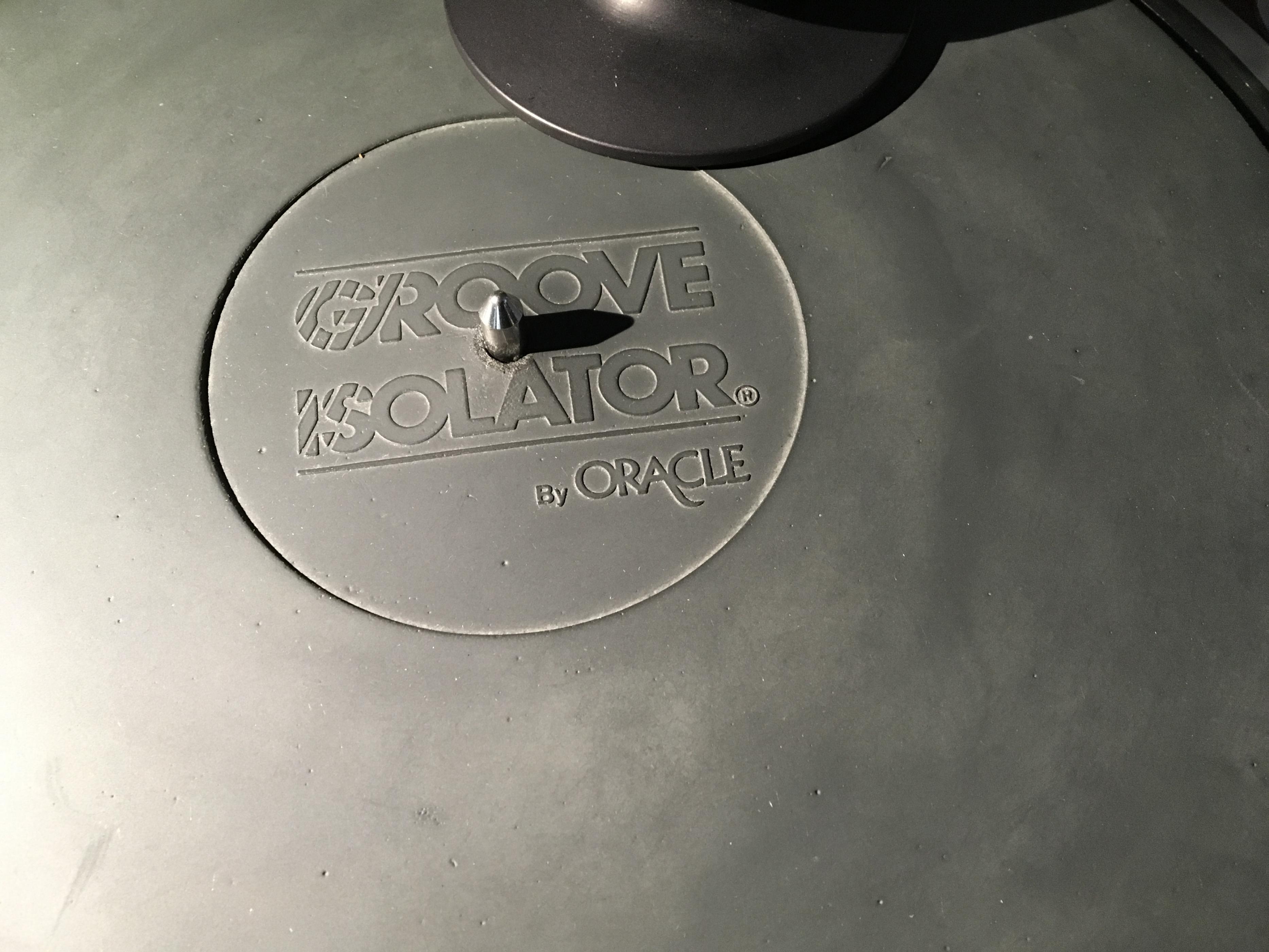

Hi David,
Thanks! The Platter Matter used to be tacky and stick to the record as well. Now that they are old, they aren't tacky anymore.
Does that Oracle mat have a part number or any other identifier? I need to replace the non-sticky Platter Matters. They are still very dead and tend to damp vibration in their current state, so they are a lot better than the stock mat, or any of the felt or cork mats.

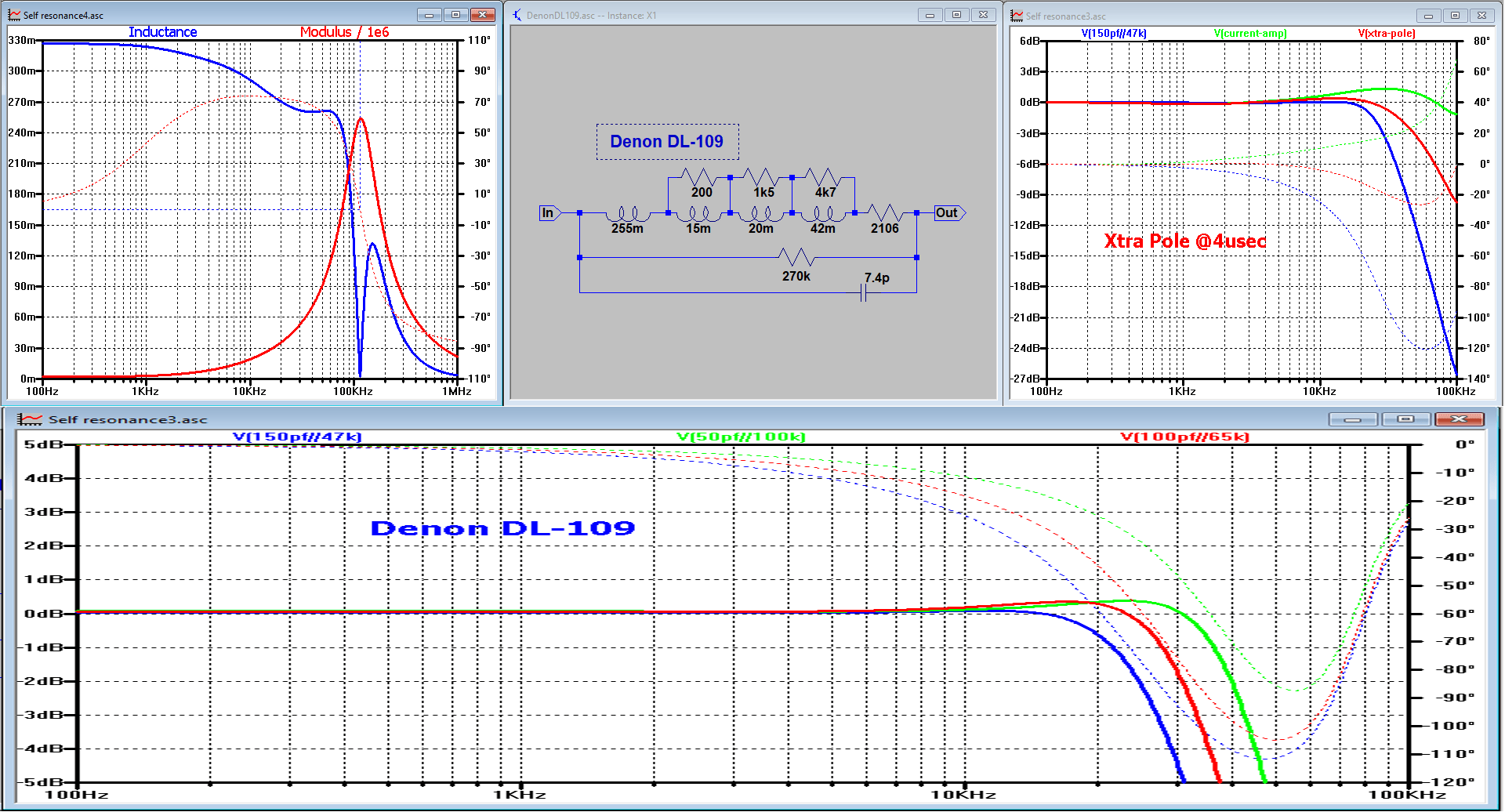

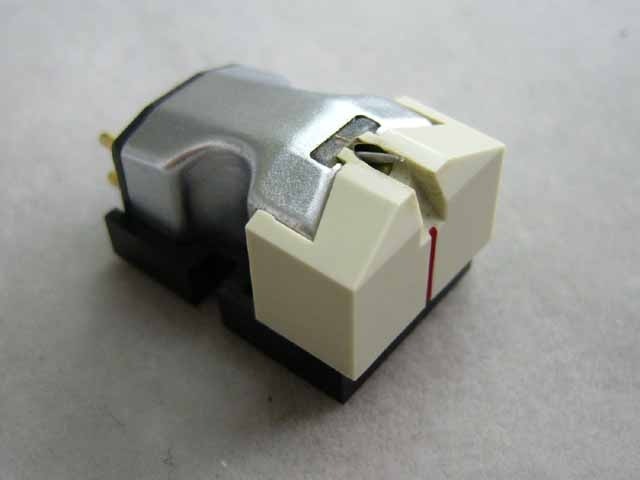

First up is the denon DL-109 a marvellous oddity from the golden era of wierd cartridges together with the equivalent model Hans produced. As you can see the electrical model predicts that the 'normal load' of 47K||150pF should be rolled off under 1dB by 20kHz.

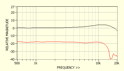

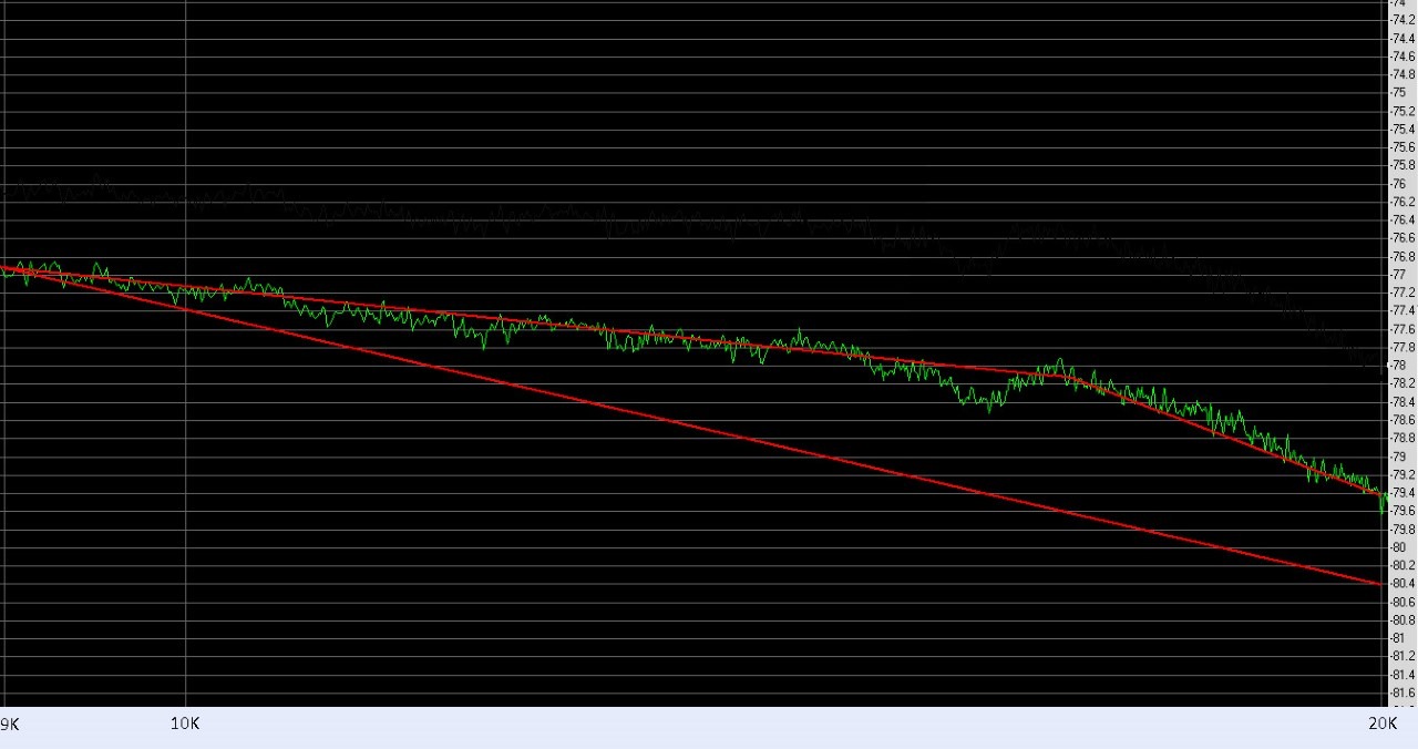

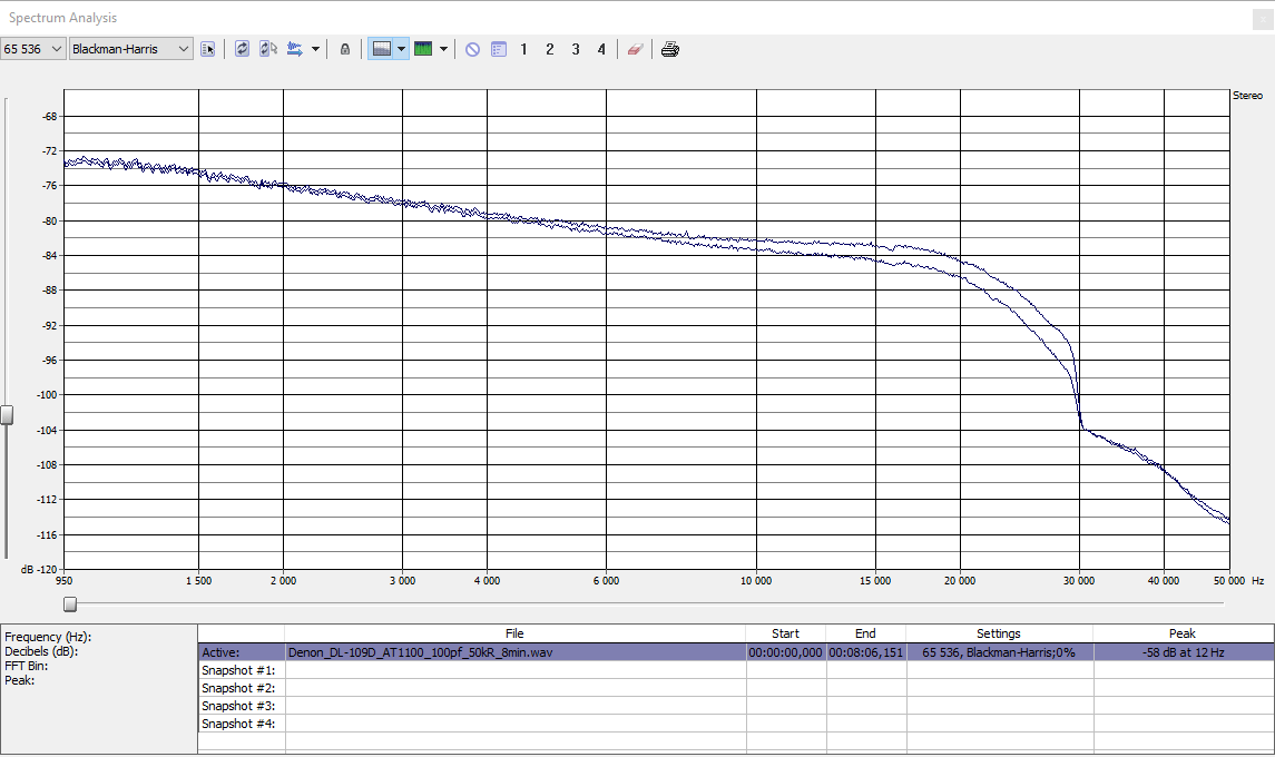

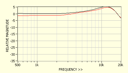

On to the testing. Now we have managed to get hold of A CH Precision pink noise test record, don't ask me how as I don't know! This is a very accurate pink noise cut so should give us a basis to see what the real FR is without worrying about test record artifacts. First image shows the full 1KHz up sweep and you can see that, up to 9kHz we have a straight line (note not a flat line as it's pink noise), above there some deviations. Second image shows that deviation zoomed in. The lower line is the expected for pink noise and the upper is the actual response.

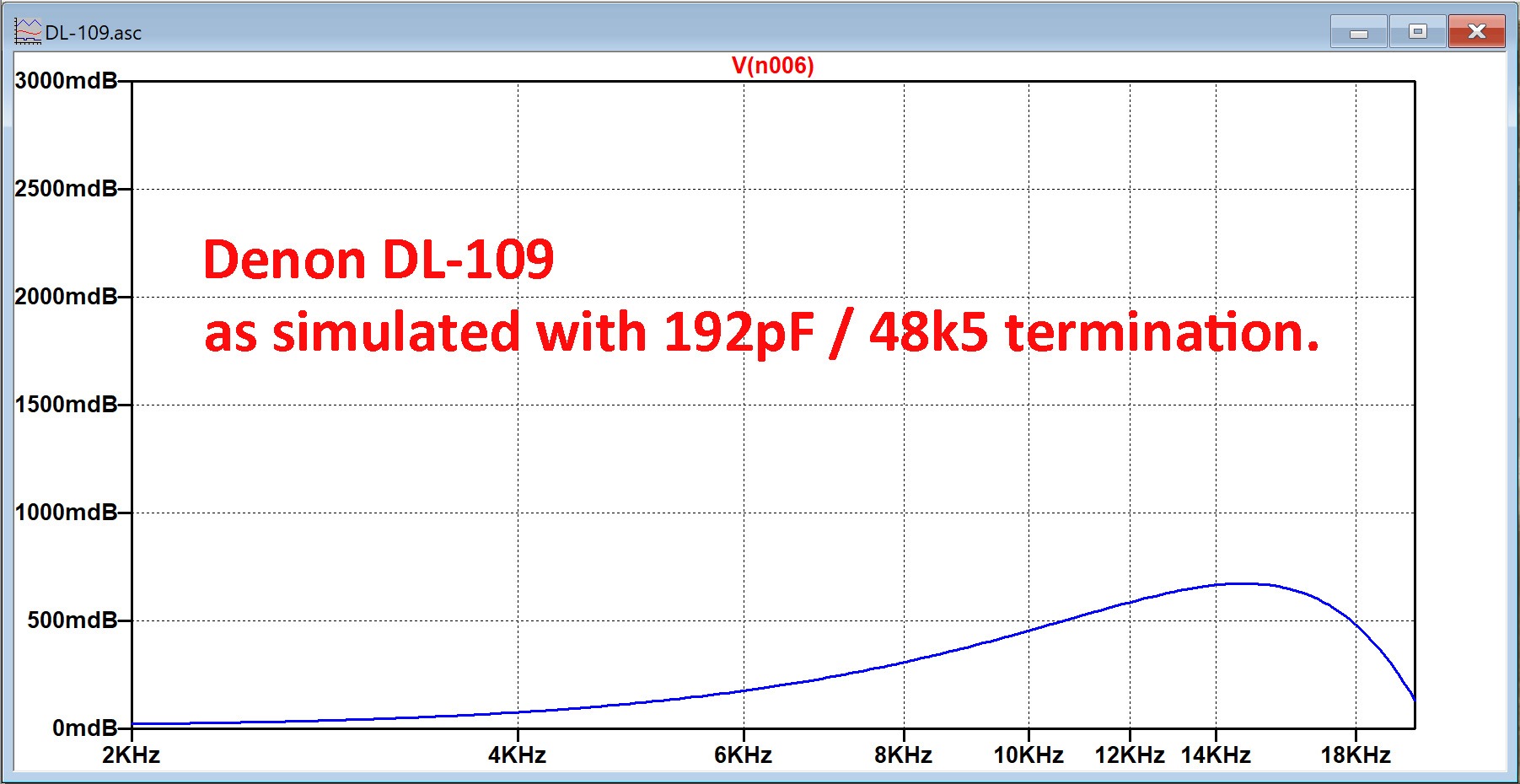

One more thing is needed to test the model, which is an accurate measurement of total capacitance in the input resistance of the phono stage. That was done and 192pF||48k5 measured. This was plugged into the simulator with the equivalent model of the generator and the 3rd plot generated. This is within 1dB of the measurement, which for vinyl is pretty good going. tweaking the loading a little bit could flatten that out nicely. But does appear that there is no need and no evidence of mechanical resonances being bought into play to flatten out the response. Next up something people may have actually heard of...
BTW would like to hear from people who disagree with these measurements as always good to defend results.

Billshurv, intersting work here. Would appreciate clarification on the modulation of the test disc. Is is horizontal, vertical or 45/45 stereo? Also what is the groove velocity, 5 cm/s peak?
Do you have access to stereo test disc, e.g. CBS, with slow sine sweeps? Vinyl compliance - stylus effective tip mass mechanical resonances clearly show up in the crosstalk.
Let me check and get back to you on the details of the sweep.
So far we have avoided 'std' test records as enough questions have been raised to suggest that they might not all be as accurate as thought. I have a side project to try and work out if cal files for popular test disks could be made to give a more level playing field.
I should note that I don't believe in vinyl compliance being a thing and do find the cantilever transmission line model to be more credible, even though I can't yet prove it. The stylus is rattling around in the grove being barely stable most of the time for sure and certain frequencies will cause more problems. You can see these playing a silent groove but these don't directly contribute to the frequency response.
