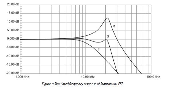

We are not following tried and true practices on purpose here. The whole point of this thread was to question some oft repeated belief that MM cartridges need to have a mechanical resonance to flatten the response. In case you missed it I'll put the graph from Van Raalte's linear audio paper here again (with Kind permission of the publishers). That seems to be an accepted view by many. I and some others think this is wrong so we proposed to test it. I mean why would a MM need this if a MC doesn't. Makes zero sense. I've looked at enough of Paul Miller's data to feel there are issues with his test methodology as he follows the same path everyone else has.
We are trying something different, which goes against perceived wisdom for a reason. What if they've been wrong for the last 50+ years? Won't win any awards, but would be fun to see if we could get some good evidence. I'm cool with people thinking I am a deluded fool tilting at windmills. I have been called much worse by people, even the kids 😀

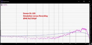

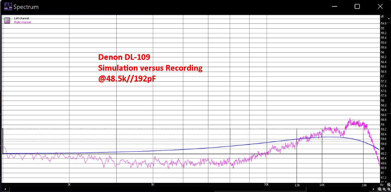

Trawling through the data so far we have found one oddity which is the DL-109

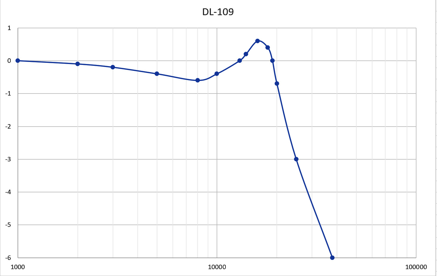

This is the pink noise response rotated to flat to make it easier for human eyes and the simulated response plotted over the top. Extracting the deviation from simulated we get
Now this looks very like a cantilever resonance, which is what we have been seeking, but the +/-0.5dB is far less than one might expect from a resonant peak. Next step will be to change the loading to flatten the electrical response out and see if this moves with it or changes. The DL-107 with a higher tip mass does not seem to show this, so I think I need to roll out some bonded tip stylii for additional tests.

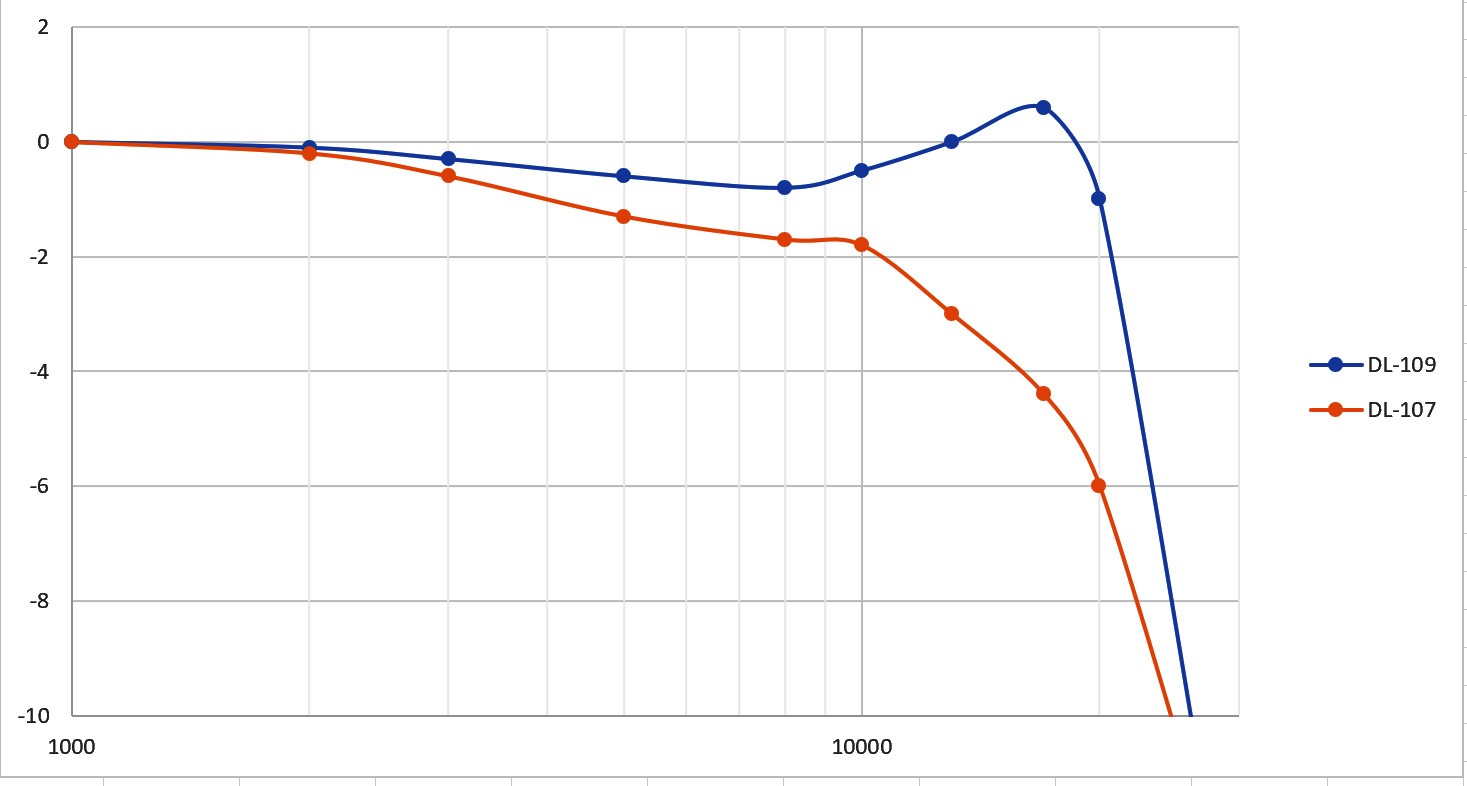

Interesting graph comparing simulation vs measurement for the Denon DL-107 and 109. now the 107 was a late 60s vintage radio DJ cartridge. Fairly robust cantilever and big diamond. The difference should give us the frequency response of the moving parts, with a few fudge factors for the conical profile which won't all the way to 20khz. The 107 shows none of the mechanical peak that the 109 appears to have and just rolls off after 10kHz.
