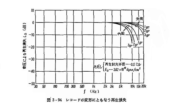

Here is a frequency chart of a cartridge with an 0.5mil stylus, showing how the frequency characteristics are affected by tracking force and by the inner vs. outer grooves.
The upper three lines marked 1gr (grams), 2gr and 3gr are for the outer grooves. The lower three lines marked 1gr, 2gr and 3gr are for the inner grooves.

JCarr: I suppose that graph leads to a questions
1. what is the mechanism for this. In particular why does high VTF increase HF loss, that doesn't immediately make sense.
2. Is this corrected for in mastering (in which case which is the correct profile for a cartridge)

The most obvious cause of HF loss at 3G is increased contact pressure spreading contact horizontally. This could either be due to vertical contact not actually being vertical, or due to the stylus radius
If the contact with the vinyl has a finite horizontal width, it will reduce output from tracing a high frequency sinewave cut, a bit like the sin(x)/x of digital

Hmmm...... except we all know the f response of real vinyl playback versus VTF doesn't meaningfully vary, over a wide range......... and certainly not on the scale portrayed there.Here is a frequency chart of a cartridge with an 0.5mil stylus, showing how the frequency characteristics are affected by tracking force and by the inner vs. outer grooves.

Trying to piece together what the graph might mean, there seems to be a reference to Young's modulus Eo and a value stated. Just a guess, but perhaps this is some form of lab indentation test, that would show (as expected) relative indentation reduces with increases in frequency and VTF ?
The Y axis is in dB, so has to be a ratio.... I guess indentation amplitude at frequency f divided by static indentation ?
What such a test should show is that the elastic properties of vinyl are time domain dependant, being an elastomer. So, for a given amplitude and force, vinyl gets stiffer with increasing frequency.
As to real vinyl playback, even in an unmodulated groove, a stylus traverses its own contact length along the groove wall perhaps 250,000 times per second. Or, from indentation of the groove wall perspective, each point on the groove wall is exposed once to a very short pulse of force for few µS. If that were repetitive (which it isn't from vinyl wall point of view), a representative frequency would be about 250kHz. At which frequencies vinyl is effectively rigid, and I think that might be what this graph eludes to.
