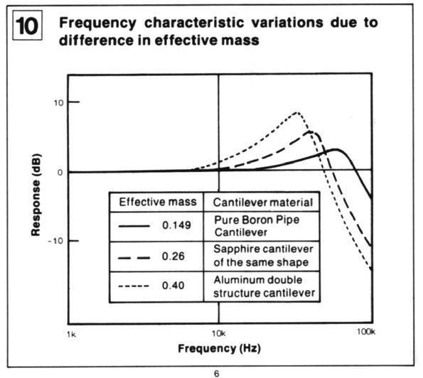

I've also been mulling over some of the snippets of information that need testing, in particular if the ultra-light moving mass cartridges really are flat as far up as was claimed. I'll have to score an ortofon test record with its 800-50kHz sweep. I'll be able to compare my Benz MC with the ortofon and AT150 but sadly looking around on ebay the hollow Boron models are rare as hens teeth. If anyone knows anyone who has an EPC-205Mk3 that needs a retip they would be willing to part with for not silly money let me know as would love to see how that performs at HF. Pic below is from the manual for that cartridge which has an interesting marketing graph.
Now of course being a marketing graph it's missing usable log scales, but with the power of paint you can see the peaks are at 45KHz, 60KHz and 85KHz. This is around double that originally predicted earlier in this thread by a transmission line model but given Technics were kings of ultralow effective mass I am happy to consider that they were considering about half the mass of current production solutions. Something to ponder. I've also headed down a rabbit hole on stylus profiles, but I think that warrants a new thread,which I am planning. Not sure I will get to the bottom of why many people prefer the OM30 over the OM40 but we can try🙂
