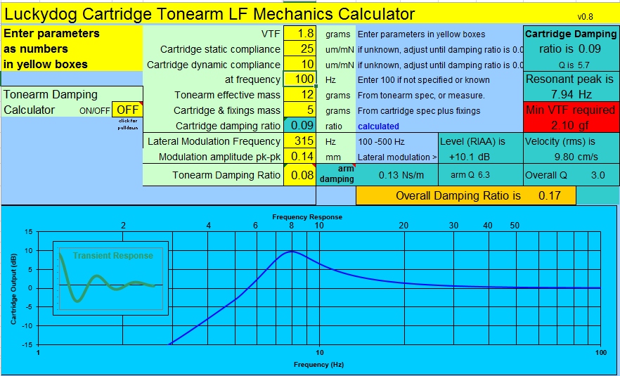

Here's 2p worth as to cart-arm resonant system and damping.
The system is continuous and not-symmetrical in 2D. So, in reality, restoring headshell motion in response to a displacement typically typically describes a lissajous curve in 2D as it settles. The vector for much initial headshell displacement is typically more vertical than lateral, partly because many causes send the stylus upward (it isn't free laterally).
However, stylus-groove friction, or variation in it, is typically the largest cause of displacement other than eccentricity/warp, and acts by instantaneous variation of skate force to displace the headshell.
IIRC you have a linear tracking arm, Hans, so only vertical vector of stylus-groove friction is at issue, applied via the 20 deg or so cantilever VTA, and perhaps this might be an explanation ?
More generally, the enemy is displacement of the headshell from a perfect locus following the groove. And the principle audible effect is pitch modulation (FM) of programme material due to stylus scrape. So the issue of choosing a 'resonant frequency' such as nominally 10Hz is not as important as the Q which is set by damping, and the settle time which follows on from it.
A few years back I wrote a low frequency mechanics predictor called 'loafer', which pulled together the many and various parameters from cartridge and arm, and attempted to predict required VTF for trackability and settle time. Attached is a screenshot for a typical cart/arm combination.
Most cart/arm combinations are sub-optimally damped IMO and would benefit from extra arm or brush damping. Loafer helps calculate how much damping to apply in terms of torque at the headshell.

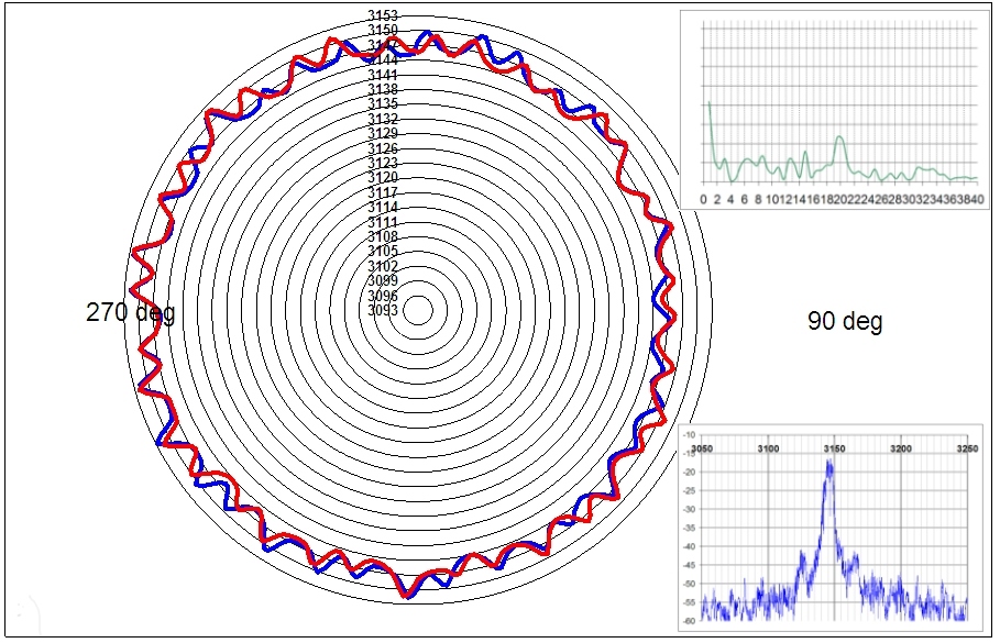

Also attached is a plot which looks at pitch stability in an interesting and very human way. Once around the plot is one revolution of the platter. Radius is 'instantaneous' pitch of a 3150Hz test tone, measured by accurate and low noise FFT with a bandwidth of about 50Hz. The plot shown is for a cart/arm with a resonance at c 20Hz, and fairly normal Q. Inset is a conventional B&K style spectrum plot, and also the FFT spectrum of the pitch modulation. One radial line is meant to represent the threshold of audibility of pitch modulation.
I think collectively this illustrates what is important about the cart-arm resonant system: pitch stability which is linked to Q.
LD
A few further points of explanation about the plot.
Red and Blue plots are successive rotations of the platter. This is handy to separate pitch variation which arises once per rotation, such as eccentricity/warp, from pitch variation that arises from non-synchronous causes such as pseudo-random headshell motion.
What one finds, from looking at a reasonable number of these plots, is that spindle motor/drive speed variation is typically very small compared to eccentricity/warp and headshell induced FM pitch variation. For all reasonable turntables, and unless there is a fault.
I collected 3rd party samples of 3150Hz or 3000Hz test tones, from most of the best reputed and highly regarded TTs. Conclusion was clear, and perhaps surprising: it is far more productive to invest in headshell stability rather than platter speed stability, unless there is a fault. So addressing tonearm damping is far more useful for improving audible pitch stability than addressing motor speed variation. Cartridge choice, surprisingly, can be a big factor IME.
If anyone is interested in analysis of their rig this way, please post a short recording of a 3150Hz or 3000Hz test tone. About 10s, and any lossless format and any level that doesn't clip is fine. I don't mind doing a few every now and then.

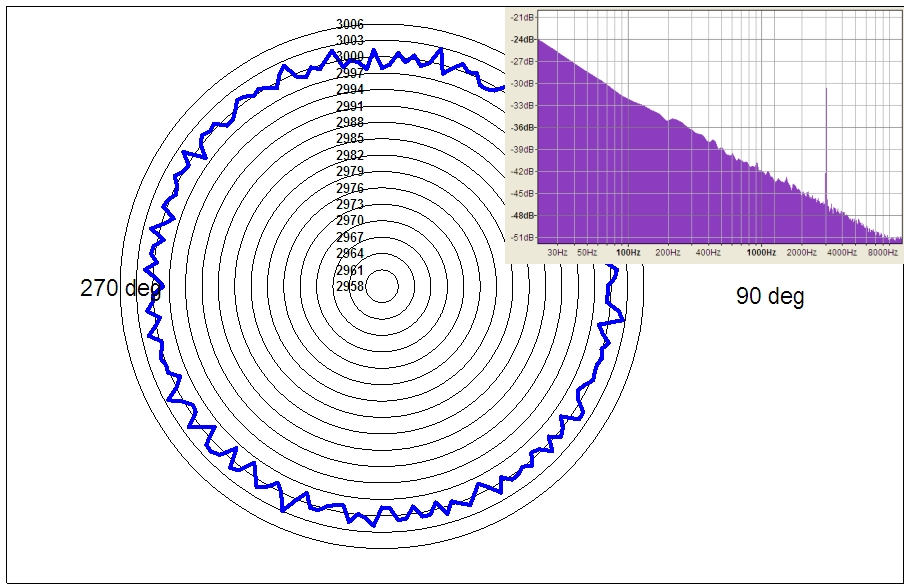

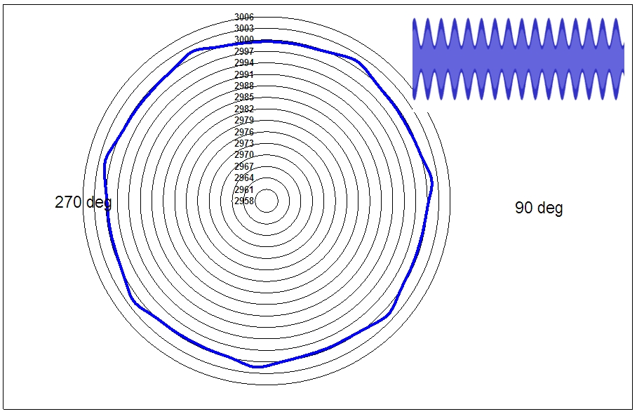

Meantime, here's some pretty calibration plots, one of which I used as an avatar a few years back.
LD
