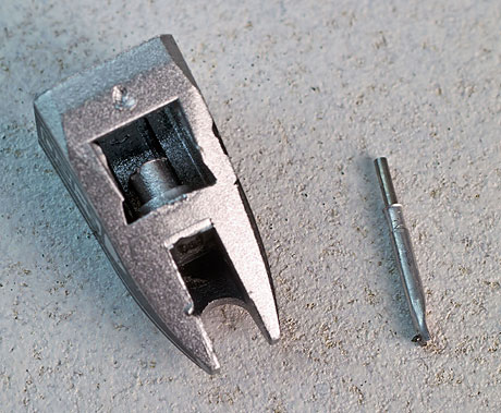

from tear downs I have seen there is not a tie wire. But I may have to sacrifice one for science to confirm.
One interesting snipped I found out last night is that the DJ cantilevers as shown above are not a single tube, but in fact two concentric tubes to give added studlyness. This should make is supremely stiff, but sadly also somewhat massive.
AFAIK the S-120 doesn't do that: rather it's a fat tube, which is the best way to use a mass budget for max rigidity, in a given material.One interesting snipped I found out last night is that the DJ cantilevers as shown above are not a single tube, but in fact two concentric tubes to give added studlyness. This should make is supremely stiff, but sadly also somewhat massive.
There is also an argument that the last thing one wants is a rigid cantilever, because then the moving mass is the whole cantilever, rather than the end section that bends....... And suddenly we're back to mechanical transmission lines, providing a low impedance connection at the stylus end, to the high impedance mass of the generator.
IME, extreme hf trackability of the S-120 is very good, but can be outdone by some cantilevers which on the face of it are less rigid. But then, they also have different profile styli with perhaps better polish/finish? Though the S-120 looks good microscopically IME, it is bonded.
IIRC there's a slight uplift at 18-20kHz when an S-120 used with Aurak, which perhaps suggests that's the mechanical resonance is c 20kHz ??
