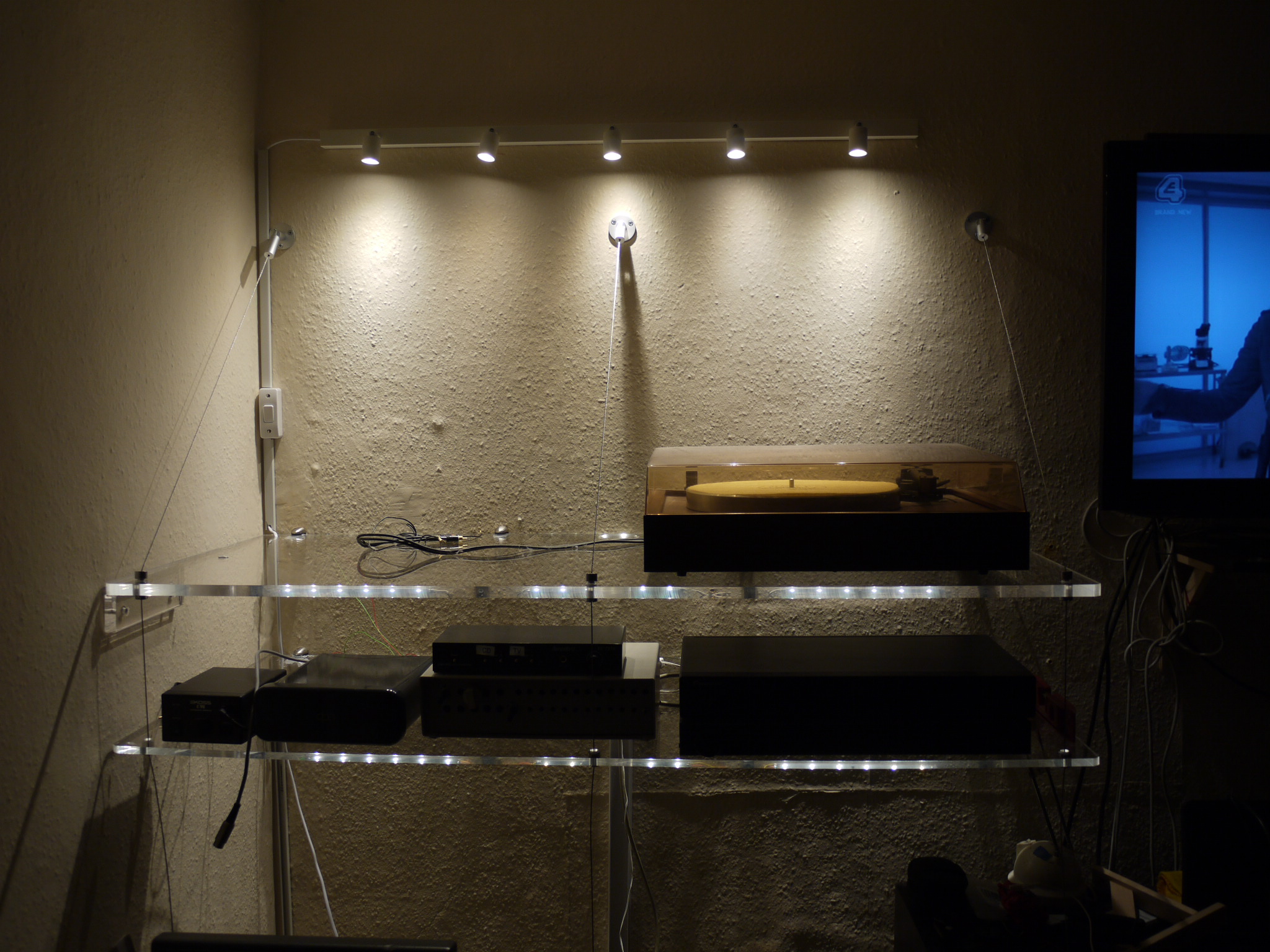

My stereo is almost back together. Sadly the Roksan has thrown its usual wobbly when moved but forward progress 🙂. Oh and wife is happy.
Still much to do, but at least I can access things now which has been impossible last 2 years.
