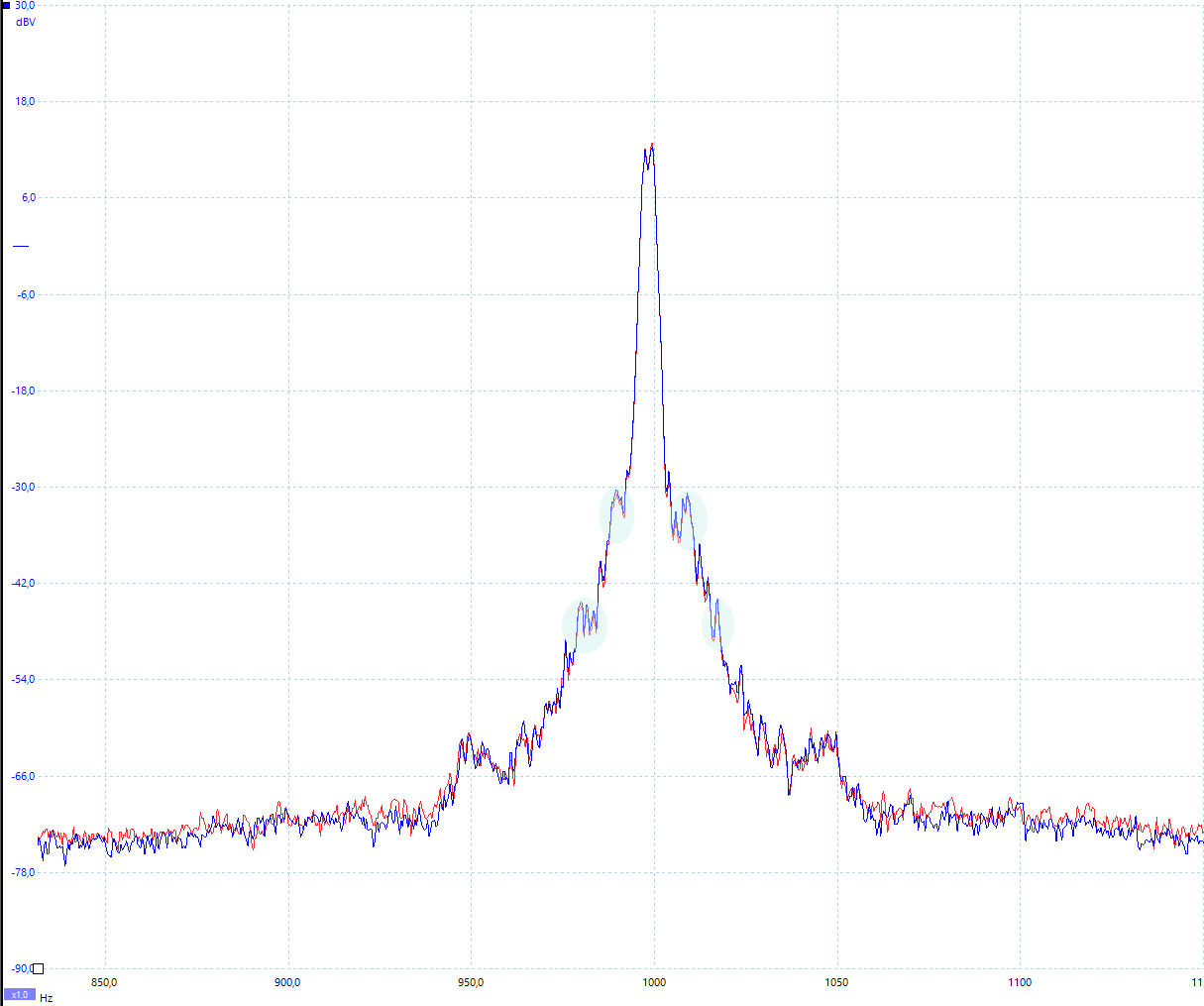

Bill,
Cart/arm res. frequency Fr should always be somewhere around 10Hz.
So a low Cu Cart needs a heavier arm and vice versa.
Fr is causing IM distortion as can be seen in the image below where a 1Khz tone is playing. You can see 1Khz +/- Fr, +/- 2Fr etc.
Damping can reduce the Q of Fr, resulting in less IM distortion.

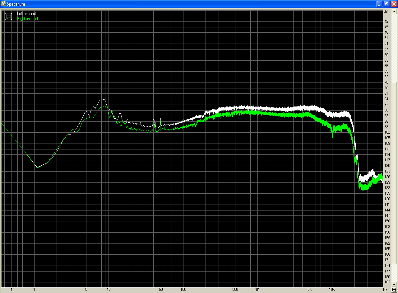

With my arm Fr vert is much better damped as Fr hor, causing the IM products produced by a horizontally cut 1Khz test tone to be clearly visible (#724).
Could it be that in general most of the needle movement is in the horizontal plane, but that noise (from a blank track) is only in vertical direction ?
That would explain why I hardly see any resonance in the noise spectrum, but when playing infrasonic tones horizontal resonance is clearly visible.
Hans

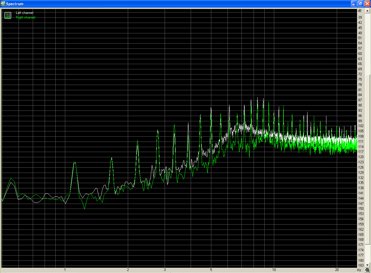

Hans, this may help.
Compilation (same cart/arm/TT/flat preamplifier)
White trace: Pink noise lateral . (test track: UAT S2 T2)
Green trace: Pink noise vertical . (test track: UAT S2 T3)
First FFT:262144 points
Second FFT: 8388608 points
George

George,
It is perfectly possible to produce the mono signals in hor and in vert direction like you are showing, no doubt about that, although in the last case the signals from the Cart have opposite direction and cannot be used for producing mono music.
So the mono component in music means lateral movement, and stereo information is a mix of lateral + vertical movement.
And since the Cart's poles are positioned under 45 degrees, a mono signal having to produce the same audio volume as a pure L or R stereo signal, needs twice the horizontal displacement on the LP.
That's why I expect much more energy content in the horizontal plane.
That could have been the road that Townshend has followed, but again, maybe LD can shed some light on this.
