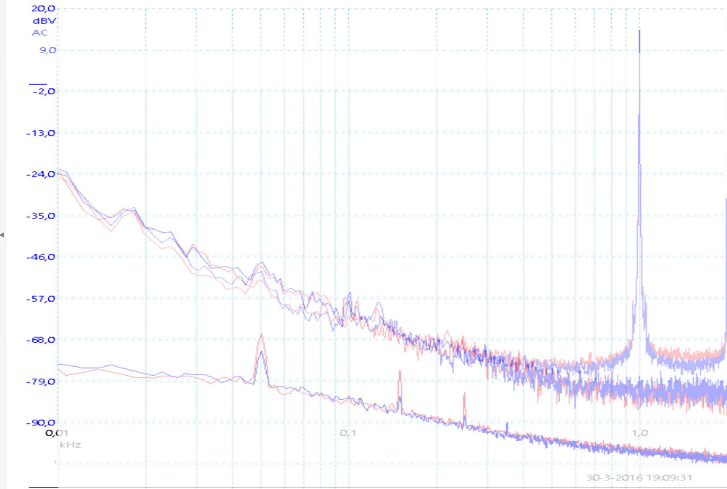

Aiming for preamps with 0.2nV/rtHz is a fantastic technical achievement, but is totally useless, 75dBA is more than enough.
Looking at the picture below, recorded with an MC element and a 75dBA preamp, you see going from bottom to top @ 1Khz, 1) noise with rotating platter, but arm in the air, 2) Surface noise from blank groove on LP and 3) spectrum while playing a 0dB 1Khz test tone.
Recording was made after Riaa, without A-weighting and with fixed width FFT filters.
As you can see, noise from 1) lies everywhere at least 15dB below the surface noise. Less noise from a preamp doesn't make sense.
Hans
Thank you, Hans.You are a right that just looking at preamp noise figures has it's limits.
Hans

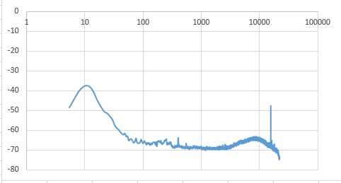

Here's a 'RIAA off' spectrum plot of one of my silent groove archive recordings. MM/MI with conventional 47k/C loading.
I think this suggests dominant noise contribution in Hans' plot over the 2 decades he plotted might be baseband residue from the c 10Hz main cart-arm resonance.......?
Otherwise, I think the surface noise in this recording, as measured at the cartridge output without RIAA, is fairly white. ie stylus velocity noise seems fairly white. It also has what looks like some sort of c10kHz hf noise elevation, perhaps a resonant system perhaps the LCR or even mechanical - I don't know the cart details but it would have been conventional 47k/C MM/MI loading from the time?
There's a spike at exactly 15625Hz, which is ye olde UK TV line frequency from the days of CRT television, which I assume to be on the vinyl mastering, 'cos I didn't have an old tv at the time !?!
LD
LD
LD,Here's a 'RIAA off' spectrum plot of one of my silent groove archive recordings. MM/MI with conventional 47k/C loading.
LD

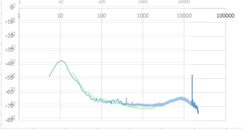

To be honest, I do not see that much difference between your plot and mine. No more than a few insignificant dB's deviation from each other.
I have projected both on top of each other, after having adjusted the hor. and vert. scale to be exactly the same for both images.
Hans
Yes, I agree, Hans. The two results are supportive.LD,

I think perhaps the dominant shape over the 1st two decades might be due to residue of the cart-arm resonant system at c 10Hz?
LD

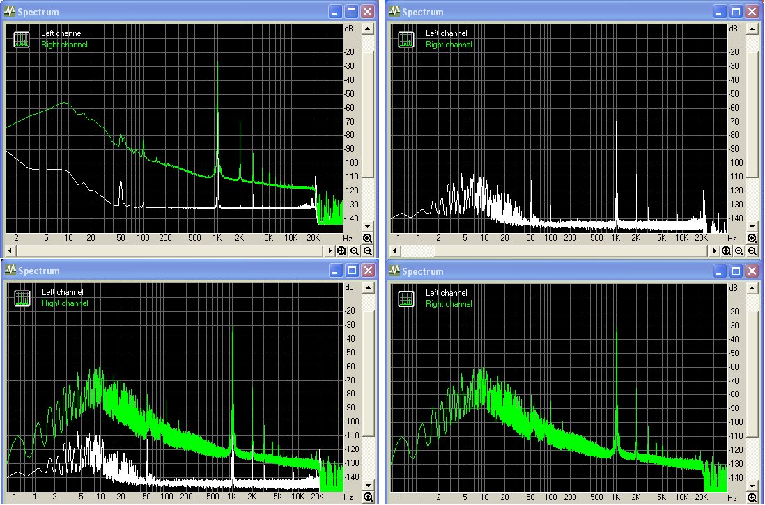

In high resolution FFT we see the arm/cart resonance around 10Hz plus a forest of peaks due to eccentricity (peaks every 0.55Hz).
If there was no eccentricity, the upper skirt of the FFT would be around 12-15 dB down at sub frequencies.
Vinyl noise (flat reproduction) is essentially flat above 50Hz
White trace: Flat reproduction of 1KHz lateral @ 7cm/sec test track (2minutes long).
Green trace: Analog RIAA reproduction (Hagerman Bugle) of the same test track.
Upper left FFT : 65536 points.
All the other FFTs: 2097152 points
Shure M97xE on SME 3009 II Improved, Thorens TD160MKII
Test track: Side 1 Track 1 of the "Ultimate Analog Test LP" form "Analog Productions".
George

Interesting observations, showing 1/f noise from 50Hz downwards.
But allow me to have a few comments from my side.
I have the impression that the noise from your A/D is corrupting the images, for two reasons.
1) When the noise above 1Khz would be white, the noise in the green curve would have to drop 20dB from 1Khz to 20Khz.
2) the difference between the white and the green curve should be the difference between Riaa and no Riaa, but isn't.
Since RMAA that you are using does not show absolute levels, it would as a check make sense to have a recording with one channel playing through the flat preamp channel (white) and a the same time the other channel with no LP input (a second Cart connected or a resistor?) Then you have the relative difference between the two, confirming that either the recorded LP noise is significant and really white above 50 Hz or corrupted somewhere by the noise from the recording chain.
- A much lesser point that I question is that above 20Khz the spectra do change so abruptly. In #638 the same effect for a pink noise spectrum was explained by pink noise being band limited, but that cannot be the case here.
And since both white and green spectra above 20Khz are almost the same , it can probably only be your A/D causing this.
Hans

As for the rest, 0dB for my soundcard (thus for the FFT) is 1.286V (edit:Vrms) The track from which the FFT was drawn was 1KHz @7cm/s.
The sudden drop above 20KHz was due to the USB channel bandwidth limitation forcing the card to sample at 48KHz, while the software was recording with 96KHz sampling rate.
George
