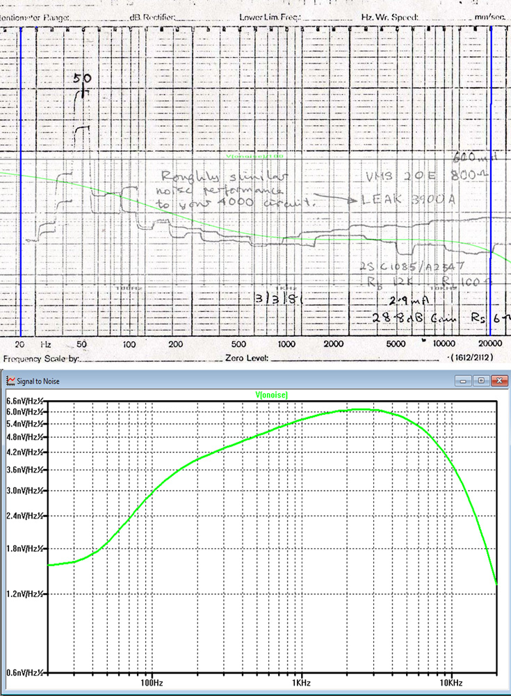

I have projected in green the raw unweighted noise for a 3nV/rtHz / 0.3pA/rtHz amp with a 600 mH / 800 Ohm cart into your B&K plot.The noise plot in #675 looks like it has A weighting applied. The most useful graphical display is the raw noise without weighting.
This is what I show in #662 .. which is plot off a B&K 1/3 8ve filter set.
I can assure you that the audible difference in noise is more than the straight numbers show. 'Whitish' noise as with most MM/MI systems is always more irritating as it is obviously 'artificial'.
Vertical and horizontal scale are exactly adjusted, just as the fact that 50Hz hum on the B&K plot was displayed at 40Hz.
And I have added for the same configuration the A-weighted plot, this time also on a logarithmic Y axis.
Which of the two tells me more ? Of course the A-weighted version, without a doubt.
Hans
Is that done with SY's spreadsheet?I have projected in green the raw unweighted noise for a 3nV/rtHz / 0.3pA/rtHz amp with a 600 mH / 800 Ohm cart into your B&K plot.
It doesn't correspond with real life. Your green line is what I'd expect of a MC cartridge with a SOTA noise preamp. What preamp is assumed?
I'll have to get someone to translate his XLSX spreadsheet into something I can read. 🙂
In the accompanying text I have mentioned 600mH and 800 Ohm Cart, just as in your B&K recording.
And the green line came from LTSpice, calculated with 1/100 steps of an octave, just as in the A-weighted plot below.
Nothing SOTA about the Amp, just an ordinary NE5534.
Or was your B&K noise recording from an LP instead of only showing the noise from Cart + Preamp ?
In that case we are comparing apples to oranges and your B&K plot was not fitting in the discussion we had.
Hans
What termination network? This all becomes moot anyway when you plot the quietest blank groove you can find.
In #694 I plotted linear spectra instead of 1/3 octave bands.
So the B&K plot and my plot are incomparable.
I will redo a new version, now with 1/3 octave bands.
Hans
Hans
I don't get the message. My plot had nothing to do with blank grooves.
It was the noise spectrum of preamp with cartridge connected.
That was what the discussion was about in #675.
And then the B&K plot popped up, where it is unclear to me whether this was recorded while playing a blank groove of a record, or just displayed the noise from preamp with cart connected.
Hans
Here are the noise spectra for a 5534 riaa preamp, but this time not linear but with 1/3 octave filters.
Both the A-weighted and the non weighted spectra are displayed.
This is just the noise from preamp + MM Cart connected, terminated with 47k and 125pF. Cart is 600mH / 800 Ohm.
The A-weighted plot should conform to the noise spectrum we actually hear.
Hans
