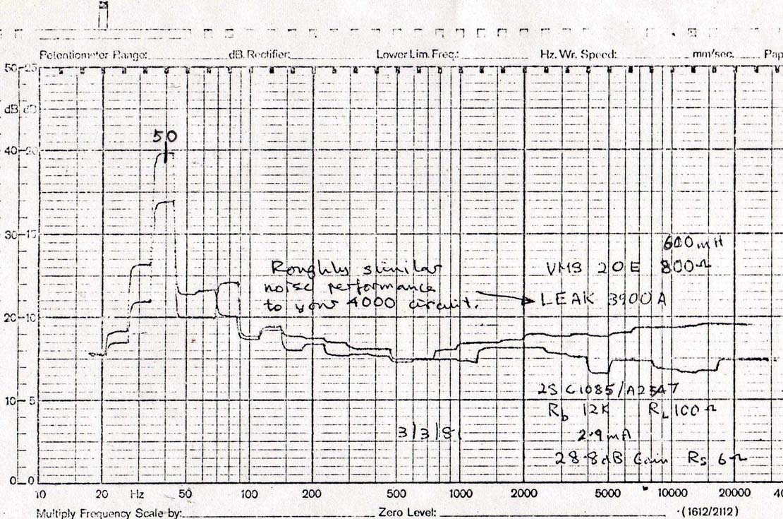

Here's a measurement of noise from Ortofon MC20-II vs VMS20E-II. The B&K 2307 chart recorder has slipped by one tooth so 50Hz hum appears at 40Hz on the trace.
The MC noise is at least 3dB better than the MI on any weighting. The spectrum is nicer too .. MM/MI noise is whitish while MC is pinkish. The preamps is set for very high gain so the noise advantage for the MC is actually even higher.
You can calculate the 'potential' power as V^2/Rdc for a MC.
MM/MI is more complicated cos the Inductance. You have to divide into loadsa frequency bands and at each band transform the series LR parallel C into a parallel L/C/R to get the noise resistance. You then get the 'potential' power in each frequency band. Apply RIAA to taste. You do this even into a virtual earth and you HAVE to take into account the C for noise calculations.
It's exactly the same process as working out the noise of a MM/MI preamp with real cartridge. Guru Wurcer linked to a NS note some time ago describing the details. If you find it download & share please as dem Texans might be trying to erase all trace of NS 😡
If you do this for loadsa cartridges, you'll find the MCs usually have lots more 'potential' power than MM/MI especially in the important 4kHz region. The MM/MI can only get near their 'potential' power (using just Rdc with no fancy calculations) at 1 frequency.
You don't have to realise this 'potential' power to get the potential S/N so this works with either virtual earth or HiZ input amps.
Realising this potential S/N advantage of MCs isn't easy. The preamp in the pic is my 1981 design optimised for very LoZ .. which AFAIK is STILL the lowest noise such beast in the known universe at 0.28nV/rtHz

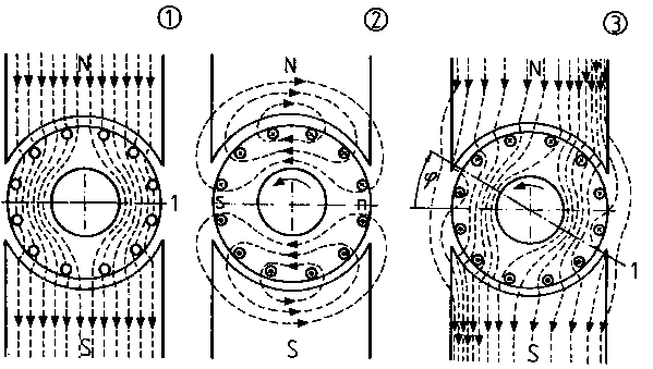

Here's a bit of a quote on Armature Reaction caused by coil current:
"The armature reaction will reduce the generated EMF due to decrease in value of flux per pole. The iron losses in the teeth and pole shoes are determined by the maximum value of flux density at which they work. Due to distortion in main field flux the maximum density at load increases above no load. Thus more iron losses are observed on load than no load."
Also, I attached a little image below showing what goes on in a motor or generator. It shows (1) field due to stator magnet, (2) field due to coil current, and (3) distorted composite field. In particular, the distorted field incrementally shifts the flux and permeability of the stator magnet, introducing nonlinear distortion in field intensity, and that's the field that induces emf into the coil. Then there is the issue of, "more iron losses are observed on load than no load."
Now, of course these issues have primarily been studied in motors and generators, but a phono cartridge seems like some type of little generator.
So somehow, it seems like you are saying the above effects don't occur in phono cartridges, or they are swamped by some other countervailing effects?
EDIT: There is some more description here: https://www.researchgate.net/post/Armature_Reaction_Effect_in_Synchronous_Generator
Thank you, Mark, and also for the links in that web page you posted.
So yes, net flux is reduced by load current, and in principle that can distort the applied field's uniformity leading to distortion.
Thinking further about it: in a cartridge, reduced flux should reduce coil emf, ie increasing load current should reduce coil emf. However, on the face of it this doesn't typically happen with MM/MI carts, such as the result George posted comparing Hagerman preamp conventional loading with Aurak TI: f response for RIAA encoded programme test records in the audioband was much the same.
This could be because load current is typically trivially small cf armature flux changes, so even significant differences don't affect coil core flux nor generated emf? Even in transimpedance loading, MM/MI coil output impedance is not very low in the scheme of things, and that determines load current. As George asks, 'where does the reciprocity break?'
In which case, there would be no significant effect on distortion, through neither distortion of applied field, nor eddy current changes, because net flux would remain much the same.
Interesting, methinks.

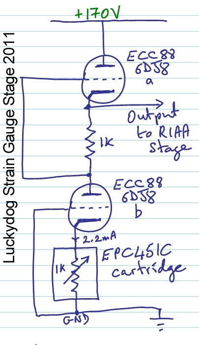

well of course there are strain gauge designs that are position rather than velocity sensitive.
Personally (and I am easily pleased) I think that, between the Cordell/van Raalte loading concepts and TI loading we have a couple of methods for levelling the field between MM and MC which is good. Swinging the eye of Sauron onto MC as well at some point might be a good thing as I have a 6 Ohm ortofon that needs a rebuild. But that should maybe be another thread 🙂.
Yes, like the Panasonic EPC 451 etc. That should expose any mechanical top resonance, but also might have mechanical resonance of it's own in the transducer I suppose.
Seeing Scott's recent minimalist preamp, reminded me of my ultra minimal strain gauge phono preamp, another one from the archive. Complete in one valve (double triode) and one resistor, and ready for RIAA nudges via digital eq........ it works very well 🙂
For the purists, FETs are fine of course !

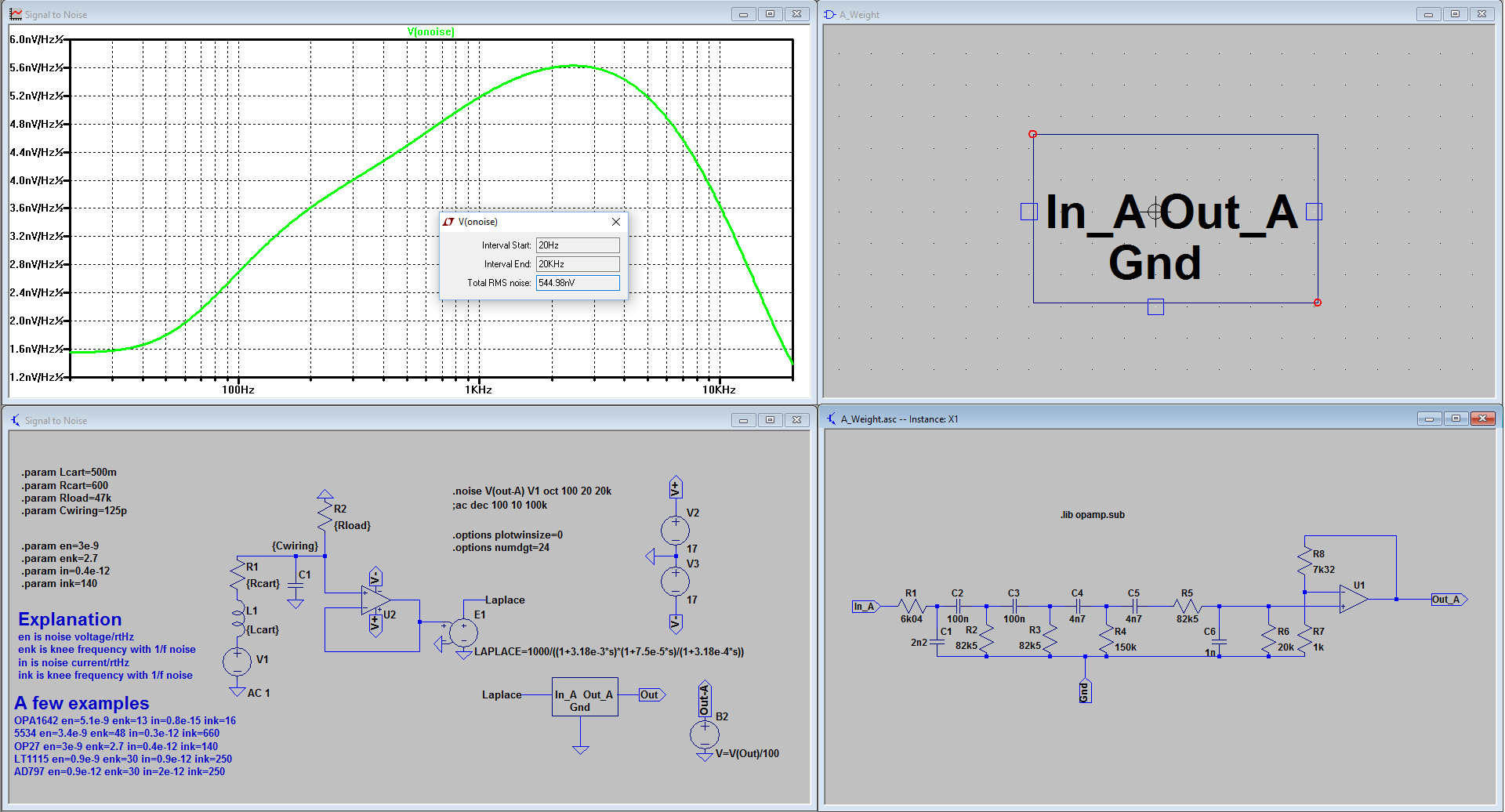

If you go here RIAA Noise Calculator | SYclotron Audio there is a spreadsheet has the NS calculations in a handy dandy auto calculation form.
The noise calculator you refer to, computes S/N without weighting.
However unweighted S/N figures are rather useless because they do not correspond in any way to what we are hearing.
That's why A-weighting or dBA is mostly mentioned for audio equipment when referring to noise figures.
It is possible to build an excel sheet where all important parameters can be entered, which is what I did for MC cartridges.
However using LTspice is much more accurate and versatile because it can easily use very small frequency bands and also include current noise and A-weighting.
LTspice also takes into account the 1/f voltage and 1/f current noise.
The model below can universally be used for MM and MC cartridges.
All parameters can be entered like Lcart, Rcart, Rload and Cwiring.
Parameters for the amp to be used, in this case an OP27, can be entered as En, Enk, In and Ink, explanation is within the model.
After having plotted the A-weighted input noise, move the mouse to the label of the trace, hold down the control key and left mouse click.
What you then see is the accumulated A-weighted input noise from 20Hz to 20Khz, in this case 545nV.
Now with your calculator compute the S/N with the figure provided by LTSpice.
Let's say that for this MM cart, output is 5 mV@1Khz @5cm/sec.
S/N is now 20*log(5e-3/545e-9) = 79.3 dBA as the absolute maximum achievable S/N.
Simple, quick and accurate.
Change the OP27 for the very low voltage noise AD797 and maximum achievable S/N will be 71.3 dBA.
Take a complete noisefree amp and maximum achievable S/N will be 81.0 dBA.
The above figures are computed with the Cart connected.
Usual figures provided by phono preamp manufacturers are with shorted inputs and are of course much better, but a bit misleading.
(P.S. En for the AD797 in the example list must of course be 0.9e-9 instead of 0.9e-12)

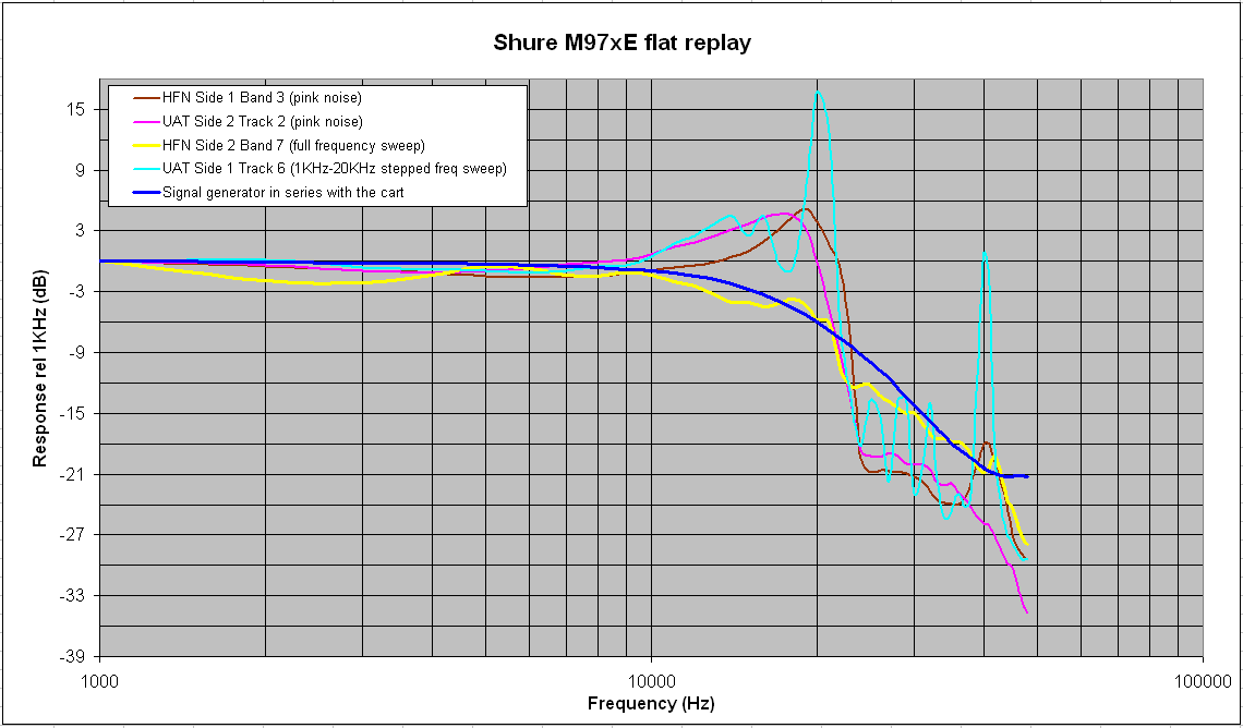

Remember post #613 ? http://www.diyaudio.com/forums/analogue-source/303389-mechanical-resonance-mms-62.html#post5051795
Same 24/96Krecordings, flat amplification, this time I did 128 points FFT, so the traces were very smooth. I read the data at 47 frequency points 1KHz to 48KHz and made the diagram you see below.
Nothing special but I made it for to compare the cartridge when reading the test tracks (mechanical, magnetic and electrical circuit frequency response) and the cartridge on air when excited by the 50 Ohm signal generator (electrical circuit frequency response).
On test recordings, anything above 20KHz consists of harmonics (for the most part they are engraved on the grooves, for the lesser part they are due to playback cartridge).
Soft band limiting on HFN frequency sweep track (yellow trace) and hard band limiting on all other tracks.
Cartridge loading when reading tracks :47Kohms// 150pF
Cartridge loading when driven by the 50 Ohm signal generator :47Kohms// 220pF
