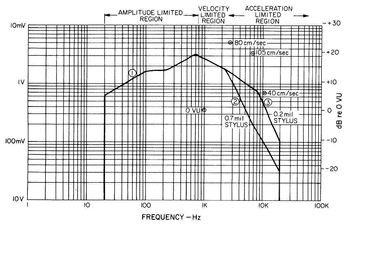

It's very probable that vinyl playback can have level and slew rate sensitive eq, and separately phase, 'correction' requirements. Strictly.......
Err.rh! This pic is from Holman's 1977 re-packaging of the SHURE data. It shows vinyl playback has HUGE slew and level dependencies including response, phase, THD bla bla ... AT LEAST 20dB above any electrical stuff including the cartridge core. Remove RIAA EQ to your taste but the picture doesn't really change.
I'm not sure agonising over purely electrical parameters is productive ... except for making sure you get sorta flat frequency response.
