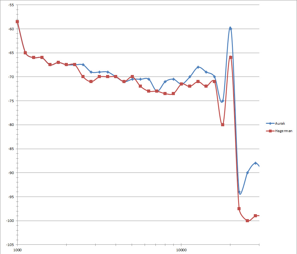

Thank you George. I think the dominant characteristic is the sloping hf loss, which AFAIK is typical of the M97e. See these measurements which confirm, and contrast them to, say, an Ortofon 2M Blue which generator is apparently non-lossy in the audioband IME Cartridge testsPlaying test records
Aurak V3 (OPA2134, NE5532)
vs
Hagerman Bugle (3xOPA2134)
SHURE M97xE on Kenwood KD-3100 with a typical S tonearm.

So it seems, for better or worse, you have chosen a M97e cartridge with an intrinsically lossy generator, perhaps, or at least a characteristically sloping f response. Which, academically I find very interesting as to why it might be so, but isn't necessarily characteristic of all MM/MI carts, especially Ortofons/AT types IME.
Dlaloum on ZevAudio posts measurements of the Shure 1000e/ N97e which is an interesting reference point, in which he attempted to deduce the mechanical resonance of the N97e and shows a plot here https://sites.google.com/site/zevaudio/turt/cartridge-comparison-list/shure-1000e
George, your plots of the Aurak versus Hagerman preamps are interesting, and perhaps hint at Aurak revealing aspects of the mechanical resonance, but the discontinuity at 20kHz I don't understand ?

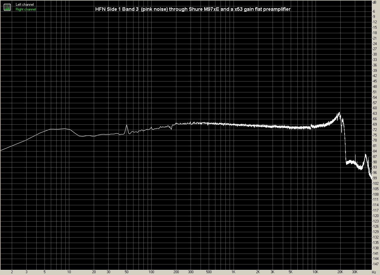

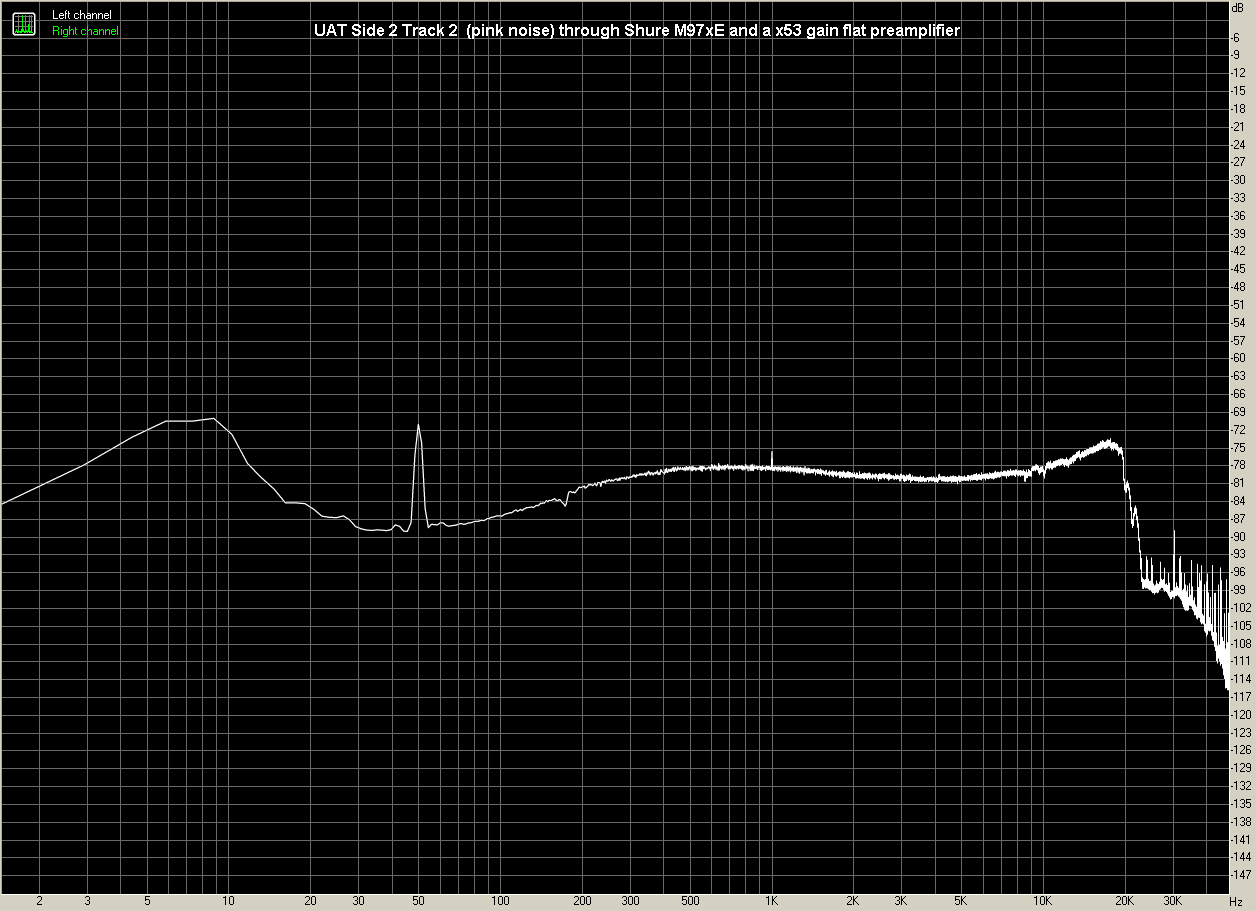

Pink noise means an equal amount of energy in each octave, so when recording this wideband signal with an FFT with a fixed filter width, you will see a 3dB/oct or 10dB/decade downwards slope, which can be seen in your recording from 100Hz to 10Khz.So far so good.

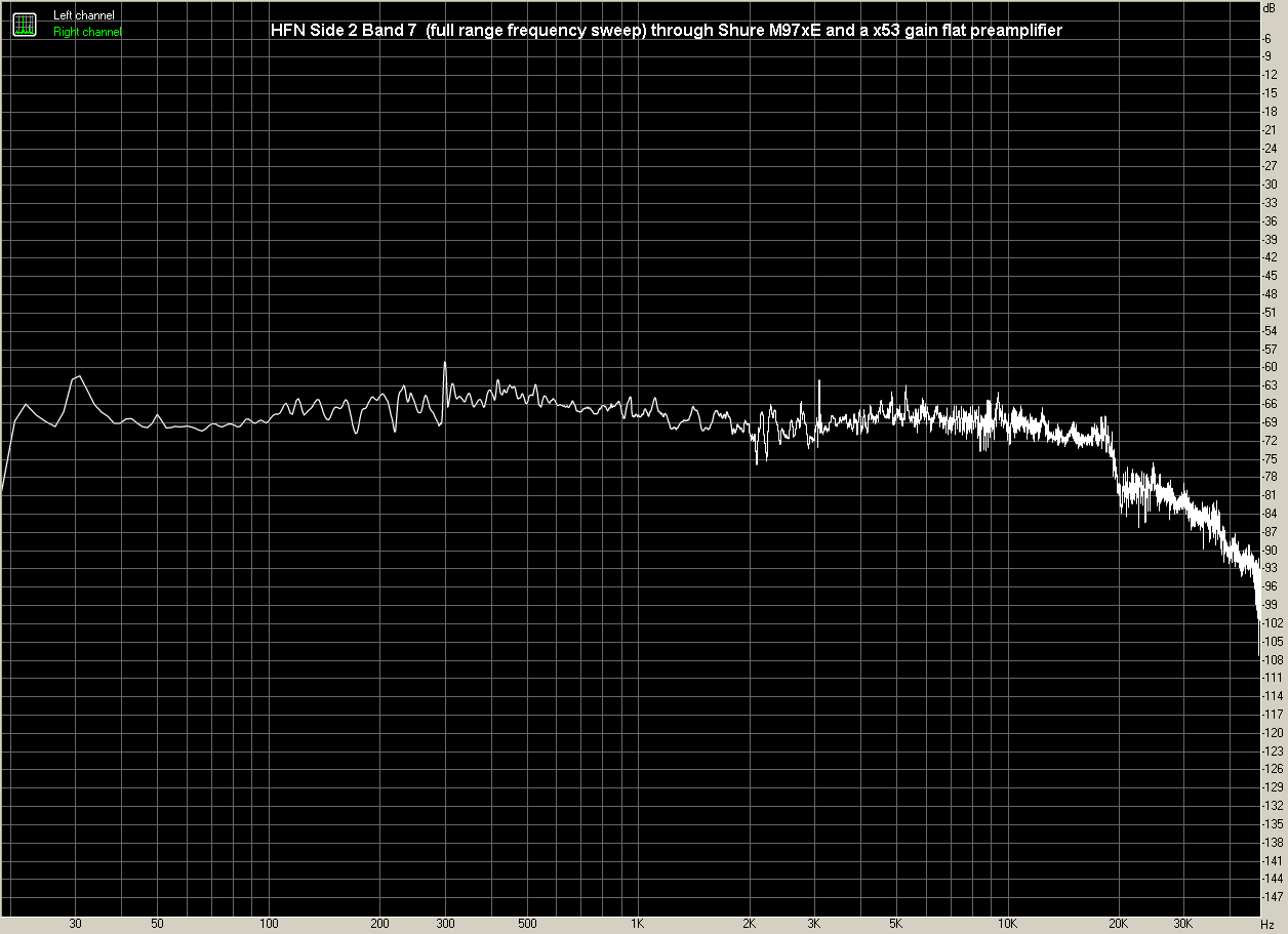

What I do not understand is why the frequency sweep is not flat over a large portion of the FR. And I'm also curious to know how you were able to make this picture.
The stepped frequency image is already much better in showing the FR, but like the pink noise this is probably not a sweep but a continuous signal with all multiples of 1Khz playing at the same time.
Last but not least, I'm puzzled by the fact that the Virtual input Aurak hardly makes a difference to a straightforward 47K/100pF input Phono Amp, at least not in the way I was expecting.

When pink noise shows an almost straight line from 100Hz to 10Khz with a 10dB/decade slope, I have no direct reasons to mistrust the testrecord.
At least from the same 100Hz to 10Khz FR should therefore be flat with a sweep.
But the sweep shows almost 10dB difference between 1Khz and 10Khz, as if it were pink noise too !
I would not suspect the testrecord as the first in line having a problem, although maybe the wrong track could have been selected.
And I have no clue how the FR plot was registered in the first place and put into a curve.

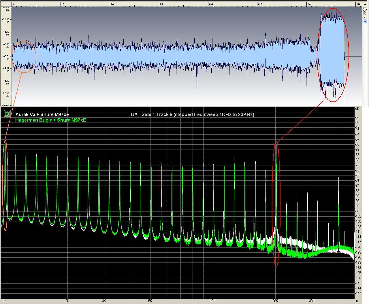

I think you mean the high peak at 20KHz of the stepped freq sweep.
See why it happens in the first attachment:
The 1KHz high peak is due to longer section in that vinyl track.
The 20KHz high peak is due to longer section in the vinyl track in combination with much higher level of vinyl cut.
(FFT was not on their mind as an evaluation tool when they cut these test tracks, only Voltmeter).

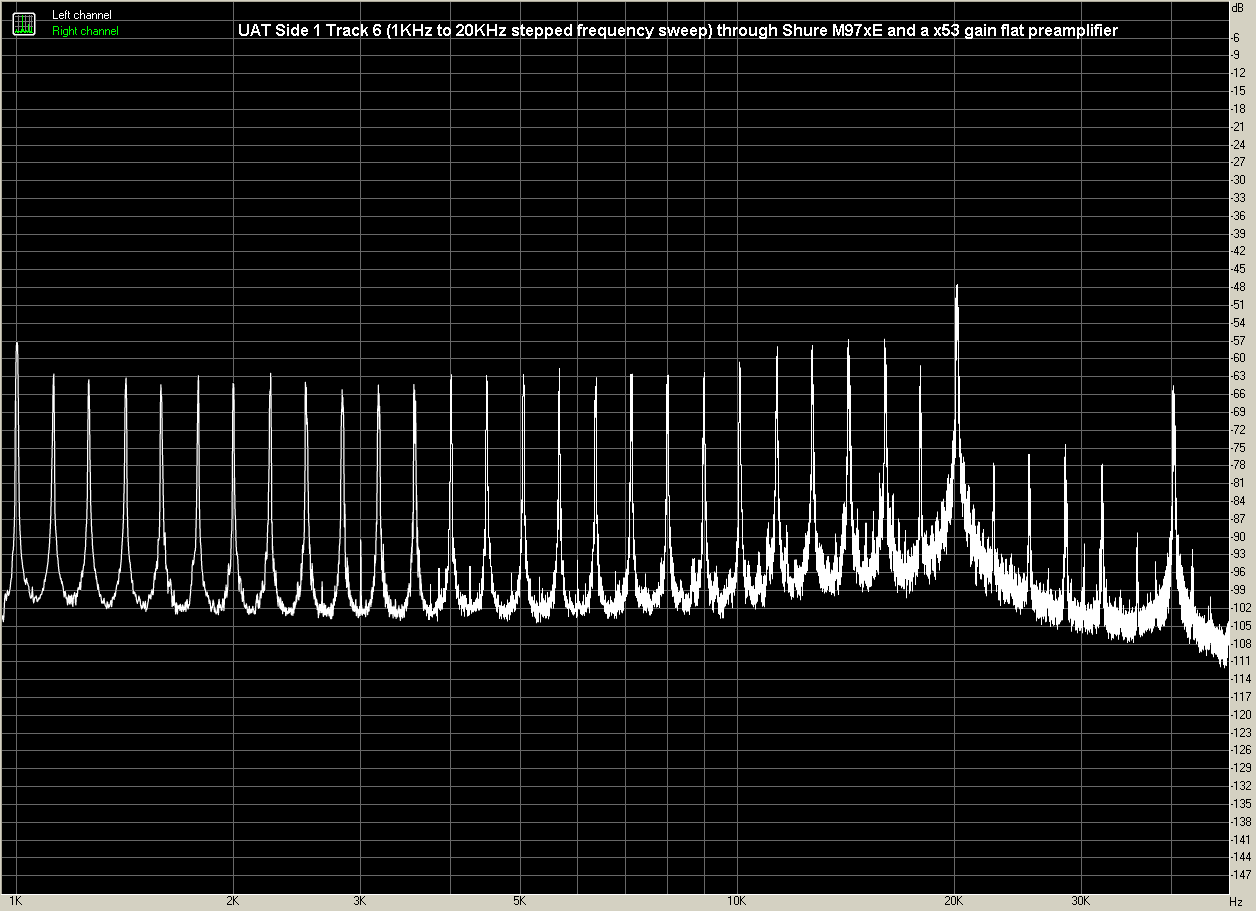

Could you please explain what you have done and how.
Hi Hans
What did I do:
The plots you saw, were the result of FFT on the recordings at the output of the RIAA preamplifiers.
UAT Side 1 Track 6 is discrete freq steps, not continuous freq sweep (confirmed through listening).
You can see continuous freq sweep in HFN Side 2 Band 7.
Using the same TT, arm, cable and M97xE cartridge, I recorded the same tracks, this time using a flat preamplifier (cartridge loading is again 47K). See second to fifth attachments for the FFTs of the flat recordings (excuse the 50Hz peak).
Has anyone made recordings using any of these two test records? If yes, please show results here. (**)

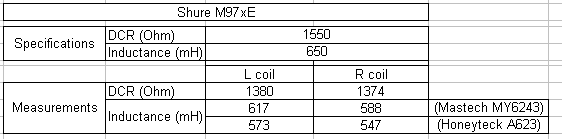

and that you assumed the correct Lcart and Rcart for the Aurak?
I measured the coil inductance with two LC meters and the DC resistance with two multimeters. See the last attachment.

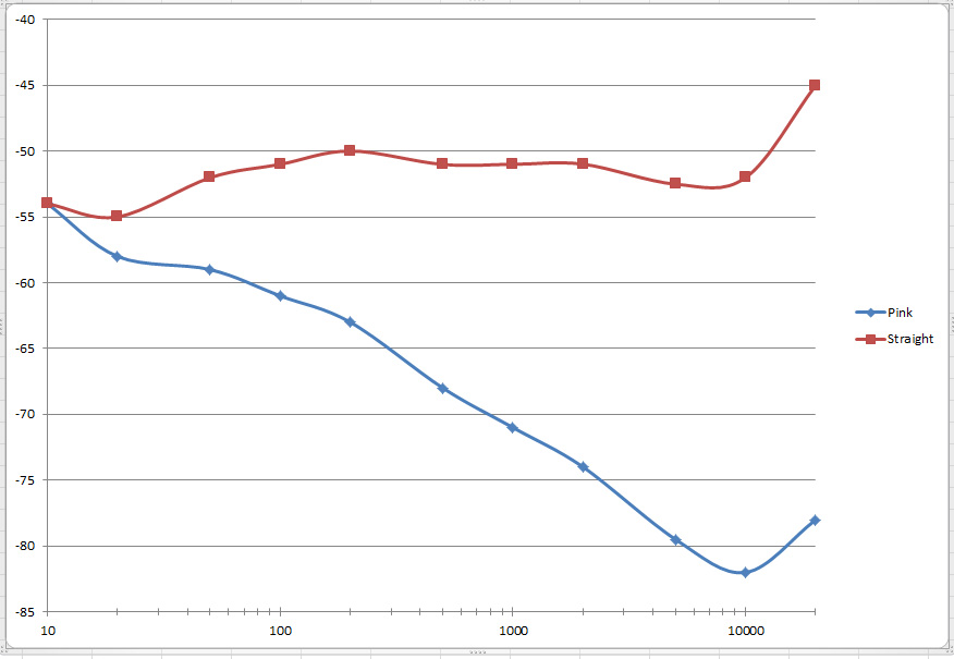

I'm a bit lost. When you do an FFT from a frequency sweep, result depends on how long or how much energy was accumulated at a certain frequency.
Since this is not the primary task of a sweep on a test disc, results will be very inaccurate.
Playing pink noise over an flat amp is just as inaccurate because noise was recorded with riaa correction..
Much better is to use a test disk with many single frequencies and use a voltmeter.
Alternatively is it possible to mathematically tilt the pink noise curve by +10dB / decade, this will be much more reliable than the two other methods that you used.
I have made a quick correction of the pink noise curve from the Aurak, taken with HFN 1 track 3.
I still don't understand that at 20Khz FR almost stops. Has this to do with the limited BW of the pink noise, or may be with your A/D conversion ??
Anyhow, the corrected curve looks like a decent frequency curve.

Yes, of course ! I thought it was already corrected.I have made a quick correction of the pink noise curve from the Aurak, taken with HFN 1 track 3.
