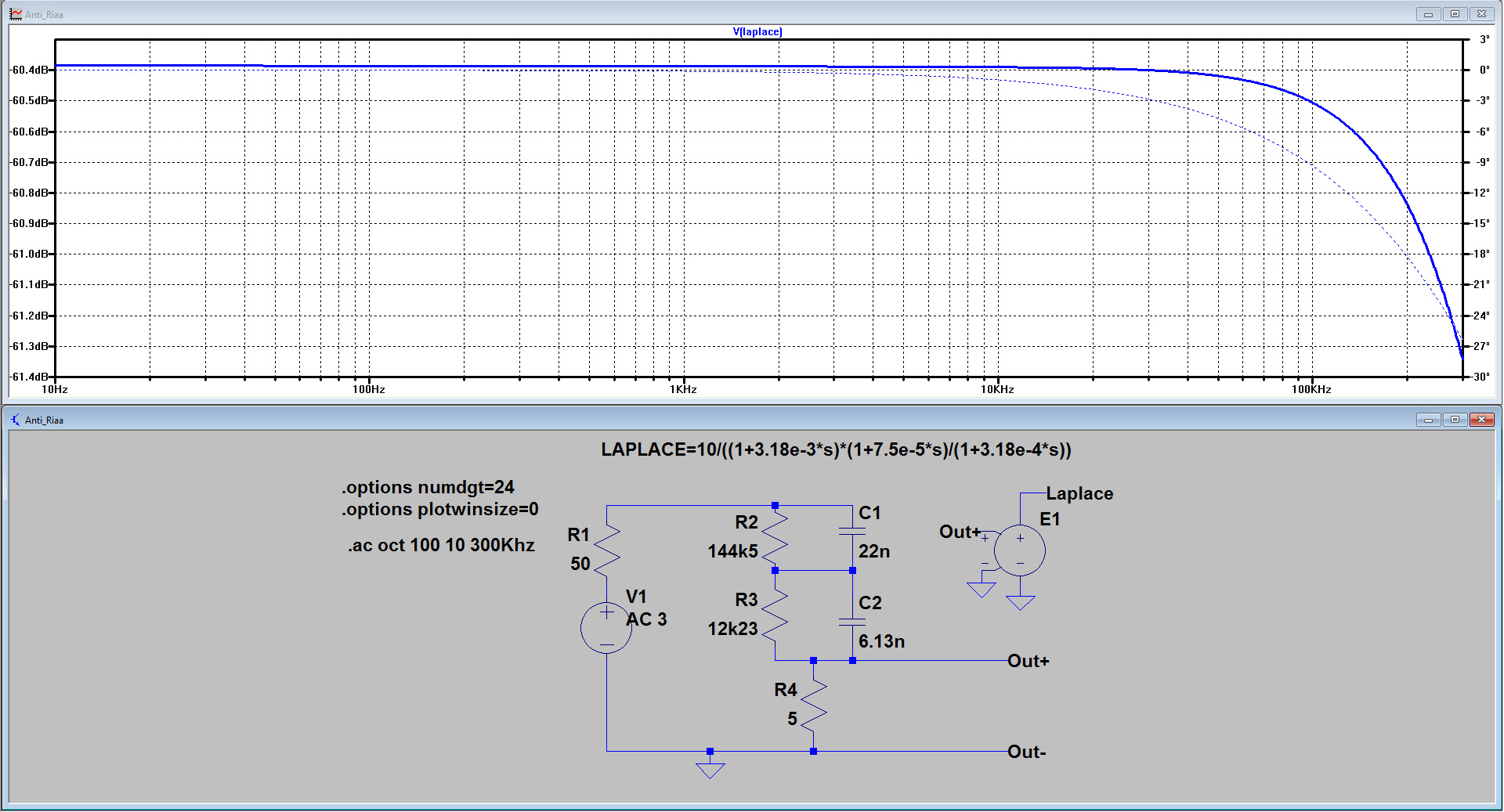

Here is the proof.
The Anti Riaa Filter followed by an exact inverse Laplace transformation.
Deviation at 300Khz is -1dB.
Hans
You need to specify the source impedance, the picture does not. There are lots of 600 Ohm generators out there.
Scott,
As you can see in the circuit diagram, I used a source impedance of 50 Ohm.
And as far as I know, this is exactly the source impedance of Georges generator.
Hans

Scott,
Yes. My generator is 50 Ohm.
I’ve simulated the circuit myself. It is perfect.
But the issue is with the real circuit. That’s why I asked if someone has measured his anti-RIAA filter at higher frequencies.
I will investigate a bit more.
George

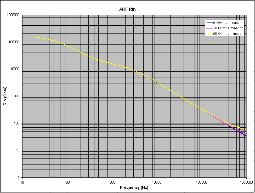

Thank you Hans.
I spent some hours turning the knobs, watching the scope screen, reading the meters and writing down the numbers.
The discrepancy is indeed due to the loading of the generator by the ARF.
So, the signal at the input of the ARF drops, which I hadn’t taken into account when I filled the data for the plots in post #557.
I hadn’t noticed it because it is not that straightforward like clipping or slew limiting as it happens with a low Ohm resistor directly at the output of the generator.
The ARF makes the signal across it’s input to drop a bit above about 100KHz, the amount of drop affected by the signal level.
I had to plot the Rin of the filter for to understand what is going on.
Spot measurement at 10 frequencies with the ARF as is (with the 5 Ohm terminating resistor). Then I simulated the same measurements. Test and simulation data coincide.
The ARF Rin plots for the case of 20 Ohm and 50 Ohm terminating resistor are made out of simulated measurements entirely (no verification through actual measurements).
George

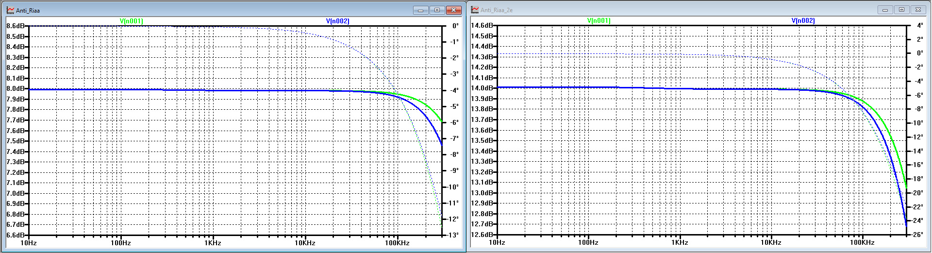

George,
I'm not exactly sure in what way your generator is misbehaving, but the simplest way to check is to measure the input voltage going into the ARF.
There is however a possibility that your generator doesn't like variable loads and prefers to be permanently loaded by 50 Ohm.
I have simulated both situations, left image is the input voltage to your ARF when additionally loading your generator with 50 Ohm, this is in parallel to the ARF.
The right image displays the input voltage to your ARF without this extra 50 Ohm load.
Green line in both cases is with 5 Ohm and Blue shows the 20 Ohm load below the ARF.
What ever deviation from these curves can be compensated for in your final plot.
Hans
