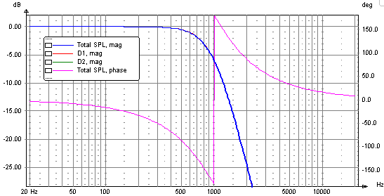

I have to agree with dlr. An individual driver plus its crossover filter will be minimum phase. But when you add a woofer and a tweeter, the sum is no longer minimum phase, it's an allpass (no magnitude change but the phase shifts). Here's a sim with 'perfect' drivers, flat from 1Hz-50kHz, and an LR4-1000 crossover. Both the drivers have identical acoustic centers.
The lowpass filter is minimum phase. It rotates 360 degrees from DC to light and the rotation is 180 at 1kHz, just as you'd expect from a 4th order filter.

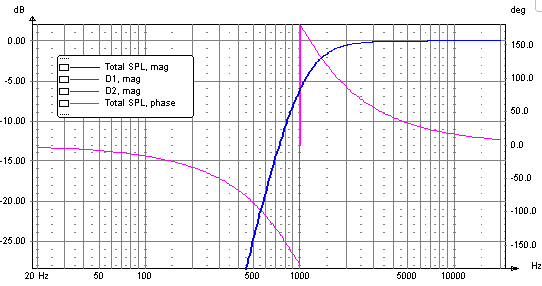

Same thing for the highpass filter.

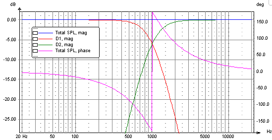

But the sum is not minimum phase. The phase still rotates 360 degrees. The magnitude sum is flat. If the sum were minimum phase, the summed phase would be flat and zero.
