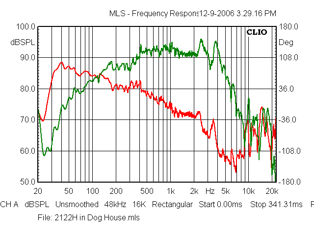

I have never seen that. Are you talking in break-up mode above the useable bandwidth?? Here's a 10" 2122 midrange driver. Looks fine to me. Where would the transition zone be in that driver?

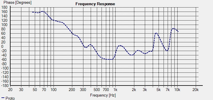

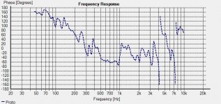

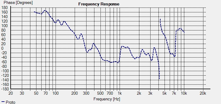

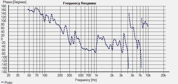

Attached a phase plot for a bending wave transducer with 1/N
octave smoothing. N is denoted in the picture name.
Every loudspeaker is a bending wave transducer, just most
drivers aren't quite aware of it.
Is your phase plot unsmoothed ?

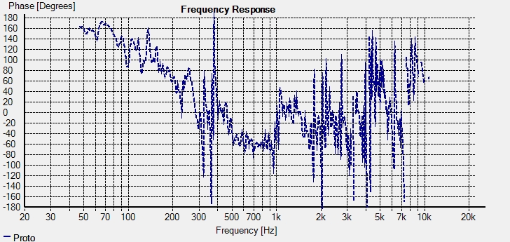

Look at that! LineArray post a graph with N=48 and look there, phase changes through 360 degrees about 370Hz. N=6 is the happy marketing graph!
I remember in the old days some companies would post a "marketing" graph based on 1 octave analysis- 10 data points and lots of smoothing. HAHAHA junk data.
Thank you line array!

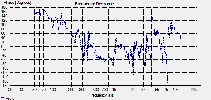

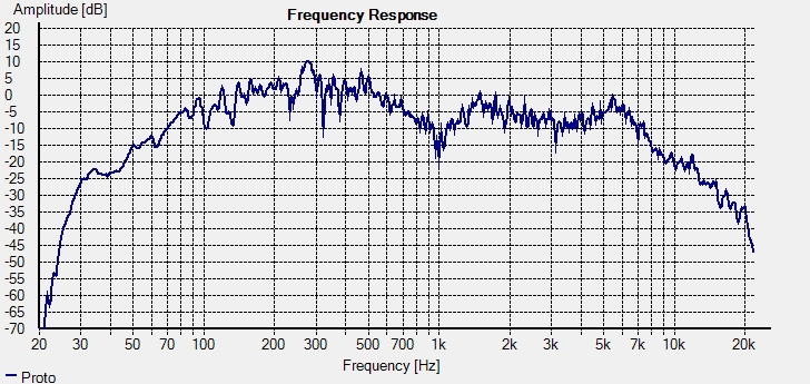

Oliver, could you post the magnitude response? The 1/48 phase curve certainly looks nasty but I suspect the magnitude response would be equally ugly. It could still be a (mostly) minimum phase system. Better yet, can you export the impulse as a 16-bit wav? I could take a look at the excess phase in ARTA.
Here we are N=48 ... can i attach .wav files in here?

Thank you for posting rob,
please do not take it personally, but knowing this being a 10" driver
i have some doubts concerning the resolution/reality of that plot.
I can post measurements of very well acknowledged 5" drivers looking
much worse.
You may claim that this driver you have got is a "wonder driver", but
up to now i have seen only few wonders in my life. None of them
was in audio.
But i have seen lots of bad software.

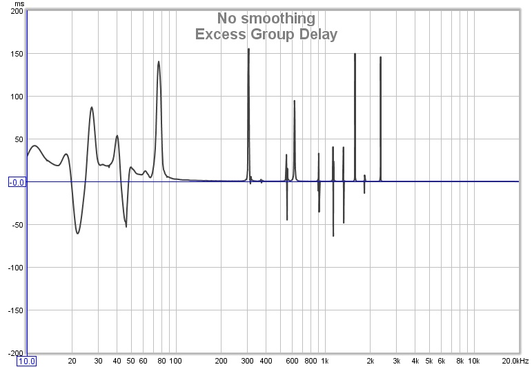

Here is the excess group delay plot for that wave file, the response is minimum phase in regions where the excess GD is flat.
Beautiful graph! So many regions the driver misbehaves and as anything but minimum phase over the entire energy band. Thank you JohnPM!
In the end this assumption of minimum phase is at best a first approximation to the reality of drivers. Any closer inspection shows excess time or non-continuous transfer functions of drivers is the result. Making drivers with a single wide pass band of a single phase seems to me to be the goal. This is why most drivers here are custom made. One decade of constant (minimum) phase so far has been about the limit. That means at least a three way!

Worse in what way?? I don't see how it's a wonder driver?? It's a 10" Pro midrange driver that looks typical to me as far as the FR is concerned. It's looks very similar to the measured response graph we have for it over on Lansing Heritage. It was used in the JBL 4344/4345 monitors from 300Hz to 1.2K where it's very flat.
I doubt my software is bad. If it is it's darn consistent and works just fine with any Crossover Software I have used it with.
