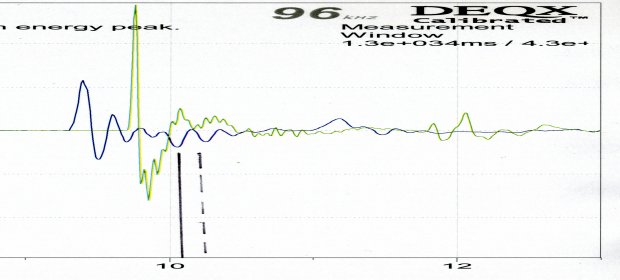

I wonder if I could have some help interpreting these impulse responses please?
dantheman? johnK? (because these are taken on an OB).
The baffle is 600mm wide, 1000mm high. The mid and tweeter are centered. The mid is a nominally 6.5" driver, actually 120mm in diameter. It is centered 400mm from the top.
The tweeter is on a 12" waveguide, centered 180mm from the top.
All relevant because I would like to know the difference between expected "edge" diffraction, and the mooted possibility of a double impulse response, inherent? to a dipole configuration.
The graphs are resized images from the DEQX measured impulse responses, before it does its stuff.
The first shows the tweeter and mid (drivers off-set obviously) taken on the tweeter axis at about 2m.
At about 10.1 (solid marker line), there seems to be an out-phase? component to the mid response, which in itself seems to decay nicely.
The time seems to correspond to the closest baffle edge (if my arithmetic is correct!!!).
Is this what you would expect to see from edge diffraction (i.e could be eliminated with the use of a baffle as a figure of eight in cross section, as suggested by Earl), or is it the origin of a new impulse response due to cancellation of front and back waves? My gut feeling!!! is that a null wouldn't cause this?

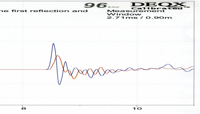

Since it has been proposed on the Beyond the Ariel thread that there is a second impulse on a dipole, this is the crux of my question.
There also seems to be something out-of-phase with the tweeter at the dashed line (which doesn't seem to occur at 45 degrees, on the second graph- 0 degrees green, 45 degrees orange). The edge of the waveguide is closer to the edge of the baffle than the mid is, but if the origin is the driver itself, it would be further.
According to the graph, it happens relatively quicker, and there can't be dipole cancellation!!, so is this edge diffraction originating from the edge of the waveguide mouth, before leaving the edge?
The out of phase bit with the tweeter doesn't seem to occur at 45 degrees?, but otherwise the impulses seem to track pretty well.

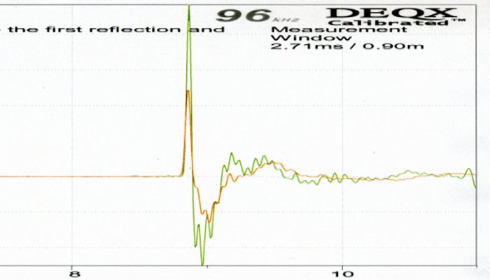

The third graph shows the mid at 0 degrees- blue and 45 degrees- brown.
Things seem a bit more complicated here, as the 45 degree measurement seems to trend to an out-of-phase response. What can we glean from this??

since your driver mounting is symmetric, the reflections
from the side edges arrive at the on axis measurement
position at the same time.
That rather strong reflection with the midranger in the
first picture may be well explained this way.
Asymmetric mounting is advantageous, to
circumvent those strong reflections.
The "phase shifting" trend observed off axis on
the third picture is due to lobing, which occures
to the sides if the baffle width is more than
about 2.2 x the diameter of your driver.
The maximum baffle size for a 120mm driver
which avoids side lobing would be about
260 mm. If you play a sinewave with your
baffled midranger at a frequency high enough,
the phase will change from lobe to lobe if you
rotate the baffle.
I do not know what happens with the WG tweeter,
but probably the tweeter is less affected from
the baffle edge reflections, because the WG
"hides" them for the tweeter. Reflections may well
also be due to WG mouth ...
Remember that there is no back radiation for the
tweeter so the diffraction effects would be less
pronouced even without the WG.
There is no "inherent double impulse response" with
dipoles. But peaks and notches in frequency response
due to baffle diffraction are more pronounced than
with a closed box of same baffle size. This is also
because of the rear radiation lurking around the edges for
lower frequencies where the drivers are non directional.
The more important it is, to account for those reflections
during design (see above), match the baffle size to the
size of the drivers and find an optimum position for the
drivers.
When the overall sizing is OK, further refinement can
be done by rounding the baffle edges and using absorbent
material e.g. around drivers/baffle edges if necessary.
Kind Regards
Oliver
Forget about that "double impulse response, inherent? to a dipole configuration". What you hear from the backside of a dipole is simply the part of its edge diffraction which is radiating to the front. And the timing for that rear edge diffraction is exactly the same as for the frontal edge diffraction.
And please forget about that "two point source" model for dipoles, if you are looking at extended sources like cones, domes, ribbons etc. and at any sort of baffle. At 45° your "two point source" model is completely useless in that case.
Rudolf

Thanks Oliver and Rudolf.
At last I see the 2.2 factor before my very eyes 🙂. (Orion, Nao e.t.c. e.t.c.!!).
I'm still not sure what Jmmlc is demonstrating with the "double impulse", that no-one else seems to go along with. (and is also not my understanding either).
