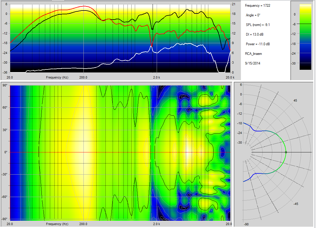

Here is a speaker that I just took data for last month. It has lots of serious problems that are all confirmed from the direct FFT data. How about we do this one?

Thanks Earl and bolserst. I have the data in ARTA myself, but I figured I'd wait until Earl posted his Polar Map data to compare.
That 40° impulse is goofy, I'm not sure how I missed that. I had to manually click "Auto Detect" for the largest peak for the last 5 or 6 measurements because they were off by about 20ms. I hope to have a new speaker based on this design but with a cardioid midwoofer and an improved waveguide done before it gets too cold out. If I do I'll get my time lock issues in Holm sorted........I hope that's what's causing the gross difference in your result vs. ARTA!

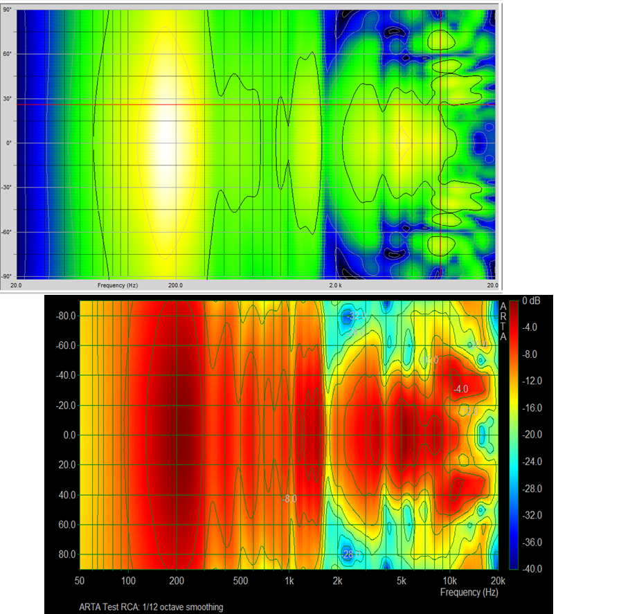

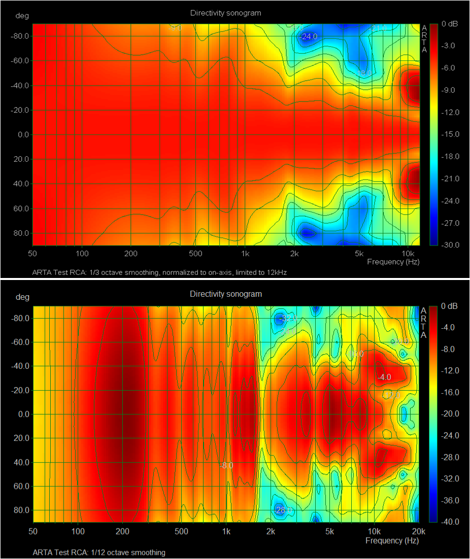

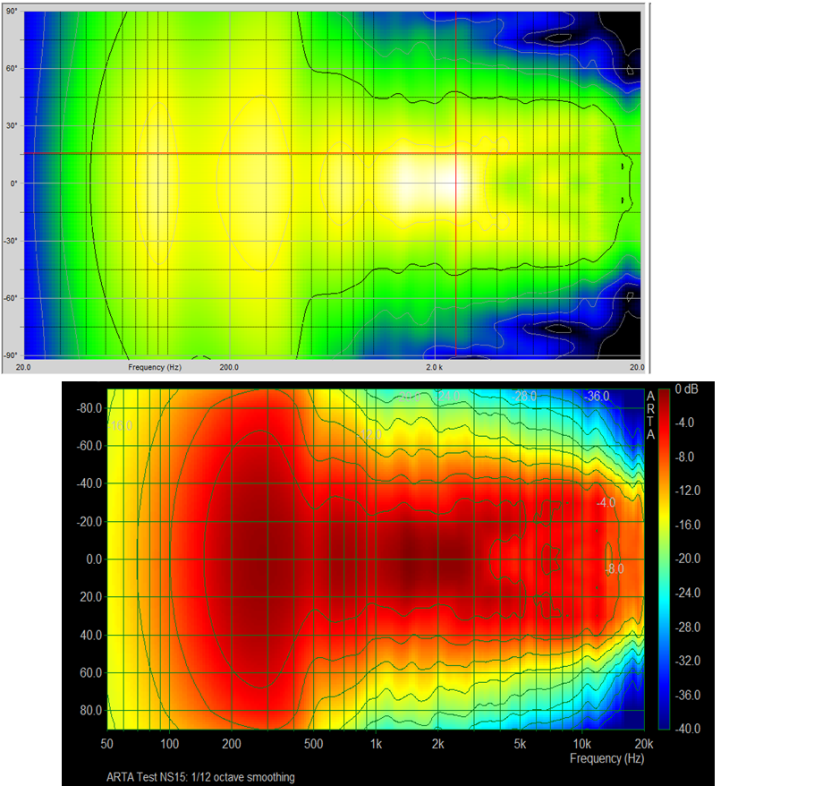

Attachment #1: Comparison of problem speaker.
Attachment #2: Comparison of good speaker.
Attachment #3: Alternate visualization of good speaker.
Notes:
1) Data smoothing was 1/12 oct for both methods.
2) Scale range was 42dB for Gedlee polar map, and 40dB for ARTA sonogram.

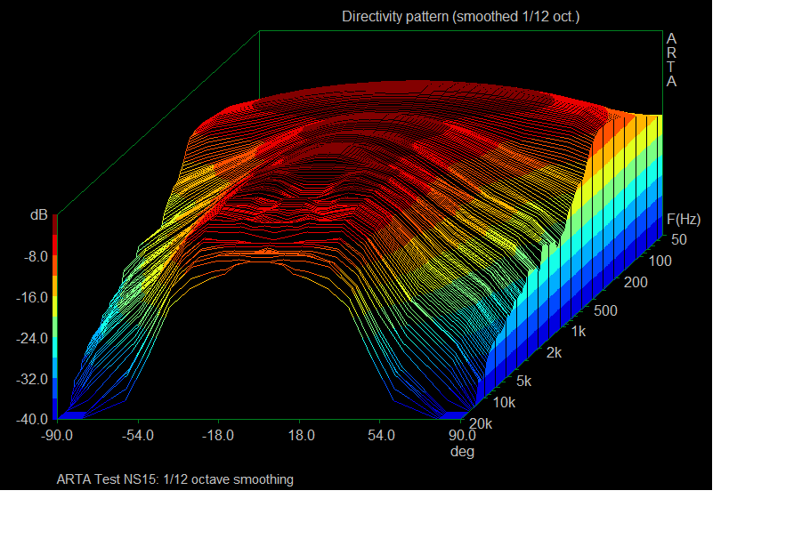

Bolserst Thanks for those plots. Not as different as I expected. Perhaps the ARTA stuff that I had seen in the past was heavily smoothed by the user rather by default in the software. I would have had no way of knowing which. But I have almost never seen an ARTA map as detailed as what is shown in your left hand plot. All of the real warts are there even if they aren't exactly the same. I think my technique works a little better near the 10 kHz point, but that is to be expected. But they are not so different that it would worry me.
For those who may not understand the above is how I and ARTA plot the exact same data sets. The data is identical in both examples between the two plots.
Do people prefer the RTA coloring or mine? I redid my color scheme after I read an article on using color in engineering plots. It was emphasized that it was important that the color scheme match what is being expressed and not just done willy-nilly or "colorful". So I ordered my color from bright to dull as intensity from high to low. ARTA is clearly not done this way as the highest levels are in a dark color with bright rings at an average level.
I like the ARTA colours a little more. In your colouring I find it not so easy to distinguish the bright colours from each other on a (bright) computer screen (especially yellow and white). As these bright colours are the most important, I like the darker colouring more because of their better contrast toward each other.

Looking at the ARTA plots, I can see that my contour lines need to be darker and perhaps more often - say 2 dB instead of 3. This might make for a higher contrast without the need to change the "intensity" principle.
You certainly could be right about 1/3 octave smoothing being the default option when the software is first used. But it keeps your check-box selections for successive plots. Another thing that often makes a problem speaker look good is if you normalize to the on-axis response. For example, attached is a comparison of the exact same RCA data set, with normalization and heavier smoothing applied. Personally I like to see where the warts are, not hide them.
It would be very interesting if a speaker like this could be measured with 2deg angular increments and then compared with the results of your modal approach using the 14 angle subset of those same measurements.
I also noted that in your polar map of the "good speaker" there is a ~3dB rise in response around 100Hz on-axis that is completely missing from the ARTA plot. Is this due to the LF extrapolation possible with the modal approach that you mention in your white paper?
Are your current contour lines really every 3dB?
After inspecting the color scale for a bit I had decided they were every 6dB.
Bolserst
Yea normalizing and smoothing makes everything look good. One would not even know those were the same speaker.
The 3 dB "difference" between my plots and ARTA is due to the LF falling below 200 Hz from windowing in ARTA. Mine is extrapolated based on the enclosure size, driver size, f0 and Q below 200-300 Hz and matched to the monopole and dipole levels in that region. I am not exactly sure how accurate this is, except that I know it is more accurate than ARTA here because it does do anything about the windowing problem. I used to use near-field in this region, but then I found that the new technique worked just about as well.
The contour lines are every 6 dB on the web software, but I thought that they were every 3 dB on what I am using now. Some are so faint that they are hard to see. I am going to change that.
