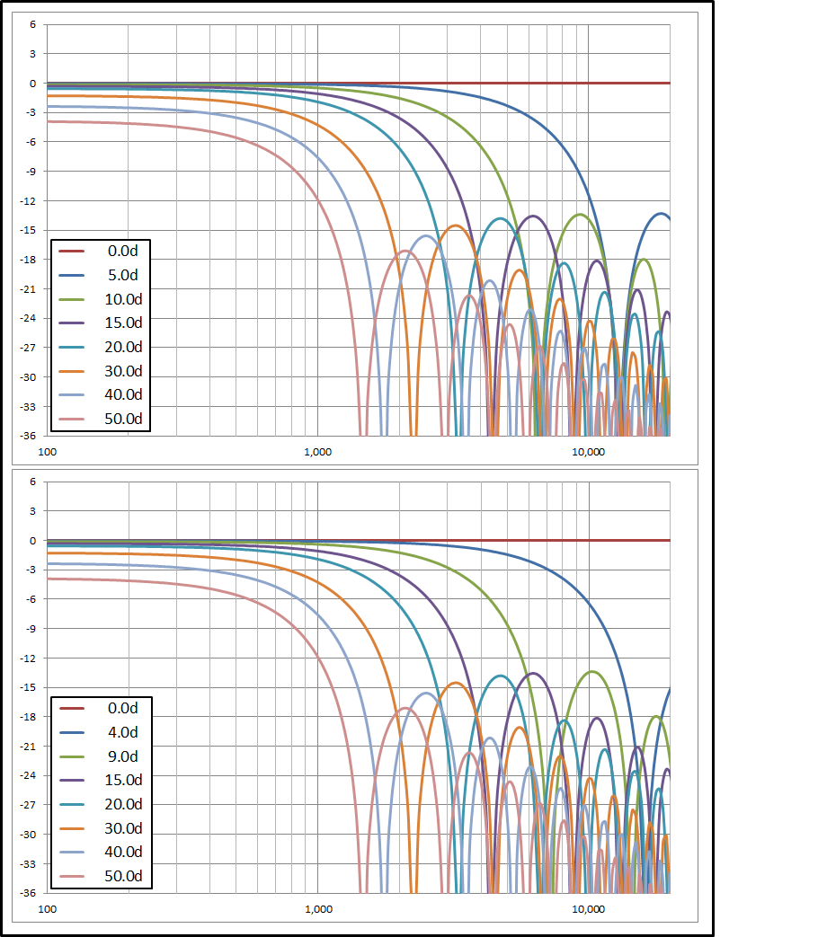

The issue at 13 kHz is aliasing from the point spacing. My choice of 0, 5, 10 etc. comes from my desire to get good data up to 10 kHz with the least number of points.

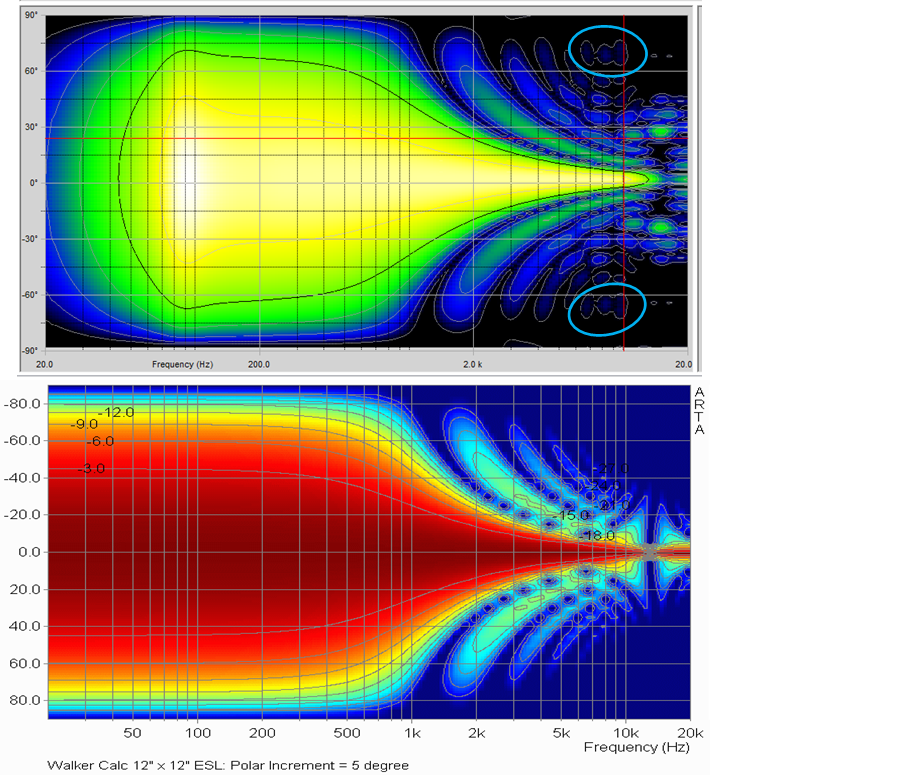

Is it aliasing that is resulting in the circled response areas in Attachment #1 that are not contained in the source data set? If so, would it help to stagger the first few increments rather than using equal 5 degree spacing? For example, Attachment #2 compares 5 degree spacing with initial increment size of 4, 5, & 6 degrees. This would keep notches in multiple response curves from aligning and would provide some output across the top octave for your process to operate on no matter how directive the source. I could easily send you a new version of the test case using these angles if you are curious what the results would be. This also brings up again my question in post# 61 about required tolerance on the measurement angles. If I have understood your previous responses correctly, it isn't critical if 1) the source isn't too directive, or 2) the main area of interest is < 10Khz even with a highly directive source. Is that correct?

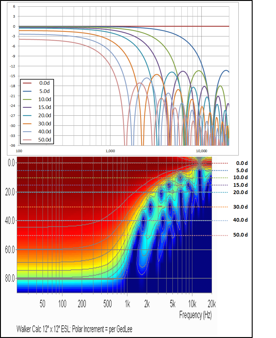

Concerning ARTA sonograms: Attachment #3 shows the response for your first 8 chosen angular slices thru the sonogram. As the author states, you can clearly see that 2-D interpolation is used and I see no problem with that. I am puzzled why you at times have suggested or implied the methods used are faulty(perhaps you didn’t mean it that way, but that is how it came across). It is a simple, stable method that gives reasonable results and its limitations are known and understood. I guess I don’t see this as being any different than making sure the limitations of your reconstruction method are known and understood. This was part of the reason for the extreme test case…to help understand the limitations and behaviors when limits are exceeded. If the desire is a database to compare different speaker designs, you need to make sure that none of the designs (when measured) approach the limitations of the process.
Those off axis areas would not be aliasing, but limited resolution off axis.
I think that staggered angles would be a good idea. I could test that, but not easily, it would take some code rewritten and I could not easily implement an angle change in my setup without rebuilding the stand. If you want to send me the data at different angles I'll see what I can do, but I remain unconvinced that there are any real issues here.
You are basically correct that I don't worry much about > 10 kHz, so "less accurate" data is OK with me in that region. And if the source is not highly directive then the issues are far less. Who would actually design a speaker to have a 2 degree coverage angle at 10 kHz? I have never seen this in practice and while such a thing might be possible I do not see it as probable.[/QUOTE]
All that I ever said about ARTA was that I expected that angular interpolation was used - I was right. There are good ways and bad ways to do that. I have no idea which he did. ARTA data always looks better to me than what I get - that makes me suspicious, but I have no more data than that on which to base an opinion. When we have more comparisons - right now we have no real world comparisons - then we will have a better idea of what the issues are. I have used my techniques far longer than ARTA has even been available, so by now I am quite confident in them - not that this came without some bumps in the road mind you.

The data fit is done in a shifted set of angles using cosine(theta). So the ideal would be a set spaced in those coordinates with a higher density at 1 than at -1. Nice project if you want to do it, I just didn't, and still don't, see the need.
Optimizing the analysis around a square source is also probably not a good idea because they have different properties than round sources - different null locations for example.
I choose 5 degree increments because my stand was already laid out in 5 degree increments. I original did this at 5 degree increments all the way around, but then I realized what I mentioned above. One wanted a set that optimized the data at 1 when transformed by cos(theta). I was able to get the same results with the 14 data sets as I did before with 37. Why do I want to do more work for nothing? Time = $ 🙂

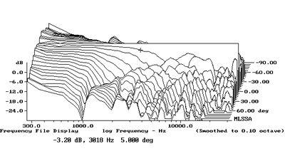

Some Stereophile measurements for a discontinued model here: (lateral response plot attached)
InnerSound Eros Mk.III electrostatic loudspeaker Measurements part 2 | Stereophile.com
