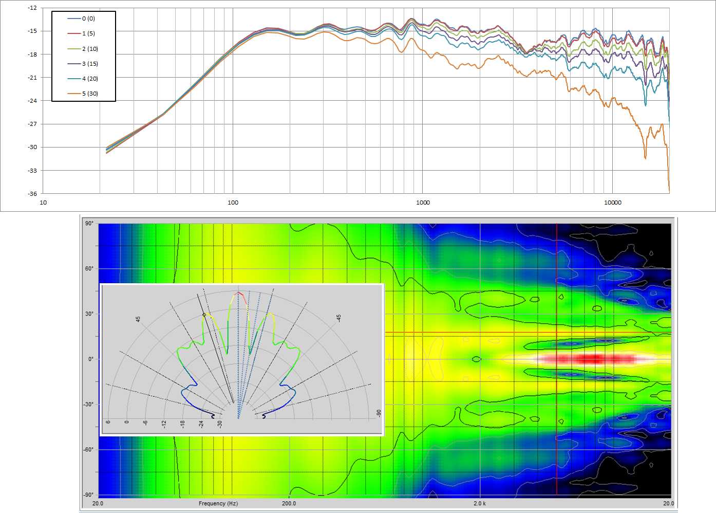

Here's the data for my 2-way waveguide. It's an 18" wide elliptical wg I built, with a 15" woofer in a 3cu ft sealed cab. I hope this is of use since I was having issues locking the time.

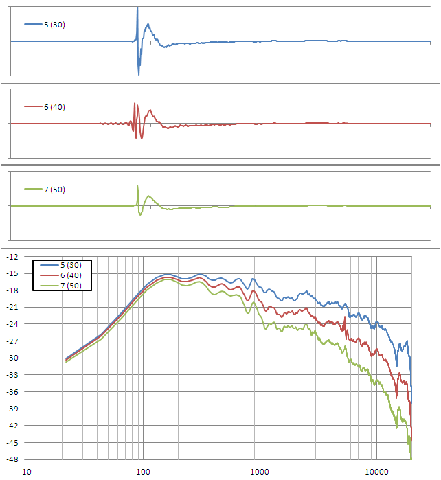

Thanks for the data. Before I post it I want to make sure that there is not something wrong. The impulse response at 40 degrees looks faulty. It is far far different from 30 degree and 50 degrees. You can look at it yourself or send me the full Holm file. Basically I don't trust this data set. It just doesn't look right and I am sure that you would find the result disappointing.
Lets make sure that nothing is wrong.

Looking at it some more, i.e. in the frequency response, it seems consistent so maybe it is OK. But your setting the impulse response timing by eye is a little disconcerting since I don't know exactly what that will do.
All of my calculations are complex so the phase is carried forward through out the process until the data is actually plotted which is then the magnitude squared so the phase gets lost at that point. But the modes each have a phase and adding them up with different phases can produce different results. I know this because I initially did not do the analysis in complex numbers because the numerical codes were based on real data. A while back I changed everything to complex and found some variations in some data, but mostly off axis. On axis the modes tended to be in phase so the lost phase was not a big issue.
An incorrect impulse timing causes the phases of the various modes to be incorrect, again more so off axis since the impulse delays more and more as one moves off axis. Hence, incorrect impulse timing does cause errors, but to what extent is hard to *****.
The power response is phase blind so it is always correct. Hence if the power response does not seem to track the polar map well then this could indicate a problem with the impulse timing.
Yeah, the 40deg impulse shape does seem inconsistent with 30deg & 50deg but the resulting frequency response shows only a small 5.5kHz spike.

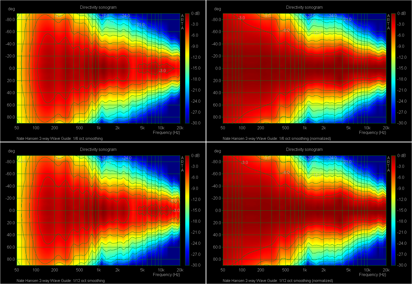

The ARTA manual does a good job of documenting the processes and exact file formats used. For example, it is simple matter to read in the HOLM file format you like and create the binary *.pir files ARTA uses for polar plotting. Attached is the ARTA sonograms for the data natehansen66 posted with 1/6 or 1/12 oct smoothing, with or without normalizing to on-axis response.

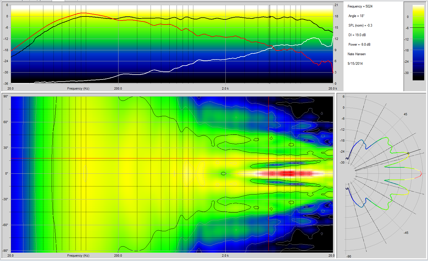

Here is what I get for the Hanson data.
The HF lobbing could be because of the impulse response timing error, I don't know.
I have always found it curious that ARTA never seems to show lobbing, while my analysis always does. Real sources virtually always have lobbing.
The axial response at 18 degrees is quite good, although a flatter DI would be desirable.
I will post this into the database once I get back access to it.
Certainly sometimes course angular increments may hide or smooth over lobing.
I usually acquire polar data with finer increments (0 - 20) for this reason.
In this case, I think there must be an issue with the processing due to the timing error you mentioned.
You are showing a 12dB or larger null at 5kHz in the polar plot right at 10degrees where data was acquired.
I don't see anything in the 0 - 30 degree response curves that would suggest this is real (in the 5khz - 10Khz range).
Also, I don't see the pinch at 3.5Khz in your polar map either.
While the timing issues are being worked out, and if it interests you, I could easily generate polar maps(sonograms) for any of your datasets you currently have HOLM data for that you are confident impulse timing issue are not present. If you can generate polar maps for the same data sets with 1/12 oct smoothing it would be a good "apples-to-apples" comparison of real data that you are comfortable with.
