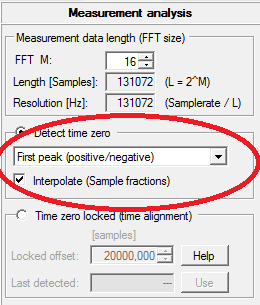

The data at 80 degrees and beyond is exactly what I said - the time base was not locked and Holm grabbed the reflection as the first arrival signal. It is obvious in the Holm data set.
Users would be wise to carefully read the procedure. the problems caused by not locking the time base can be significant.
I believe that you must also set "Keep in/out stream active" for this lock to work. If the stream is started anew each run then locking won't work. Sorry if I did not mention this before, but I have always had the stream set active, so I didn't think about it. I don't even know why it is an option.
Looking at the Holm data before you send it is always a good idea. If the impulses do not slowly retard in time then something is wrong. The frequency responses should not change abruptly either as this is a strong indication that something is wrong.
Ok, I thought with “locked” you actually meant "Keep in/out stream active", and this is what I have done. I did read your instructions, but for users who never work with holm, the brief instructions might not always be clear enough (or at least for me anyway)
So, to be sure were are talking about the same "locking" now:
- first measurement (at zero degrees) should have "detect time zero" enabled (see pic)
- after the first measurement is completed, I should select "time zero locked (time alignment)" and use the "last detected offset" by clicking the “use” button
- all following measurements should be taken like this
Is this correct?
