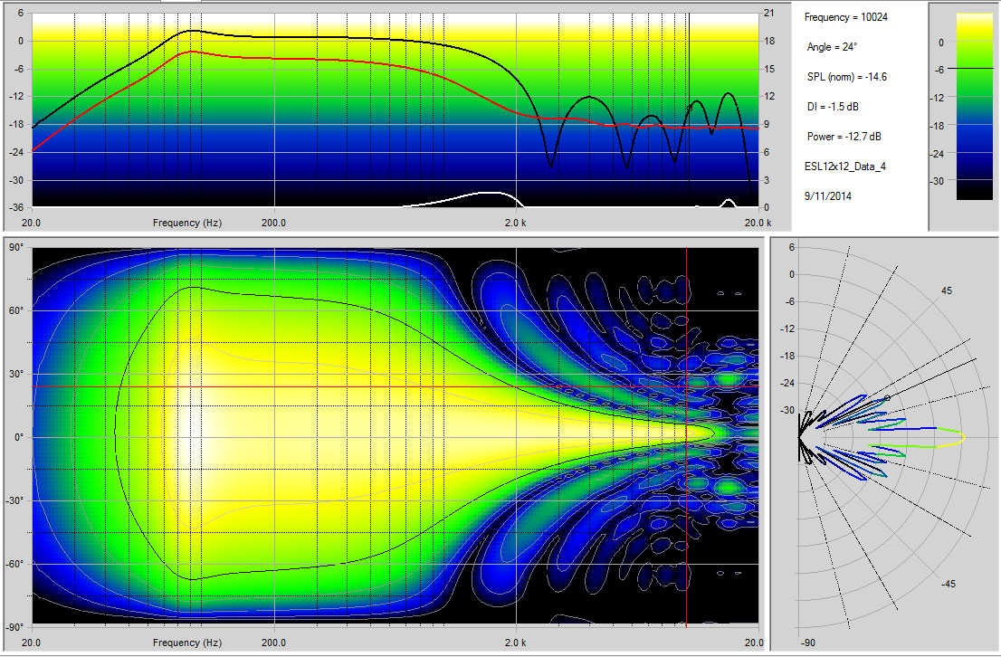

Below is the result. Not bad I'd say. Certainly better than ARTA would do with a 13 degree average spacing (180 / 14).
I am now curious about why the model gives a slightly higher HP Q than I submitted. I had to put in something for the low end - I had not anticipated doing plots that did not have any HP function at all.
Some of the HF resolution here could be due to using only 200 points in the frequency axis. Again, I have not anticipated doing anything with such pronounced HF beaming.

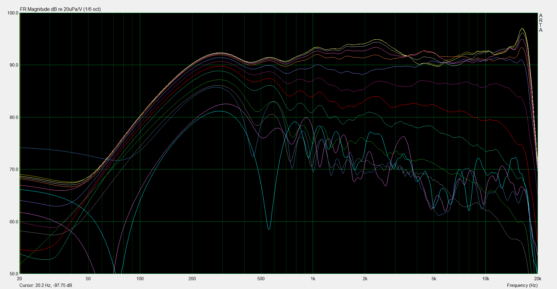

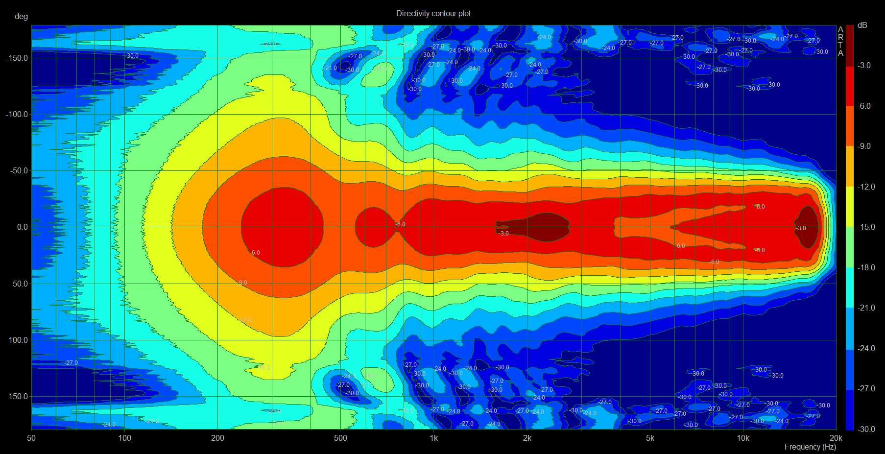

As promised, I made the measurement in ARTA and holmimpulse on my rotary table. Attached is the polar plot from ARTA, and also the frequency overlays. The measurement angles are those defined by Dr. Geddes.

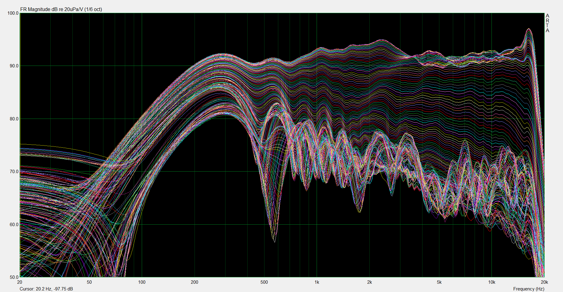

I also made a measurement at every degrees between 0 and 180 to have a really high resolution polar for comparison. The overlay is also attached, but ARTA crashes when I try to generate the polar plot! I still have all individual measurements in PIR, txt and wave format, so if anybody has some tips to produce the correct polar from this, it would be very helpful.
@Dr Geddes, the Holm export is attached in the requested format. I looking forward to see your result.
The speaker measured uses an OS12 waveguide and an AE TD12M basmid. Crossover is a behringer DCX2496 crossed over approximately at 1200 Hz 4th order acoustically.

It works indeed. Thanks! Here is the polar response with 179 measurements 🙂. I do not think the measurment at 180 degrees will make a lot of difference ...

I think my previous measurement (with 179 measurement angles) clearly shows you do a very good job in your software. The difference between the 14 measurement polar is almost nothing (and absolutely nothing more to learn from the data)

What was the measurement distance?
Could you send me the Holm Zip file? The data doesn't look right and I want to see if it looks the same in Holm.
Also it is some sort of cardioid, correct? This throws off the model at LFs.
Since you only have 4.5 ms of clean data, then even the ARAT results are no good below say 200-300 Hz.
