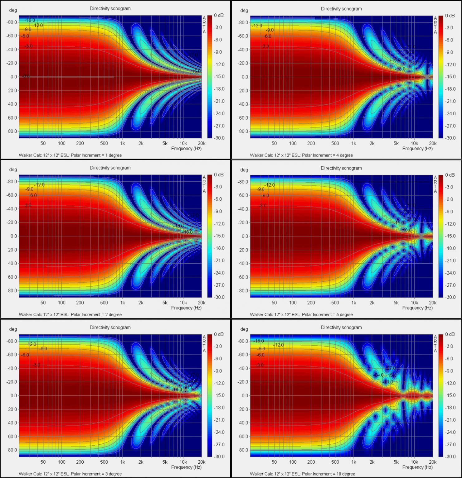

_Wm_ - so would I because ARTA never seem right o me. I suspect it is interpolating the angular data which smears the results. This is well know in pro standards, which is why the minimum spacing in the standard is 2.5 degrees. They do not allow interpolation.
I recently calculated a polar data set with 1 degree increments for a 12" x 12" square ESL using the generalized Walker equation for far field response of a constant current driven electrostatic dipole radiator.
ESL simulator - technical background on Walker's equation
I then used ARTA to plot up sonograms(1/12 Oct smoothing) using different subsets of the total data set to see what is missed if polar data was only available with angular increments of 1, 2, 3, 4, 5, or 10 degrees. It sure looks like 2.5 degrees is probably a good estimate for the threshold at which smearing of fine detail starts to become obtrusive.
I still have all the impulse data. I could easily assemble the required subset of impulse data it into the format you use from Holm Impulse. Would you expect your process to be able to recreate something similar to the plot for the 1 degree angular increment?
