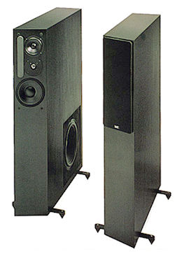

The measurements will not conform well to the Harman paradigm- Kantor believed in asymmetric polar patterns and specific baffle angles. The measurements I've done on them show a pretty flat response at the listening position (I moved the mike around a 30cm square window where my head would be), but it would be really interesting to see how they show on a high angular resolution measurement set. If I can get some sturdy assistants...
I had those discussion with Floyd Toole once when he wanted to measure my speakers. He did not seem to think that using a non-symmetric, or in my case, off-axis, listening position would be an issue. I would tend to agree.
I also agree that a non-symmetric polar response about the "listening axis" is highly desirable. But it is not so easy to create a pattern that is not symmetric about some axis. To me just toeing in the speakers gives the right results in the forward direction. It would be nice if the response fell off faster as the angle went away from the listening axis towards the back. This is certainly possible, but then you have to make a left and right speaker that are unique. And then if there is a center channel this is different as well. From a practical standpoint it is just not feasible.
So they tilted the baffle? How is that any different than just tilting the speaker? It just makes manufacturing more complicated that's all.
It essentially forces the correct angle to the head in order to (in Kantor's view) optimize crosstalk. At the same time, it forms a pi/8 corner for the woofer, and forces the correct distance between woofer and midrange to eliminate the so-called Allison effect. There's an absorber on the outside edge of the midrange/tweeter array but not the inside.
Subjectively, when I'm in the sweet spot, the image and sense of the acoustic space are better than just about any other speaker I've built or owned. I can hear all sorts of engineering tricks in recordings.
(photo shamelessly stolen from Home Page | Stereophile.com)

So these are forced into the corners? That's pretty wide in many rooms. No certainly not the way I would do things.
I would agree that if that was the intended placement that this would be the way that they should be measured. But I do not think that the results would come out quite like you hope. They won't be constant directivity and the angular polars would likely be pretty rough. That situation could be done with my approach by mirroring the response about the plane of the wall side of the speaker. The gap may be an issue as that would be "bad" but hard to account for.
We all have different subjective opinions about things. This thread is trying to get away from that.
No, they're actually spaced well away from the corners, but placed against the back wall. The back wall and the speaker cabinet side form a virtual corner.
The low resolution angular measurements are actually pretty smooth:
http://www.stereophile.com/content/nht-33-loudspeaker-measurements
My versions are somewhat different than the production version, but not so much that this measurement would be significantly affected. And as you might gather, I love measurements and have no particular religious attachments to commercial products. The measurements are what they are, and I think it's always better to have them. If you've improved the genus, I'm all for it.
