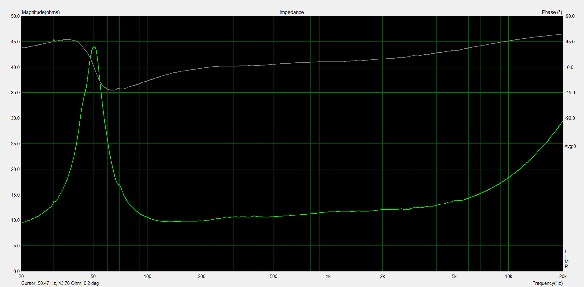

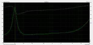

Ok, so here is my speaker again:
- box volume: 100 l
- speaker f0: 50 hz
- speaker Qtc: 0.41
Attached is the response that I get.
I am having trouble with the LF response as stated. A 50 Hz resonance in a closed box with a Q of .41. That seems highly implausible to me and the data looks the same. The response is down 6 dB at 60 degrees at 300 Hz, which implies a large diameter driver (which you did not actually specify so I guessed it at 26 cm.) A driver that large in a 100 L box with f0 = 50 Hz and a Q of .41 !?! What kind of driver is that?
If it is alright with you I'll add this to my database once you explain how you were able to achieve the LF as stated.

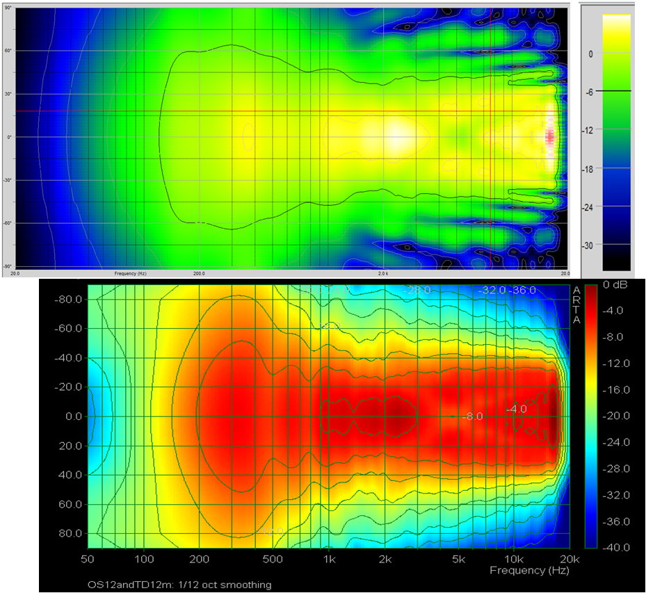

I think I have some "bad" speakers I can measure to make a comparison between every degrees and the 14 angles...
Actually, the speaker you provided data for in post#169 may be ideal for the purpose.
The attached comparison shows 3 clearly define lobes off the main axis in the Gedlee polar map that are not even hinted at in the ARTA sonogram.
Can you make measurements of this speaker at every 2 degrees?
If so, and the lobes show up, this would provide clear substantiation of the Gedlee modal analysis.
You could create the 14 angle data subset for processing by Gedlee so the comparison is using the same parent data set.
@Gedlee,
Do you see any issue with this plan that would invalidate the comparison?
For example, would the ~4mS window compromise the processing in the frequency range of the lobes?
Bolserst
Not if the 2° data were plotted in some independent software whose "smoothing" scheme is know - preferably there isn't one. Plotting in ARTA, or in my program, does not guarantee that the data is correct, it could be done the same way for 2° as it is for the wider spacing.
I don't think that the 4 ms window is an issue at the frequencies that we are talking about. Spatial aliasing is. We already know that both programs alias above 10 kHz for very difficult data. This data does seem to be ideal however.
The lobes shown in those plots are not classic lobes. The usual pattern is for the lobe to swing down from a wide angle at LFs to a narrower angle as the frequency goes up. Lobes that do the opposite, like those shown, must be something else. If this were a cardioid box then I would suspect those might be leakage from the sides. I simply have not seen anything that does what is shown in that plot. It is curious and I am curious.
Looking at details like this have helped me in the past to find obscure problems that I did not realize existed. Those "lobes" (for lack of a better definition) might be something interesting that none of use would have expected.
Until we can all understand how one gets 6-8 dB down at 60° at 300 Hz, I think that there is a lot to be explained. All of this data is just not anything like I have seen before. I'd love to know what is what.
I used the values that I had in old notes, but after some re-evaluation, they seem pretty correct.
The actual Qtc is probably a bit lower, because I did not take into account the box stuffing (which would enlarge the apparent volume). BTW, the driver used is an AE speaker TD12M, you can find the thiele small parameters here: http://aespeakers.com/aes_store/catalog/product_info.php?cPath=23&products_id=108 Driver diameter is 30 cm.
Based on the thiele small parameters above, and a box volume of 100 liter (not incorporating stuffing), Qtc calculates to 0.39 and Fb to around 62 Hz. I had however an old impedance plot (see below), which shows that Fb is around 50 Hz. Doing the reserve calculation, this would mean apparent box volume needs to be around 188 liters (this seems a little to big effect to be stuffing alone), and Qtc around 0.33.
I did not measure the thiele small parameters of the actual drivers, so this could make some difference also, but deviations should not be too big.
@Gedlee,
I have measured this exact speaker at every degrees and added the polar plot here http://www.diyaudio.com/forums/multi-way/261616-measurement-technology-8.html#post4055223
The lobing is not visible. The raw data can be downloaded from my cloud.
Bolserst
I hope you can figure it out, because I have no idea. I can only help by taking additional measurements if required
