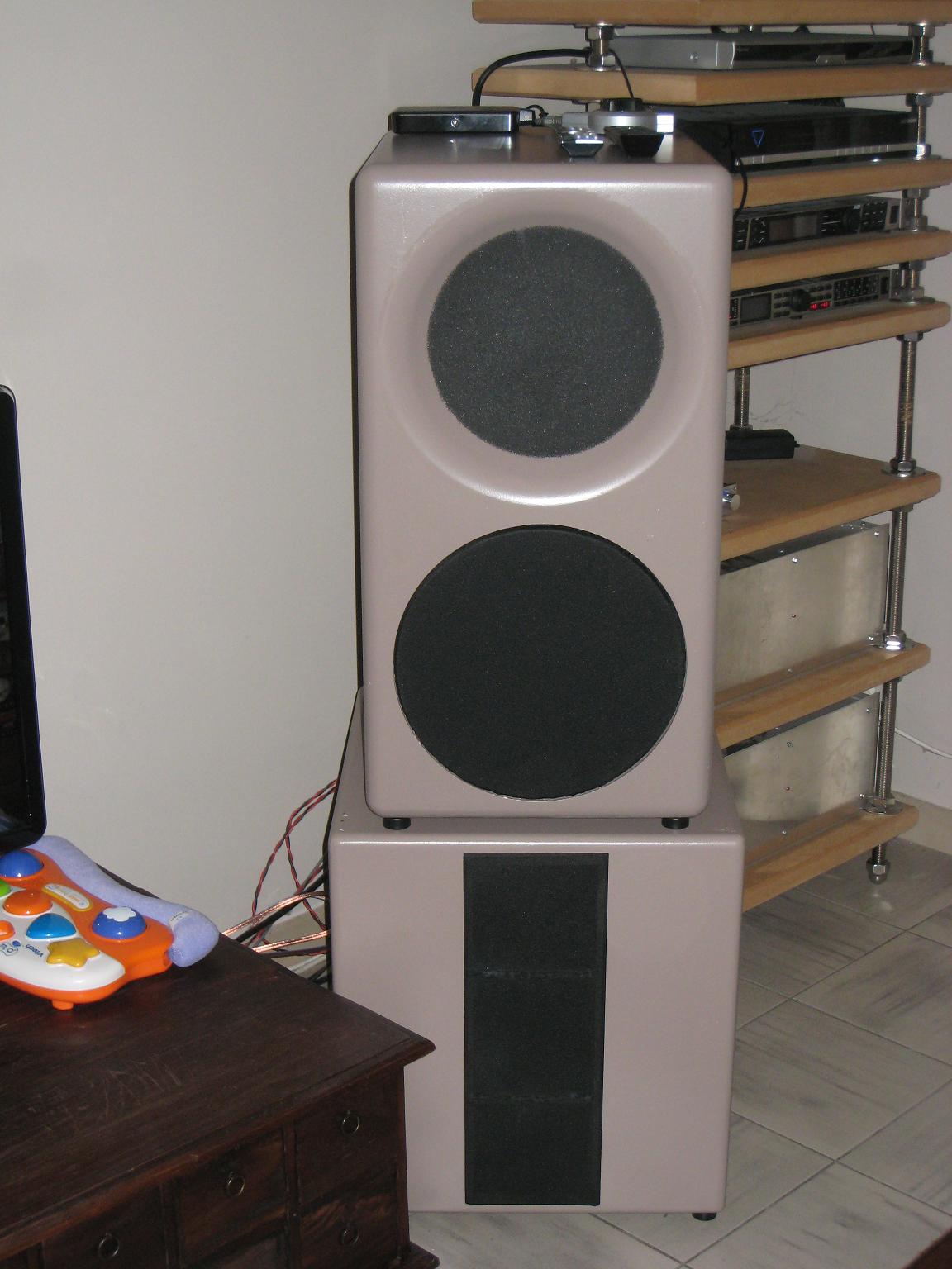

I think it is going to look familiar...

And you are measuring this whole system, or just the top part?
The whole system would not work very well as that is very far from what is assumed.
I also cannot see how you could fit that between your floor and ceiling and get 4.3 ms. of clean response.
No there should not be any "lobes" in that design. If you measure just the top part then we know very well what we should get.
With the bottom part I am not sure.

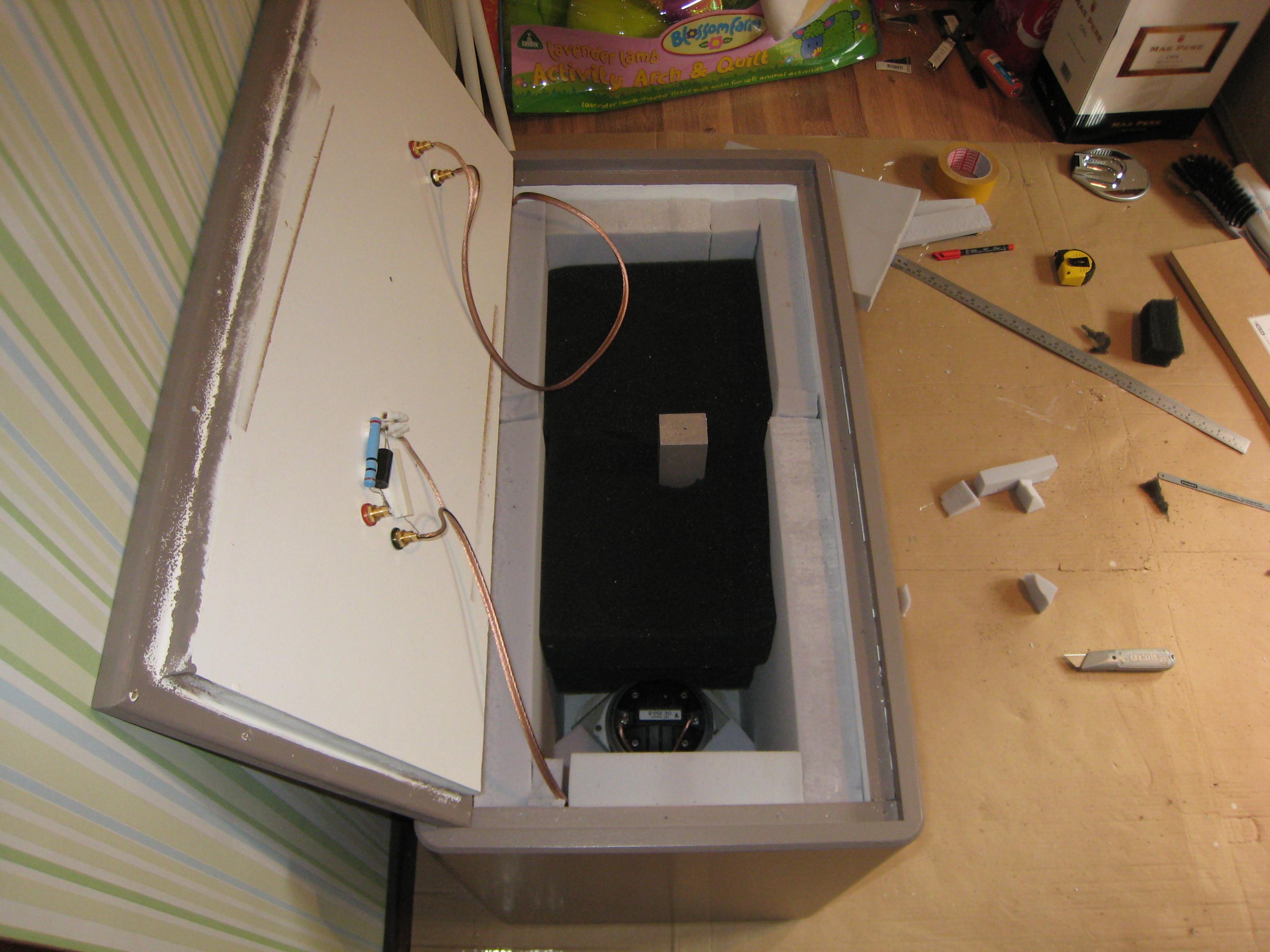

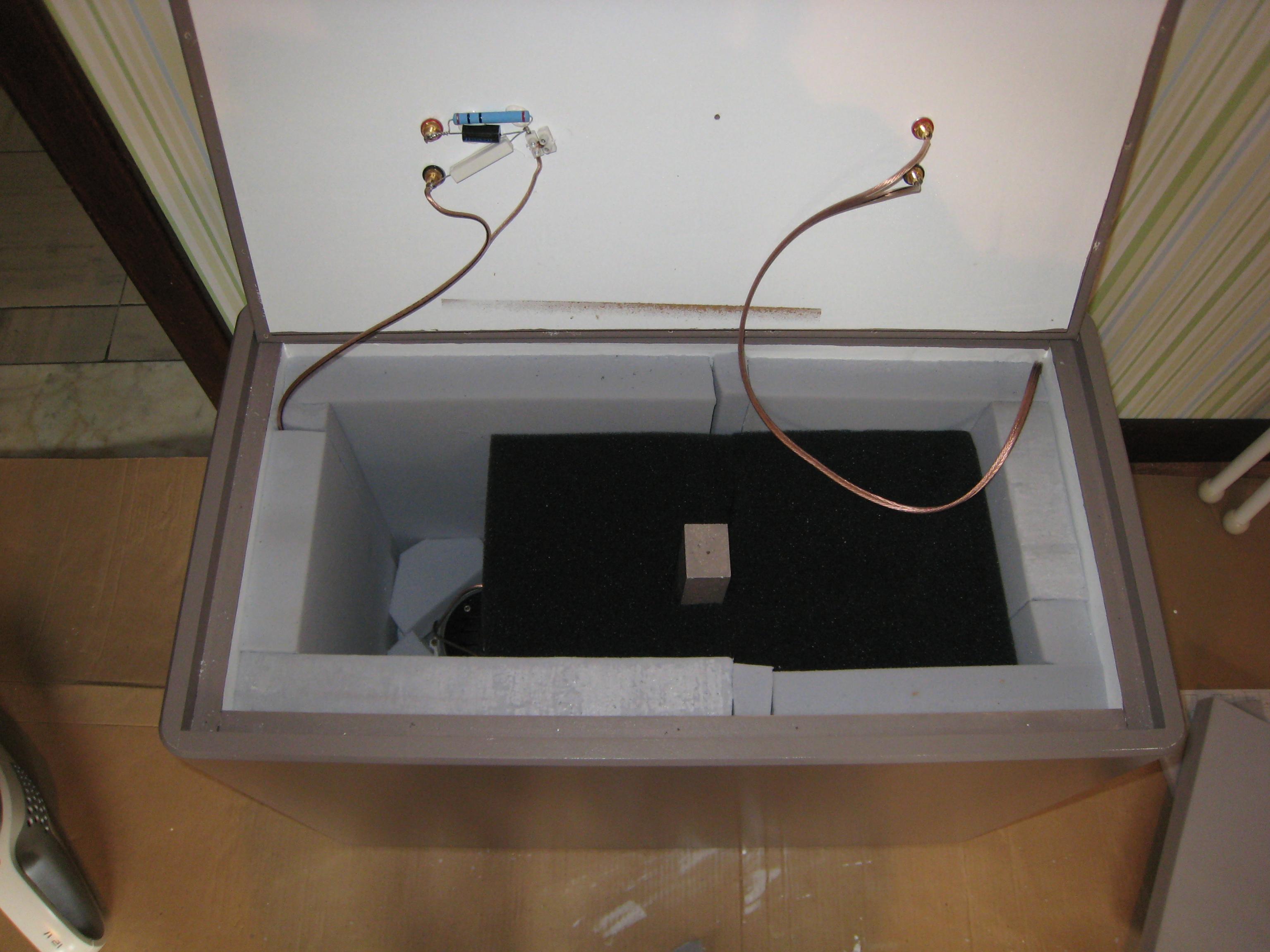

Let me get this straight. The box is 100 liters, and 1/2 meter long, doesn't that imply a face area that is smaller than the driver area. Something is not adding up here. It is a direct radiating driver I hope. Otherwise all bets are off and you should have made that clear in the beginning.
Baffle width: 40 cm
Depth of speaker: 50 cm
Heigth of speaker: 70 cm
=> Volume outside = 140 liter.
Speaker is made from 2 layers of MDF with damping material in between (one reason why I do not like to lift it onto my speaker stand) => approximate internal dimensions 35x45x65 => 102 liter
Speaker is completely closed, see pictures during construction

I am measuring just the top part. The subs are switched off during the measurement
But the subs are present?

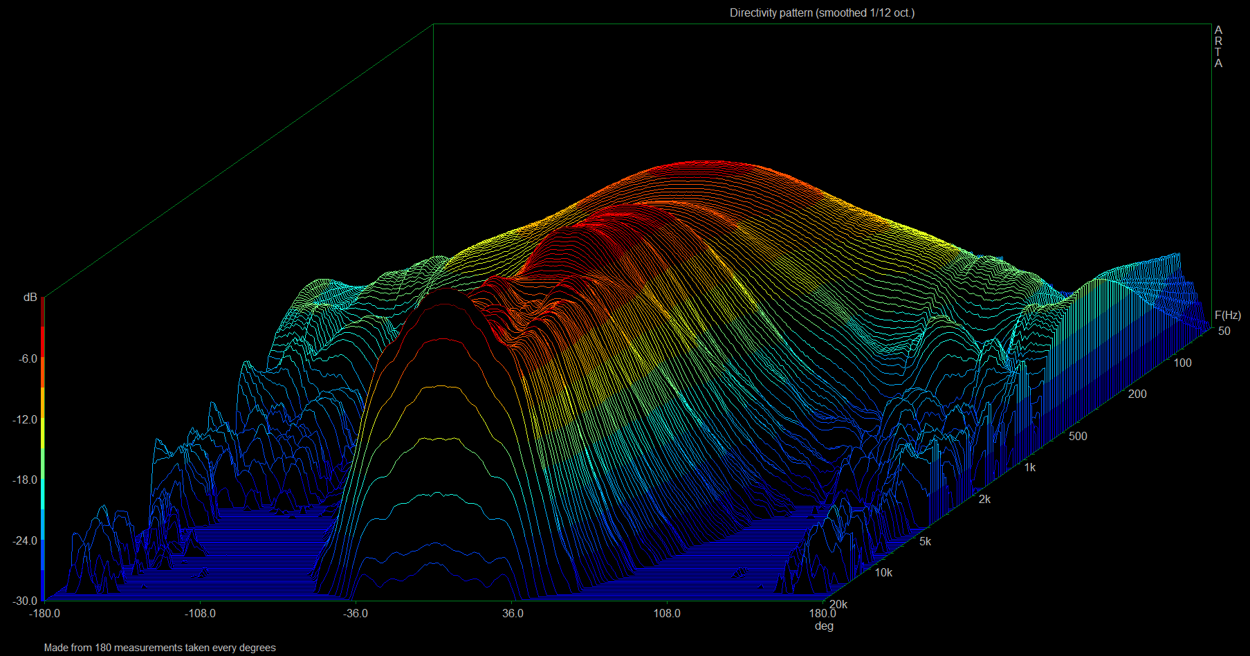

Center of speaker (so exactly in the middle between woofer and waveguide) is at 125 cm to maximise gate length.
Attached is the waterfall polar plot (which does not use any interpolation and with smoothing 1/12 oct) from the 180 measurements I took. You can clearly see in this data (and in the frequency responses I plotted in post http://www.diyaudio.com/forums/multi-way/261616-measurement-technology-7.html#post4055161) that no lobing is present. So somehow the difference must come from the fact your plot was measured with HolmImpulse, or the way the data is processed by your application.

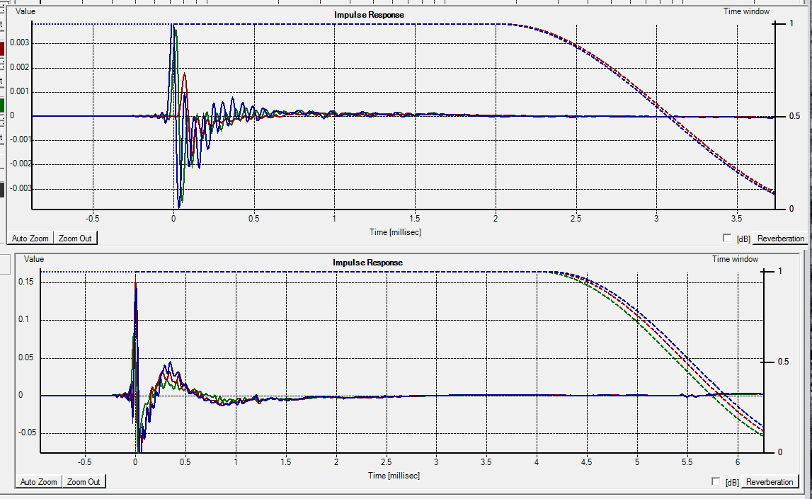

Below is the impulse response from my speaker and yours with, I believe, identical waveguides.
You impulse are pretty noisy, especially above 1 ms compared to mine. These are the same locations etc.
We are just not getting the same results from basically the same thing. The Holm data does not look good in your case, I agree with that. Your Holm responses are 50 dB down. Do you know why that is? That is kind of in the noise floor.
My data is on the bottom
=> Difference in impulse responce: I think this is because the impulse is more compact (compare the time scales) in my case (advantage of digital crossover vs passive crossover...)

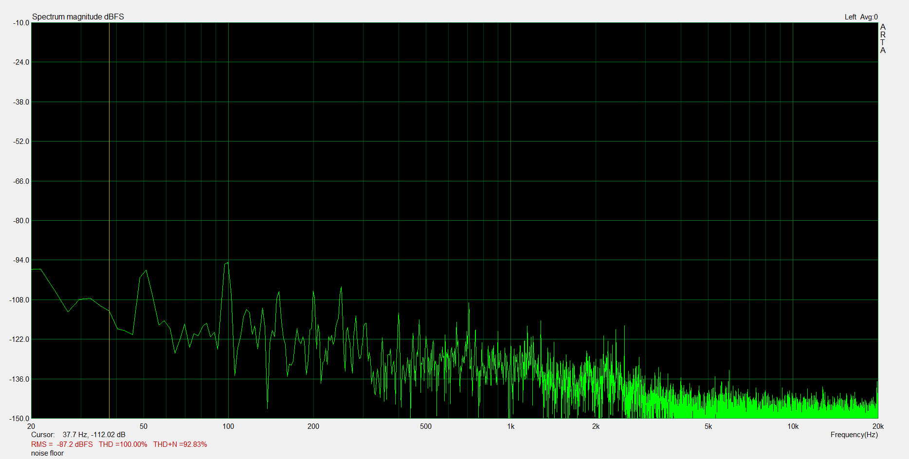

=> 50 dB down is because of mic preamp I use (micro-tech gefell), but noise floor is down to -100 db when it is quit is my living room (see measurement I just took)
You may be below the acoustic noise floor and the electrical noise floor, but what about the numerical noise in the calculations. This could be a problem. Since the data is transferred in a limited number of digits you are throwing away at least the last four, maybe five when compared to exporting a signal closer to 0 dB. I don't know if this is a problem, but my calculations are extensive and round off could be a problem.
I have somewhere a battery powered pre-amp for my measurement mike with higher gain, I will see if I can repeat the holm measurements with this one... (will take minimum a couple of days before I get the chance to do this). If any other test needs to be run, now is the time, because it always nice to be able to combine tests...
