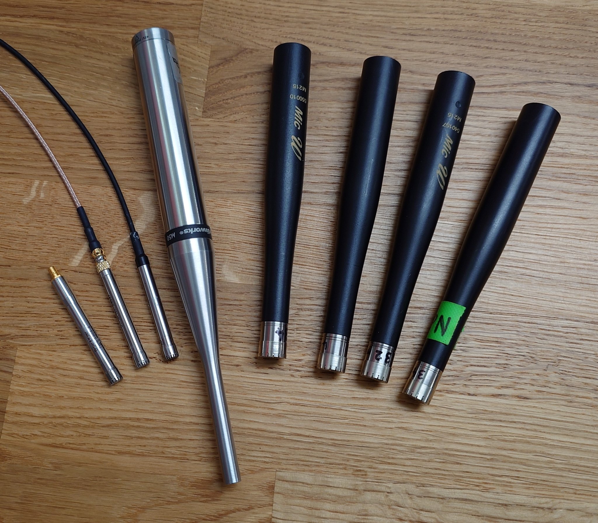

These M215 are proper Class1 capsules with 48V phantom power electronics. They are still 1/2" but behave up to 20kHz and come with individual calibration - it's a bargain for the price.
Earthworks M50 is probably overkill for measurements up to 20k but it behaves perfect in this range, I don't need a calibration file which is convenient. Type in the sensitivity and you are good to go. For normal use a M30 is probably good enough and also behaves up to 20kHz. Not sure if they are really higher quality as an M215 ... noise is higher, for sure quality control is better and the smaller capsule has benefits at very high frequencies. But I would guess the M215 capsule is easy as robust in long term as an Earthworks capsule.

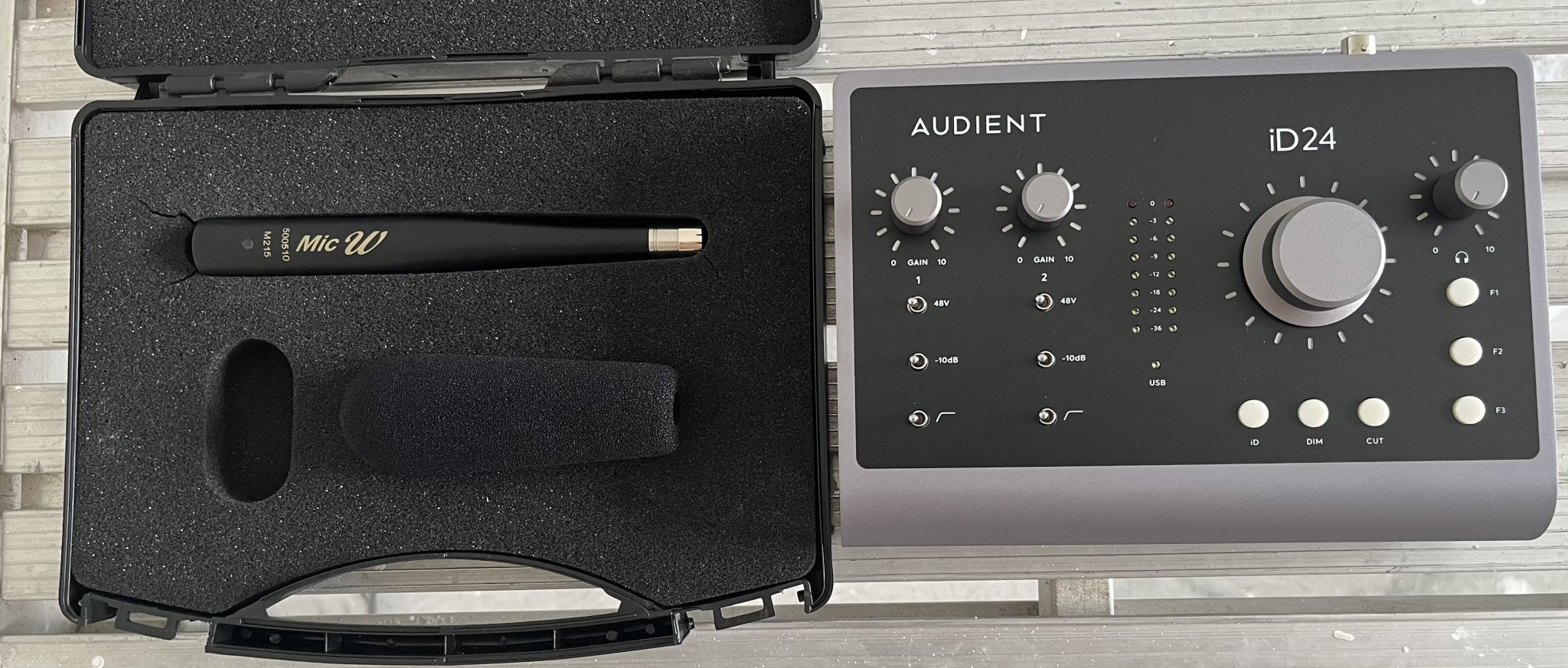

The microphone pre amplifier section of the interface. In a lot of interfaces the signal has to go through the pre amplifier section whether it is mic or line level. Most preamps in interfaces have a gain dependent frequency response or are otherwise the least transparent part of the device.
On the ID24 it has an insert loop that allows the pre amplifier section to be bypassed and go straight into the A/D converter. That also means the source needs gain control.
