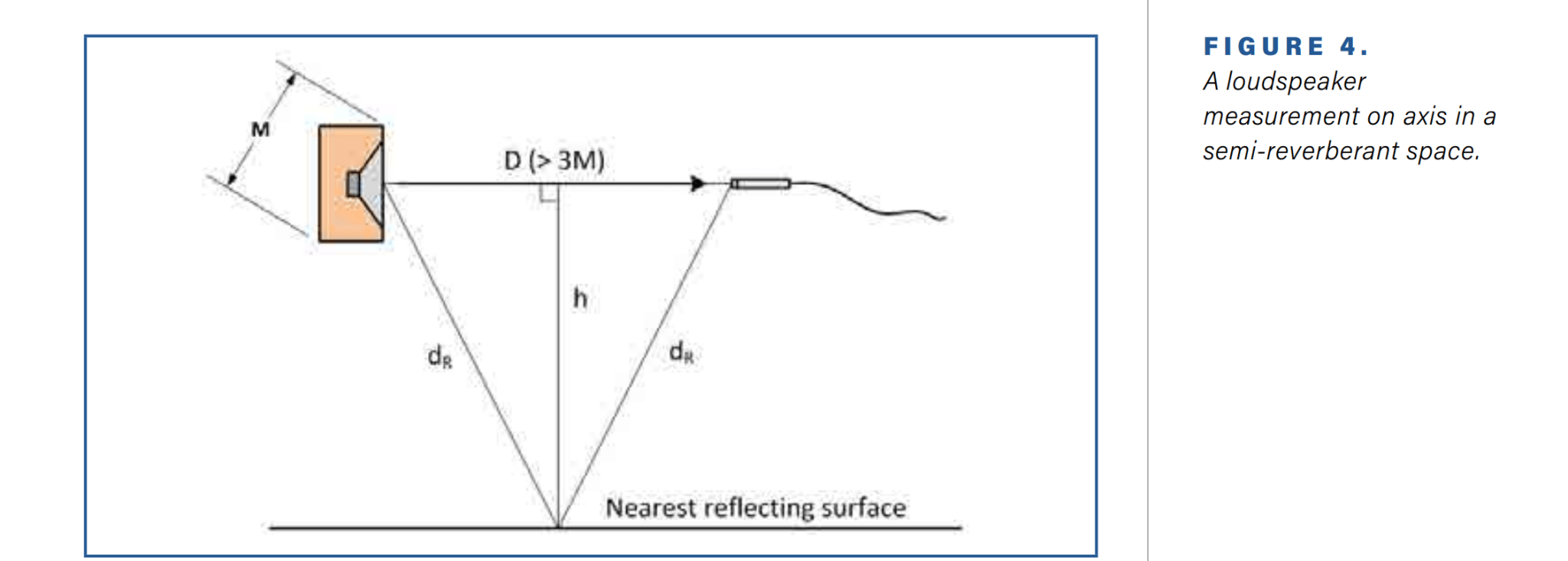

With regards to microphone for crossover design, you don't need anything fancy. People have been doing good designs with the something like the early ECM8000, and able to compensate for any mild deviation in the 2nd top octave by ear. More importantly is that you use dual channel measurements to capture phase information correctly when you take full polar measurements in at least 2 planes ie. horizontally and vertically. It doesn't matter if you have a laboratory grade scientific instrument if you are taking on-axis measurements only; it is far away from describing how a speaker sounds, one could argue that it's close to useless (ie. bad data is worse that no data)
When measuring for in-box frequency response, of course you need to be far away enough to capture the baffle diffraction loss appropriately (ie. twice the distance of the longest cabinet dimension)
eg.
reference:
https://www.ap.com/wp-content/uploads/2021/09/AppNote-Loudspeaker-EA-Measurements.pdf
But when measuring drive distortion there's no need to measure at some arbitrary distance like 1m. You'll can move your mic closer (or further) away to capture the SPL you're interested in, to improve your signal to noise ratio, or avoid overloading your mic/pre-amp signal path respectivly.

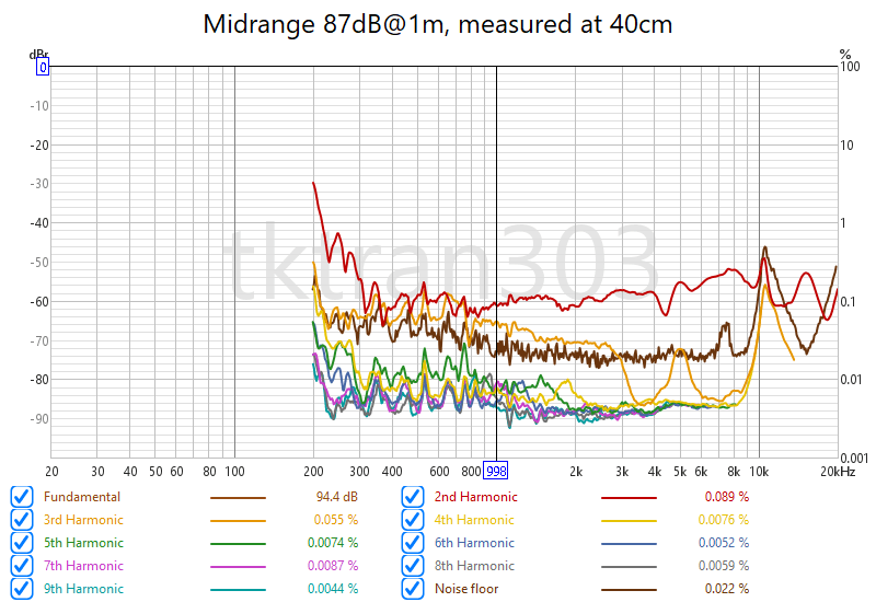

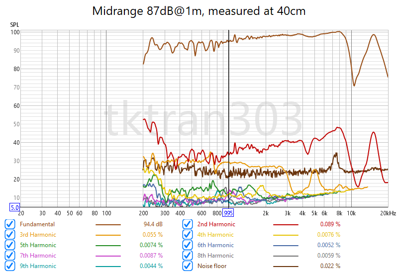

Here's something I measured with a Sonarworks XRef20 microphone, which sells for about $159 AUD (100 USD/EU) into a Focusrite 2i2 Gen 3 audio interface which is around AUD$250.
Measured at 40cm, using a sweep length 1M sample, and 4 repetitions, with improves the signal to noise ratio.

The D2 (in dB) follows the fundamental SPL in detail. So D2 is solely from the overloaded distorting mic, therefore D2 is wrong and useless.
Best regards
Bernd
That’s right. H2 in reality is even lower than -60dB (0.1%) down.
When drivers have such low distortion, it gets harder to characterise them.
What microphone can measure 0.01% (-80dB) THD @ 94dB?
