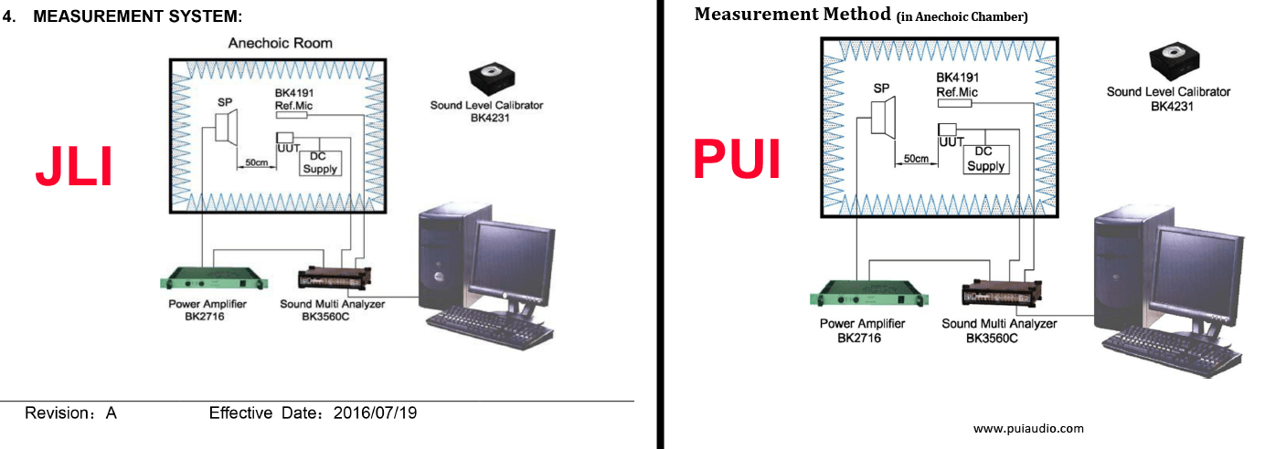

I don't remember where I got it, but it's from the internet. Maybe someone just digitised the curve in the datasheet.Where is your *.CAL file from?
I'd say beware, for that looks like it has been copied and pasted from one of PUI's sheets. The drawings and figures are just the same, except that the Chinese "FREQUNENCY" response is something much flatter, possibly done with the intention of tapping into the market that once belonged to Panasonic.A 6mm electret omni with the consistency of WM61 has yet to emerge but Henry Spragen suggests a JLI replacement is promising
audioimprov.com/AudioImprov/Mics/Entries/2017/12/13_A_Simple_Reference_Mic.html
And what is 'Ordinary temperature / humidity / air pressure anyway ?
Sorry Sir, but that's a lot of red flags .....

I didn't say this was THE ONE. Only that Henry thought it looked promising. For a complete picture, loadsa other gurus need to have compared this with their 'measurement' mikes. WM61A's reputation was built up over years.I'd say beware, for that looks like it has been copied and pasted from one of PUI's sheets. The drawings and figures are just the same, except that the Chinese "FREQUNENCY" response is something much flatter, possibly done with the intention of tapping into the market that once belonged to Panasonic.
We DO know that the present ECM8000 capsule isn't it.
I would like to know what Earthworks use unless they have the World's last remaining stash of WM61As .... Oops! Shouldn't have said that! Us small mike makers need to stick together and keep da Voodoo from da unwashed masses.
