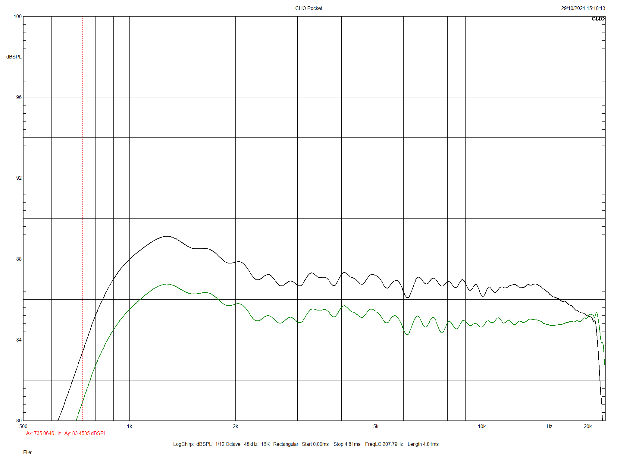

Here are a couple of plots that may be interesting. The source loudspeaker was an SB Acoustics D19ST-C000-4, flush mounted to a large baffle, driven full range. The front tip of the microphones under test were placed at the same location, within about 1mm. No cal files were applied in any of the plots and no eq was appled to the D19.

This plot shows my M23 and a MicW M215. Note that this trace is 2dB/
Reactions: 6 users
That was one of my takeaways from this session. This little tweeter is really good, especially for its $25 price!
That said, I did look at the published curves for all the tweeters I had and selected the flattest one. This test also shows the benefit of a large baffle, in this case 1000mm x 1200mm. Measured indoors. The first reflection was gated out.

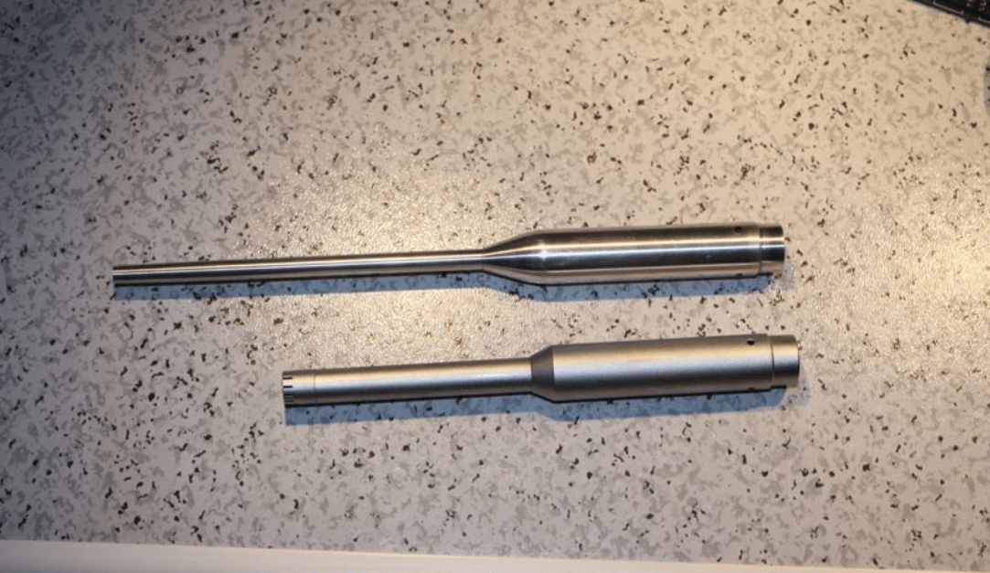

I have used these WM6x mic capsules as well.
I actually milled and turned a whole aluminium microphone for one, many many years ago
(the top one)
The main issue is not if they perform well on paper, or from measurements from a few.
The main issue, is that beforehand you just don't know how they will perform.
The particulars ones someone might have might be all great, or maybe not.
Or in fancy words, we just don't have any clue about the (standard) deviation.
Fact is that after you made a nice mic, you still have to get it calibrated.
Since you have no clue how it performs.
Btw, with my own diy microphone experiment, I actually discovered that the generic (cheap) microphone shape doesn't make much sense.
A part of the 8-20kHz hump is mostly because of the baffelstep of the tube where the capsule is mounted.
One of the reason I made mine as thin as possible and much longer.
I could very clearly measure the difference with the same capsule.
In a good design they compensate for that already.
