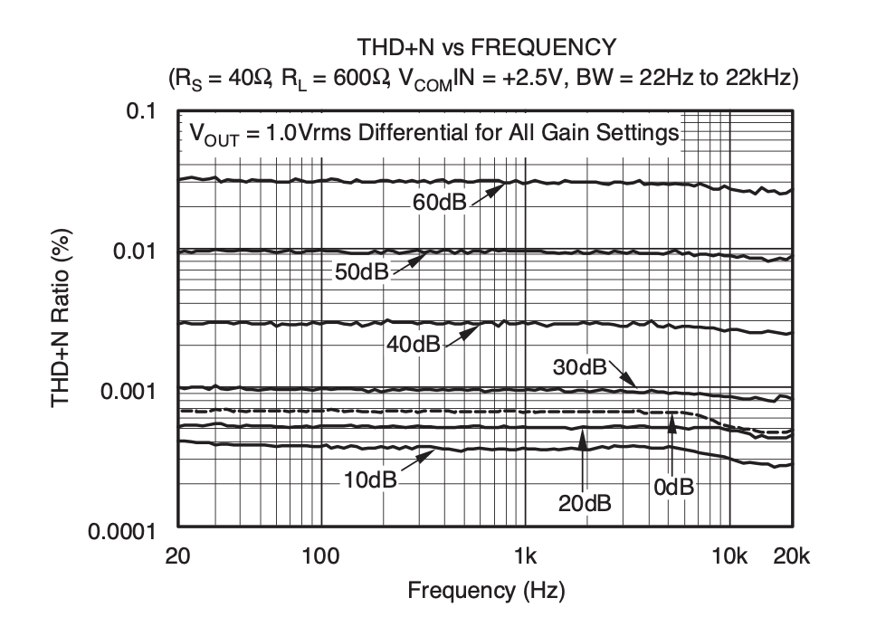

With a dynamic low output mike at -say- 55dB? I always wondered how Joseph Crowe got 0,0056% with a Focusrite Scarlett Solo (while that was with a condenser mike). A typical highish end differential pre for microphones (PGA2500) attached... Of course, if you get the levels up high enough, you don't need 50dB gain.Plenty of audio interfaces capable of doing an order better in performance?

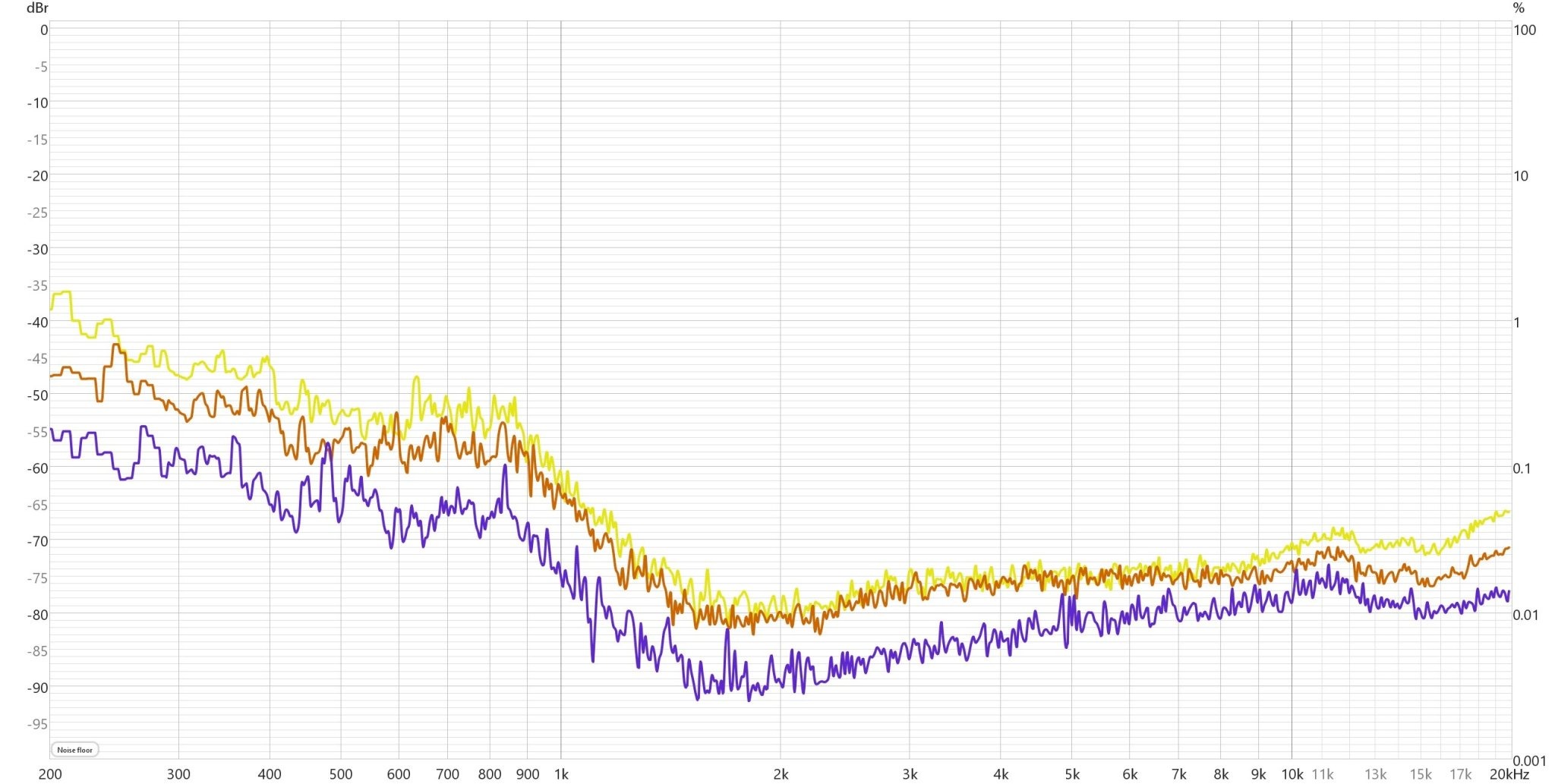

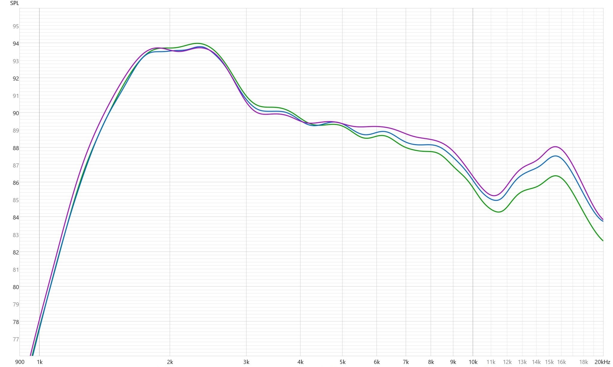

A little study I'm working on and trying to wrap up this week...
First thing I'll mention is...how much do you trust your mic and calibration file?
Audix TM1 is manufactured to be +/- 2db from 20Hz to 20Khz (not used below)
Beyerdynamic MM1 is manufactured to be +/-1.5db from 50Hz to 16Khz (not used below)
Earhworks M23R is manufactured to be +/-0.5db from 9Hz to 23Khz
Here is SPL response using (1) a $35 mic with a $47 preamp; (2) a $70 mic with a $200 preamp, and (3) $600 mic with a $170 preamp. With what should be good calibration files and "psychoacoustic smoothing" which is about 1/6 octave which is the level of "squiggliness" we can hear.
This is a $15 tweeter in a 3D printed waveguide
SPL ~1W/1M...
Here is HD3 (at 96db/1M)...
And the noise floor in my garage...

Just to clarify, this was not to imply these microphones are not good. I would trust the calibration files that these come with unless I saw objective evidence otherwise.
I would not trust the typical calibration file that comes with $100 or less mics. But with a good calibration file a $35 mic can work fine for crossover work. My fist mic was a UMIK-1 from Cross Spectrum Labs.
